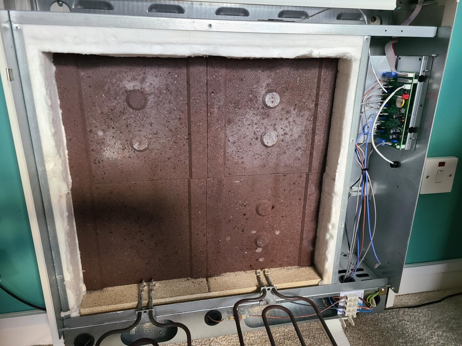

I had 3 storage heaters installed 3 years ago. Two if them retain the heat well, one of them doesn't. The one that doesn't will get just as hot when it's turned on but will loose the heat so much quicker.
I doubt there could be a problem with the elements as the unit isn't old enough. Is it worthwhile/safe for me to take the front of it off to have a look to see if I can see anything obvious?

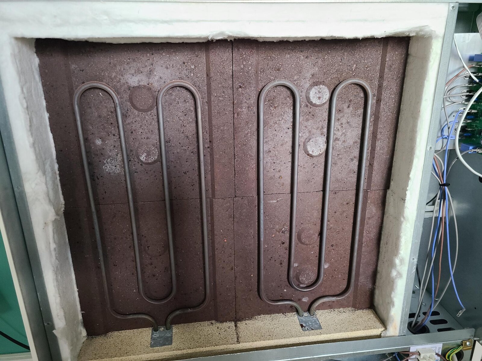

I`m assuminng you have checked that all the elements are working - check for cold spots on the otherwise hot heater, the elements are often 1 or 2 or 3 or 4 in number, depending upon the heater.
Heating elements are usually around 900W each so your model might well have 4 of them.

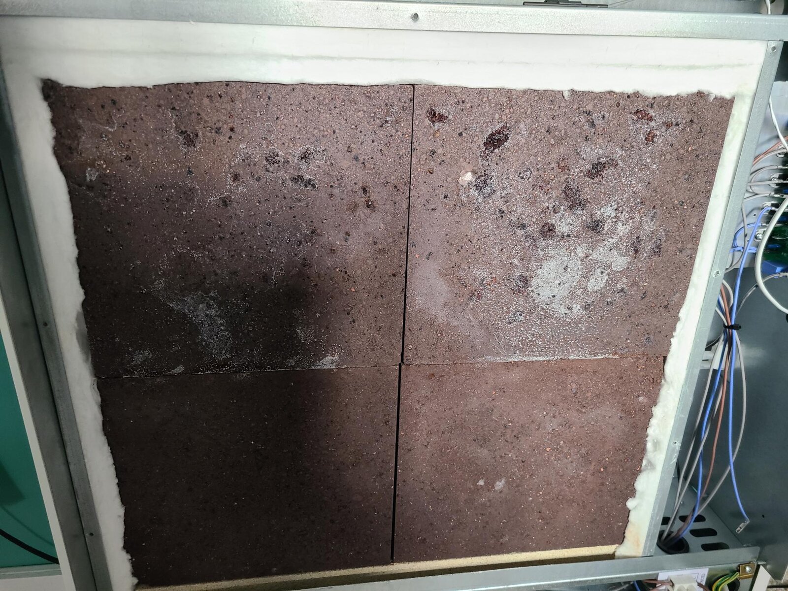

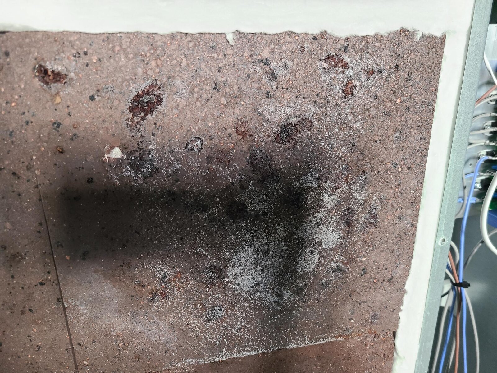

I took it apart today and all looks good. The only thing I noticed is that some of the bricks seem to have some bits of metal coming out of it. When I took them all out, they all seemed hot. I was surprised at how hot they were as when I touched the outside of the storage heater before opening it up, it only felt mildly warm.
All heating elements were hot and no visible damage.

I tested them and they both consume the same amount of power. What I am left with assuming is that there is a problem with the way the bricks were manufactured as suggested by someone else in the thread
That would seem very unlikely to me, I would favour it releasing it's heat much more quickly than the other one. Can you perhaps measure the temperatures of the two, towards the end of the cooling down periods?
