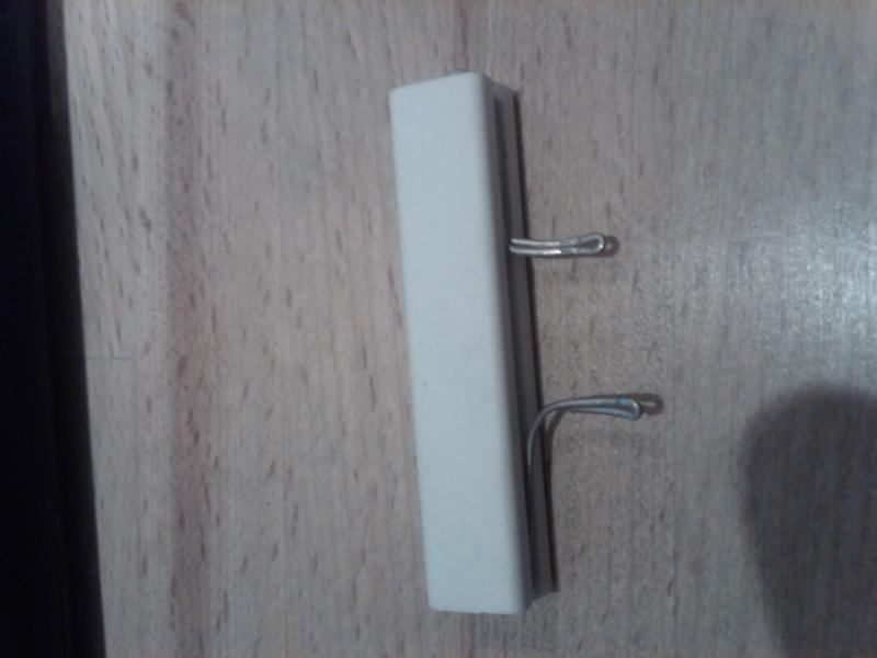

I have taken the back off the heater and there is a connector block direct from the live input that goes through a white ceramic type block (7mm square by 50mm long) - with a wire passing through it i guess. I have metered the wire and it measures 7.5kohms and is not a short as i expected it to be. Is this the fuse?
There is nothing on it by way of markings. I could take another heater apart to compare but its a not easy to get to and i think this is it - there are not reset switches or anything else that i can see by the control area of the heater.
That is not likely to be a fuse - more likely to be a wire wound resistor used as a thermostat accelerator.
On some heaters, the cutout is part of the main thermostat/control knob assembly.
Ultimately, there is not much else in these heaters - try tracing the wires from the input, checking for continuity at each stage. Check for continuity across the thermostat (turned to max) and also across the element(s).
That looks like a wire wound resistor - sometimes used as an anticipator to make the thermostat operate more efficiently. Does it have any markings on the side?
7k5 ohms seems reasonable to me.
Nope no markings, ok will have a look a bit deeper, struggling to get the whole cover off but as you say 7.5k ohms seems like a standard resistance.
That is exactly what it looks like! I pressed the white part and it clicked back into place - continuity restored :D
