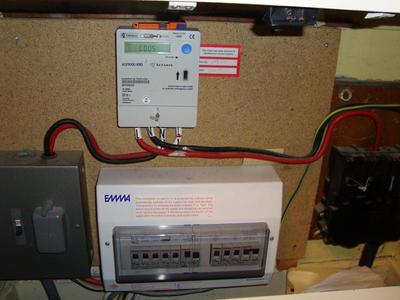

Any chance of a photo of the mains intake and metering equipment? Its hard to tell - theres a few ways of wiring eco7/10.
And if you're on eco7, and have no significant usage during the night, you're throwing money down the drain - they probably charge you more for daytime usage in exchange for cheaper nighttime use.
Photo as requested, not much to it!

It doesnt look like a dual tarrif setup. Does the meter have two KWH readings?
yep, just clicked through the display options and it shows rate 1 & rate 2, Do you think it is worth keeping the tariff for just one storage heater or would a fan or oil heater be better as suggested?

You can run a fused spur, they are rated at 13A max which equates to a maximum of approximately 3 kW.
If you do have a two tariff meter and no off peak consumer unit, everything will switch over to the cheaper rate at night.
You can still take advantage of the cheaper rate (and it is cheaper, usually in the region of one third of the price of the std rate) by connecting the storage heater via a time switch so that it only comes on when the lower rate is in operation.
