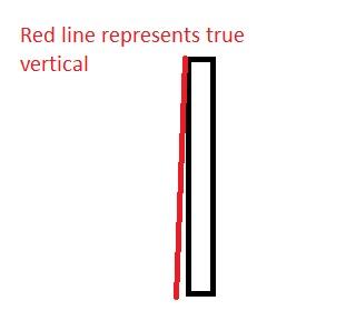

Hello everyone.
I am fitting a new L shaped kitchen shortly and I have noticed that the timber studwall (50x100) tapers - it is out by as much as 20mm. Now I'm not sure what to do. Do I:
1) take off the board on both sides and straighten the studwork (a lot of work as there is 4-5m of wall)
2) reboard over the top of the existing
3) something else???
I am confused as I haven't fitted a lot of plasterboard and never fitted a kitchen.
The wall is generally uneven all across its surface, so I'm anticipating a lot of trouble when I come to fit the work surfaces and units. I really don't know how to prepare the walls and need some advice.
Please help, thanks

I'd leave it alone personally, you can just profile the back of the kitchen units to match the taper on the wall - it's no big deal.
I don't fancy the idea of profile the back of the units to that extent.
There's still the issue of the head high units which won't sit even remotely flush with the wall.
I've come up with a solution that involves fixing one batten at one end and another at the other and then running string line head and bottom and then fixing the middle battens in line with it. I will then board out and have an almost perfectly flat surface to fit the kitchen.
