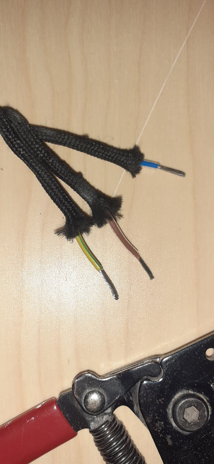

Inspired by a current topic about flex, just recently I have noticed several light fittings be supplied with flex that is very awkward to work with.
You just cannot twist the strands together to solid it up a bit. It just instantly undoes itself, so making a neat connection is virtually impossible.
The best I can do with it is bend it over and shove it in the terminal quick.
Anyone else experienced this rubbish?

this is the stuff in fine, hair-like whiskers?
assuming you haven't got a soldering iron handy, I wonder if a bootlace crimp would help? Some appliances come with them, for testing in the factory.
Not sure what it's construction is, but yes, very fine whiskers.

It was a cable pendant kit from Next.
https://www.next.co.uk/style/st201114/413279#413279
A really horrible thing to wire, but the worst part was neatly cutting the weave.

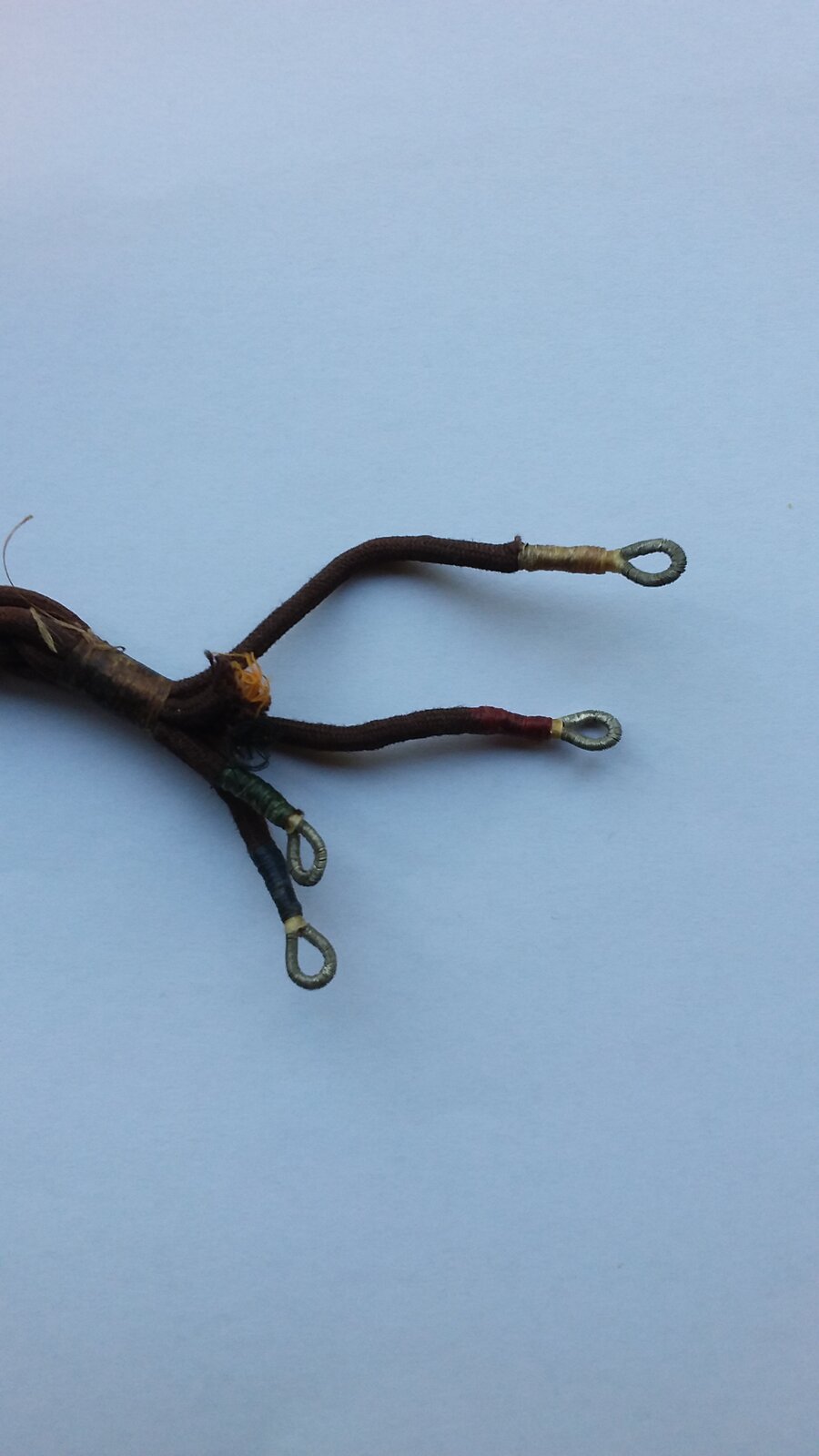

A similar wire was tinsel wire ( mainly in telephone equipment ) which had threads laid in with the copper tinsel strands.
Terminations were made by tightly wrapping tinned copper wire around the tinsel and then bending this back and binding it in place with colour coding silk thread to form an eyelet.
Image from Telephony Part 1 ( Herbert and Proctor, 1946 )

Definitely bootlace ferrule, though might need to be slightly bodged with an over-sized one crimped right down if the wire is so bad it won't go into a correctly sized ferrule. I always try and use ferrules on stranded cable.
Soldering isn't an acceptable method for dealing with the problem. The soft solder creeps readily at room temperature and will remove contact pressure in screwed terminals.
And yes, I remember when I first came across tinsel cord and wondered "what strange stuff is this, and how on earth do I solder it ?" (or words with that general meaning :whistle:)
I have made a few of those up in the distant past. It's the only way to deal with that stuff. I think the last time was back in the 80's for some instrumentation leads on a bit of machinery, where the copper leads kept fracturing due to the extreme movement and vibration. I came up with the bright idea of using curly telephone wire, but found it was tinsel wire and impossible to terminate in the usual way, so I ended up binding the ends with 5amp fuse wire.
From my collection of phones through the ages used as stage props:
