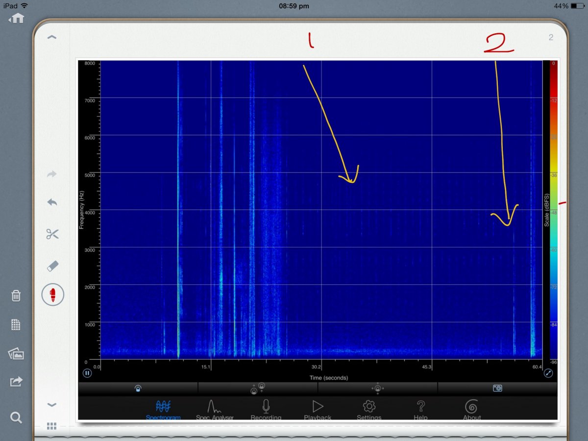

No.1 the small repetitive lines you see, is the clock ticking 5mtrs away.
No.2 is dropping a paper clip on the carpet with the ipad in my hand, sitting on a sofa, in a quite room.
If you have an iPhone I'd suggest getting an app called Spectrumview.
