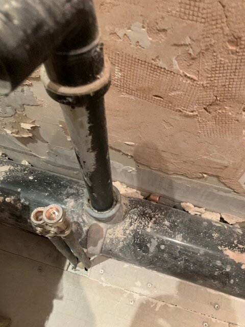

I’m after a bit of advice. I’m just changing the bathrooms in my house (built early 1990s) and I’ve come across strap boss connectors fitted to the soil stack for the first time. Each of the bathroom components has connections to 110mm soil pipe via a strap boss connector.
Now – one boss, for the sink, is very easily accessed (pictured), the other -for the bath - is accessed at full-arm length through the floor (not pictured - its the same except the pipe has a larger OD).

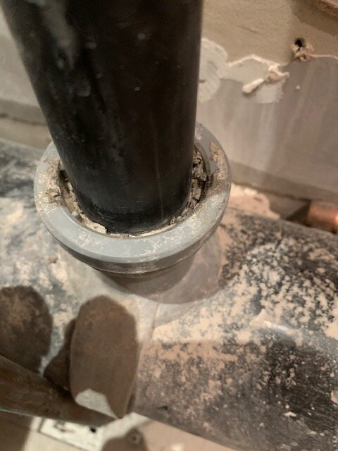

In each case, the current waste pipe (weird sizes: 35mm OD on the sink and 42mm OD on the bath) is still fitted in the boss. But in both cases they’re very wobbly, they rotate and appear to be simple push-fit insertions – which is confusing as most of the ones I’ve seen online are solvent weld. I've not disturbed them any more than that for now.

Your pic on the far right shows a push fit elbow , so the pipe into it is not a solvent weld size . Your measurements are confusing as the above quoted pipe can't be 35 mm ?????
Your close-up of the boss tends to suggest the pipe diameter is too small since there is normally very little clearance between the collar and the inserted pipe. There should be a specified diameter shown on the boss collar.

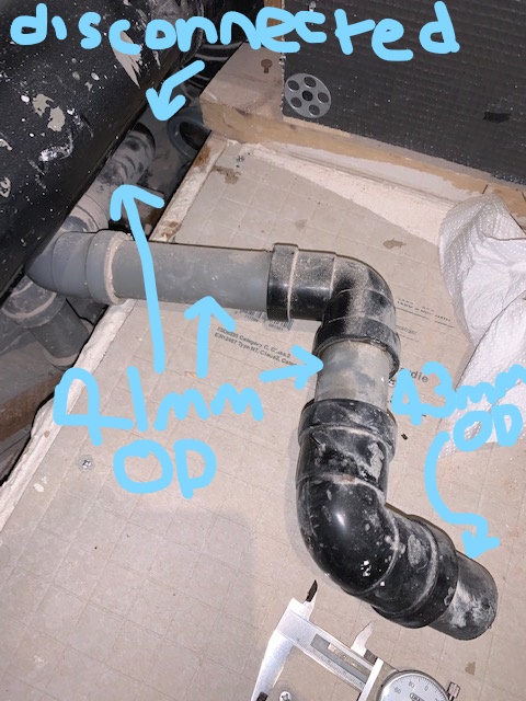

So - I've caused confusion with the waste pipe size. I've been back and checked the OD of the existing waste pipes (one from the bath, not pictured and the one from the sink, pictured above).
The sink does have an outside diameter of 35mm, which (according to this site) makes it "32mm or 1¼" Domestic Waste pipe Push Fit (rubber ring seal)".
The bath is the weird one. There's a few lengths of pipe connected by push fit elbows. The bit of pipe I measured had an OD of 43mm (not 42mm) as previously advised. There's two elbows before reaching another bit of pipe that engages with the boss. That piece is 41mm OD.
So the bath looks like a bit of a cowboy job: they've connected a piece of solvent-weld pipe from the bath trap to a push fit connection (yes, it did leak) before continuing back to the soil pipe boss with the correct sized stub of 41mm OD pipe. This ties in with everything else I've found in that bathroom as being done to a poor standard.

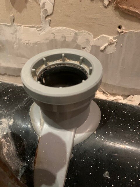

Now that I've plucked up the courage to remove the waste pipes from the bosses I can confirm that the strap bosses are both pushfit connections (I didn't expect that). The bosses are single-piece (no separate collar or rubber adaptor) and are of a push-fit design (you can see the rubber lip inside).
The bosses appear to be the same range from a common manufacturer. The sink boss is clearly labelled "1 1/4" / 32mm" the larger boss for the bath has no markings on it at all - however there are other pipes and bosses that date from the house build that are clearly labelled "1 1/2" 40mm" and have a measured OD of 41mm.

The sink is easy - its a female push-fit boss, so that means I have to use 35mm OD waste pipe (labelled as "32mm" but I'll measure this in the shop). There's only one elbow needed, and its easily accessible so I'll just use a push-fit elbow.
The bath is fractionally more difficult - I'll use 41mm OD push-fit pipe to engage with the boss. From there I will need to have a 90-degree elbow and a 135-degree elbow. That's four joints that could leak in inaccessible places.

I would use solvent weld pipe and fittings on all the baths inaccessible
Waste run,upto the boss , to here I would add a compression coupler /to a short piece of push fit pipe to go into the boss.
We tend to refer to waste pipes according to internal diameter, so 32mm (1.25 ") for Basins, Bidets, Single bowl Urinals etc, 40mm (1.5") for Bath, Sink, Washing machines etc, and 50mm (2") for longer runs or where several appliances are using the one run. The External diameter varies somewhat depending on type of pipe, Polypropylene for Push Fit/Compression waste is thicker wall than solvent weld, and different manufacturers products may not be compatible, even if the same size. Solvent Weld however, is standard across all manufacturers, along with the 110mm soil and underground drain.
I'd be very wary now you've removed the old pipework from the bosses, the rubber seals tend to harden and 'set' in position to suit the original pipework, disturbing rubber seals in this situation invariably leads to them leaking when the attempts are made to remake the joint. However, as replacing the bosses isn't going to be an easy task, you may have to look at making them seal!
Firstly, as some of the joints are going to be inaccessible, I'd rule out any possibility of those leaking and use Solvent Weld pipework. Done properly it is almost guaranteed never to leak provided it is not subjected to external stresses or sunlight. This just leaves the boss connections, I think you have little choice but to insert the new pipework into the existing bosses, and add an appropriate sealant, e.g. silicone, to try and ensure the joints cannot leak. Are these joints going to be able to be got at once the bathroom is fitted, before anything is boxed in/floored/tiled over?

more: disturbing the rubber, I thought long and hard about this - what I found was that whoever replaced the bathroom previously had already replaced the pipe all the way to the boss and it was very floppy in the seal: relying largely on gravity to keep it dry. For that reason I felt it was OK to remove it.
So, for the entry into the boss I’ll make sure everything is as clean as possible and will use a new piece of push fit pipe. I’ll keep the first 5mm or so clean and will then run a good bead of an appropriate silicone (I tend to use Plumber's Gold) that will seat against the old rubber seal - then will run a finger around the silicone to bed it properly. That should give protection in case the rubber starts to fail (its going into a vertical soil pipe so as long as the pipe doesn't move then gravity should mean the seal stays dry anyway).

Can you identify the brand of bosses?
You may be able to get new rubber seals for them.
Also, there is a brand of ring seal that can be converted to solvent weld by removing the rubber seal and the plastic retaining cap that holds it - have you got that product? From memory I think it's osma but MBM!
Avoid the flexi wastes, no Plumber worth their salt would ever use one. Shallow trap wont comply with Building Regs, when connecting to a stack, Regs require a minimum seal depth of 50mm, you run the risk of the shallow trap being compromised very easily and then unwanted odours in the bathroom.
I would really consider using solvent weld throughout, especially given you are effectively making your own seal on the boss adaptors, (if you cannot get replacement rubber seals). Using a short piece of push fit seems counter productive to me as you are then introducing another joint into the equation, which is another potential leak point.
If you really must go with this method, there are solvent weld expansion joints available, basically a solvent socket on one end, and a compression socket on the other. Will cut it down to one extra joint. (Solvent Weld if done correctly will never leak, unless damaged.)
