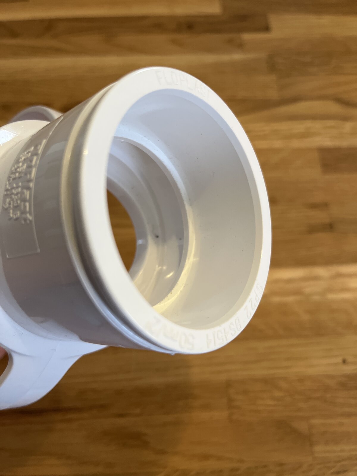

Does anyone know why the strap on boss adaptors fit all the way in leaving a ‘trough’ which will surely collect all sorts of gunk?
See pic
Normally the first part is for the rubber bush that fits upto the first ring then you shove the pipe through up to the second ring.
Is that a 50mm solvent weld boss adapter that you are gluing in? I.E you will then be solvent welding a pipe in there?
