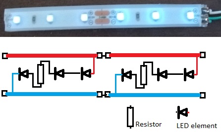

Running 12 Volt simple White LED strips like this
on a 10 Volt DC supply will greatly extend the life of the LED elements and still provide ample light.
Some of these strips when fed the rated voltage are running at maximum current through the elements and over time the elements degrade givng les light than when new,
Is that as simple as a 10v power supply instead of a 12v or does it need some black magic with resistors?
I ended up using some LED Neon last year to re-do a Christmas rope light silhouette that use a filement rope light that was more out than working. Used 12V LED neon and drove it via LM2596 modules which I ended up setting at about 9v if I recall as it was plenty bright enough and the current draw was sensible, I can remember thinking at the time that the LEDS must be driven very hard if the strip was supplied with 12V
I have a 8 pointed cross for my outside Christmas tree made with clear plastic 20mm tube and plastic besa boxes. Initially I used standard push-in fairy light bulbs soldered into suitable strips, then some other wire ended bulbs but both were proving unreliable in the wind. Next I got some LED lights after Christmas in the sale and cut up/rebuilt which lasted the best but by the end of 2019 there were failures. leading to lat year i used HD white tape, doubled over to make it double sided. By far the best look so far. Initially i used a 12V transformer and 4x 1N4004 bridge rectifier which measured about 11.5Vdc and 3.8Aac. Using a 9V transformer gives me about 8.8Vdc and under 2Aac with no blatant loss of light output. Having not done an a-b comparison I can't give a critical description but it is still very bright in the night sky.
