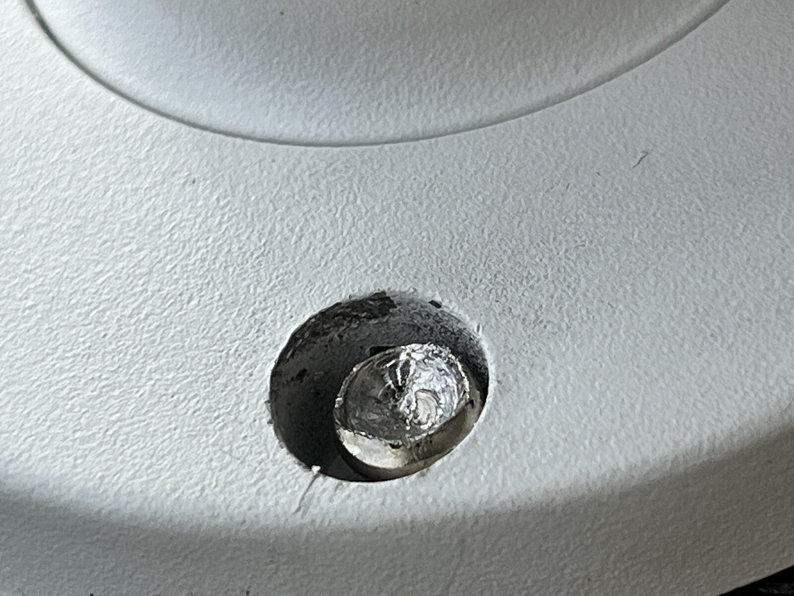

Hi everyone
I had a stripped screw head, so I used one of those extractors... and the extractor tool seems to have simply made the stripped head even worse!
Can anyone suggest a straightforward method of getting this screw out? It's very tight, unfortunately.
Thank you

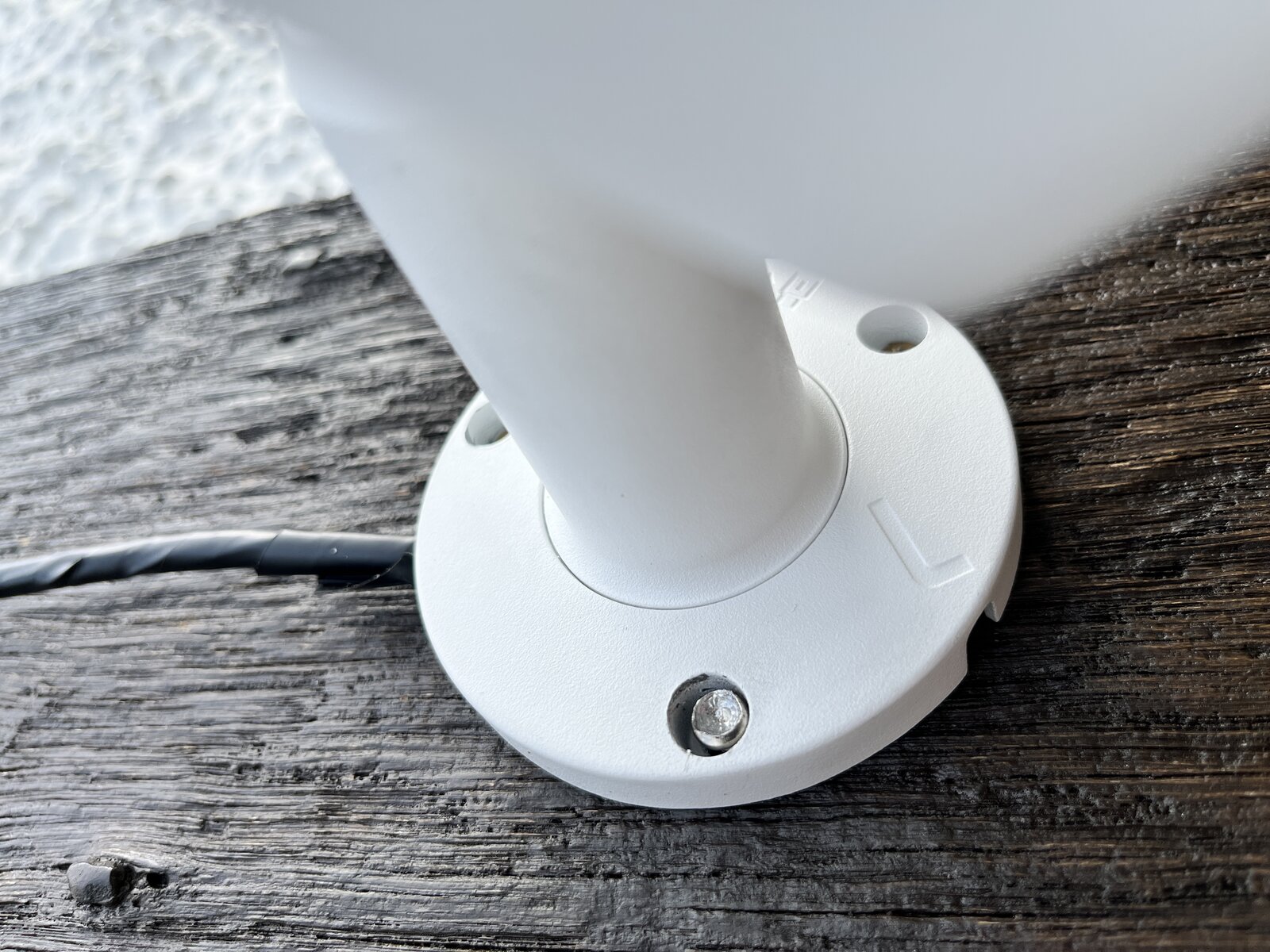

It's in wood, so remove the other 2 and gently lever it out, the light fitting might get scratched if you're not careful.
Once it's out enough to grip the head, use vice grips to slowly unscrew it.
Or, as above, but once you have a gap, use a multitool to cut the screw.
Looks like the head is off the screw so you can remove the fitting. There should be enough screw sticking out when the fitting is removed to get a pair of mole grips on it and gently wind it out.
Hi, thanks for the reply - sadly the head isn't off - it's just nicely ground :)
Will probably have to try taking the other two screws out and then pulling the unit away as Johnny suggested.
Drill the head off the screw then. You're part of the way there already.
