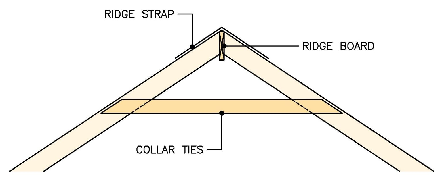

His recommendation is "rafters are connected by collars as near to the rafter feet as possible...using timber or wire rope".
To me, the collar ties are what you refer to as cross bracing, to tie the bottom ends of the rafters together forming a triangle? Something like the image below:
Cross bracing or diagonal cross bracing would run across a run of trusses to brace them all together. The only equivalent in a traditional rafter roof would be a binder at 90° to ceiling joists.
There is no cross-bracing to stop the roof from spreading, (collars) so where's the ceiling?

@datarebal Hard to tell from what I can see but think the ceiling is attached to joists that are sitting in the wall but NOT directly connected to the roof structure. Also not clear if there is anything that ties ceiling, roof and walls together.
I'm hoping its something we can address from underneath/inside the roof, as the slate covering itself has not long been replaced (in fact, our surveyor question if this has contributed to the wall spread.)
maybe some pole plate type timbers laid in the corners to tie the ceiling joists and rafters together? so get your triangle that way?
