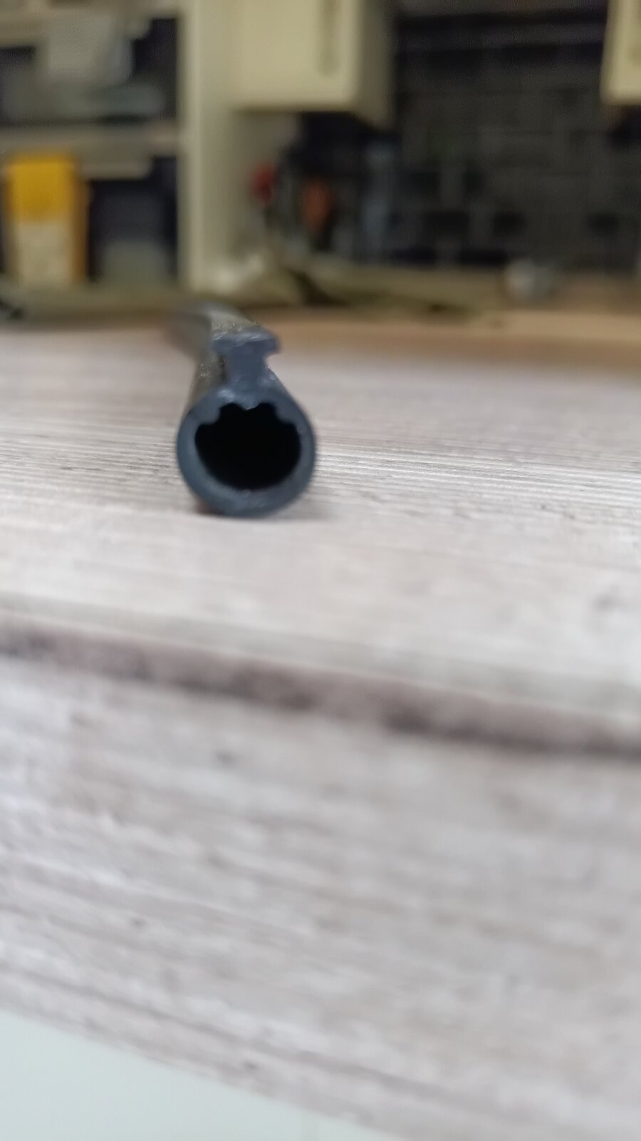

Hi there guy's.
I have been struggling to find a certain size gasket bubble seal type for our garden door. The seal it self is only placed on the underside of the door as added draught, weather and sound exclusion. The Flat edge is 4mm the bubble itself is 10mm. I will attach some pics in a bit. Any help would be much appreciated.

This is the one...

Notoriously difficult to find because its manufacturer specific, I'll take a wild guess and say this is a composite door maybe? It'll have an aluminium carrier screwed to the underside that this gasket slides into, usually they rub too much on the threshold and pull out or tear
If I'm right in that its a composite door then its probably a 'Door Stop' door

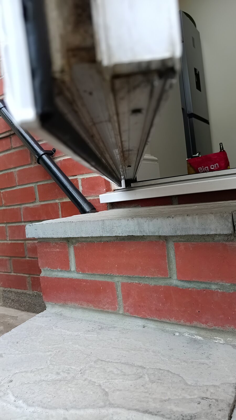

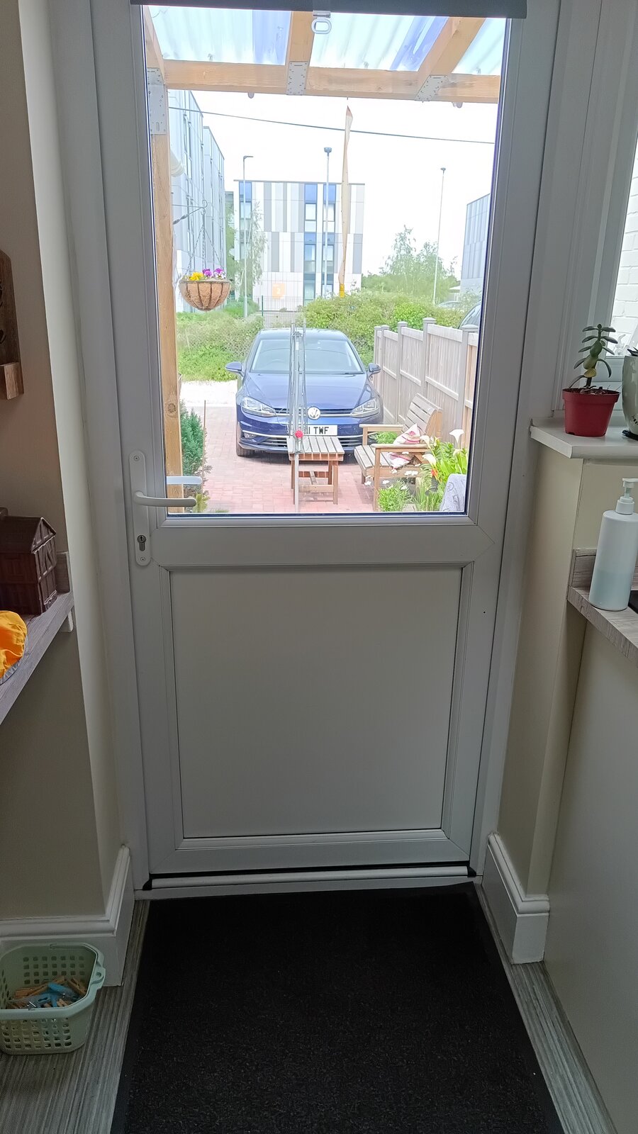

Not composite, I don't think!? Definitely an aluminium rail.

Ok that's a pvc door and Duraflex profile, Duraflex is no longer in business. If it doesn't need to be a bubble gasket you could try a flipper type gasket from Exitex which you could trim down with scissors if needed, the 4mm flat is the crucial dimension though as anything wider then you'd struggle to slide in
