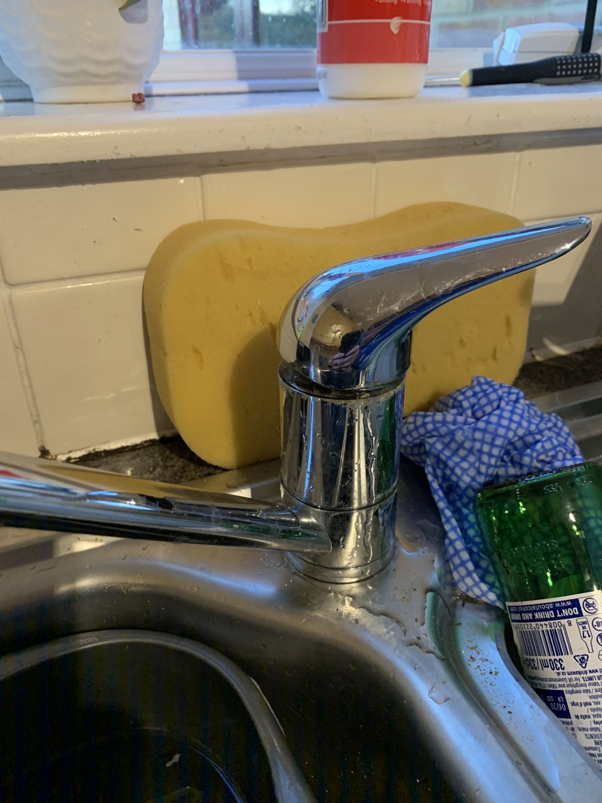

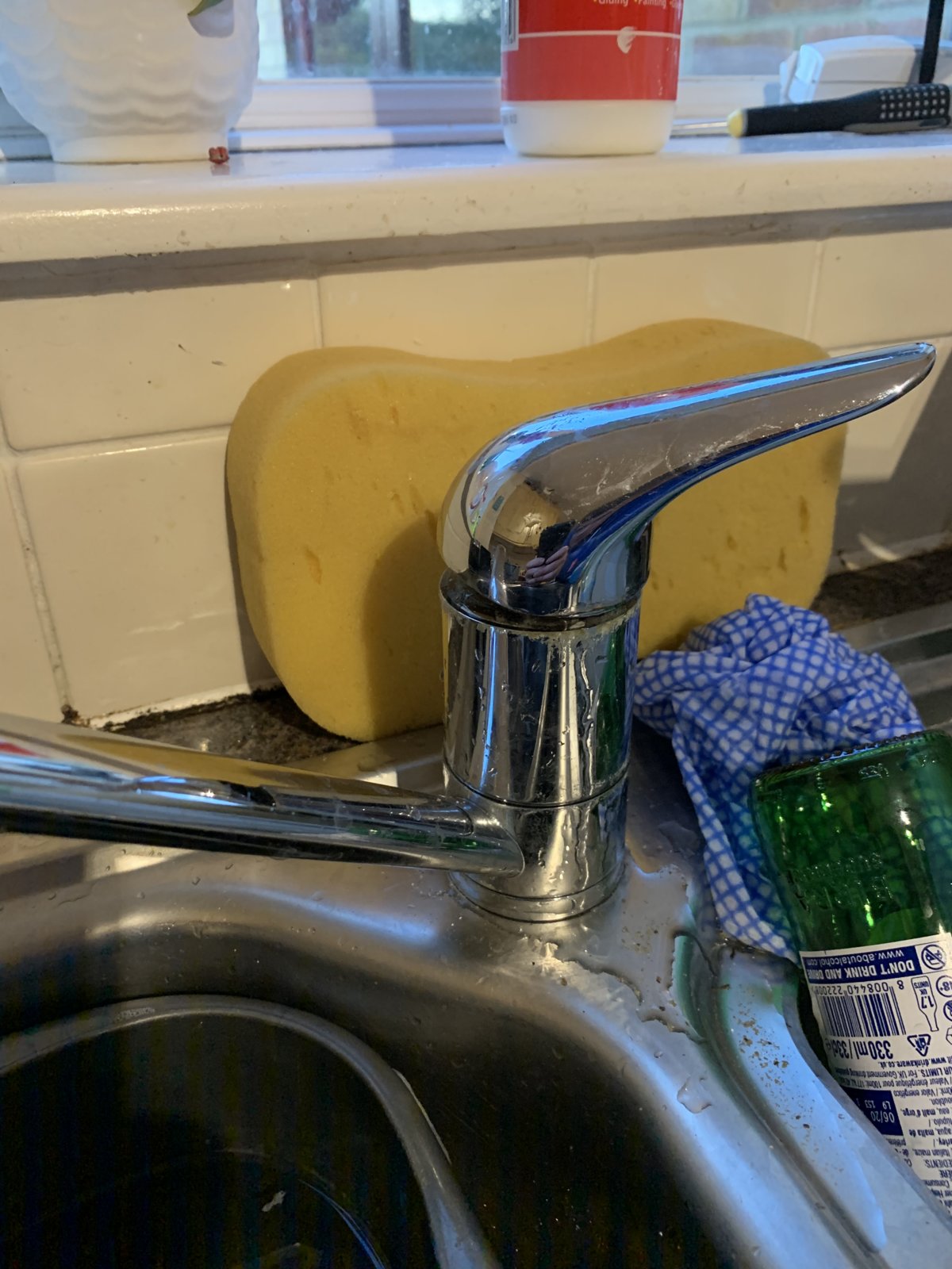

Hi
please see photo attached, it’s a kitchen tap which is leaking when the lever is lifted so I was going to change the cartridge inside but I can’t get the thing off.
I’ve removed the Allen screw which is behind the plastic bung and I thought the top would just lift off but it’s not budging, is there a knack or just brute force?
thanks

That’s what I thoughts, I’ve pulled it quite hard and rocked but it’s not budging. I’ll give it another go thanks for confirming
They can get gunged up . You could try pouring very hot water over the handle ,the heat may help expand it.

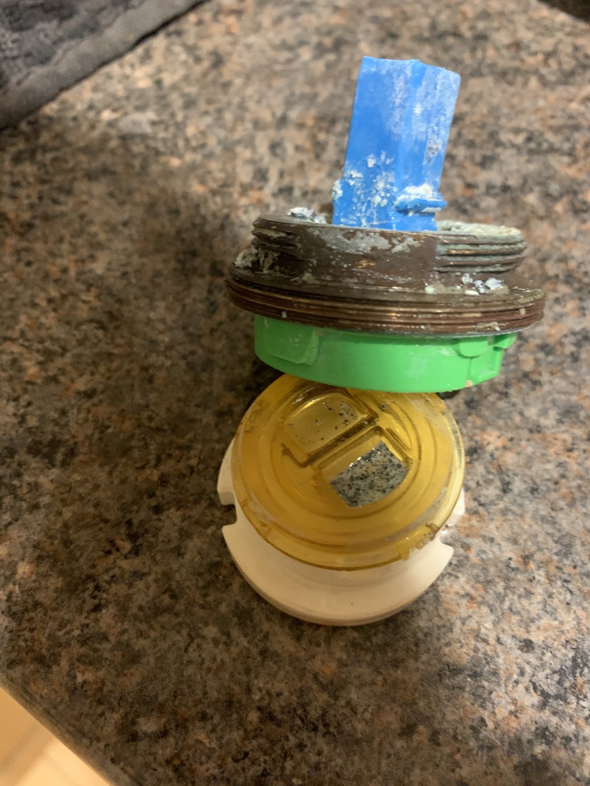

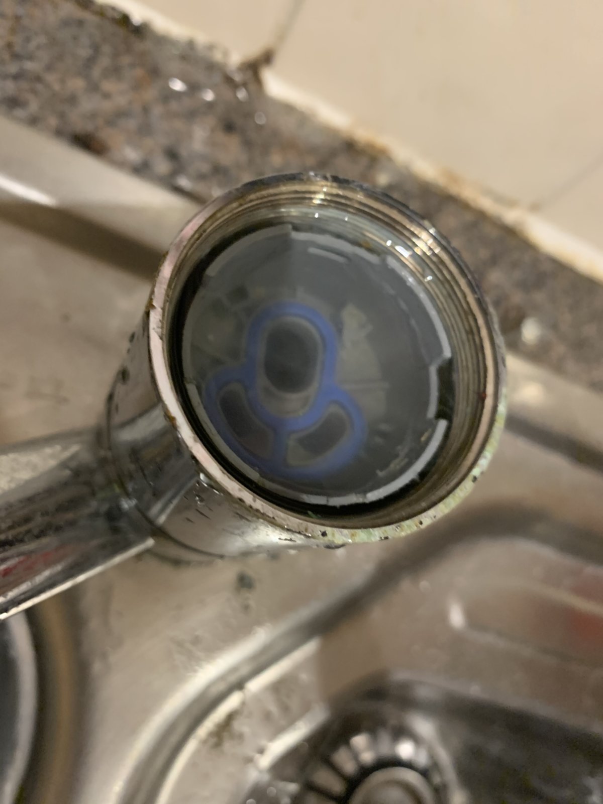

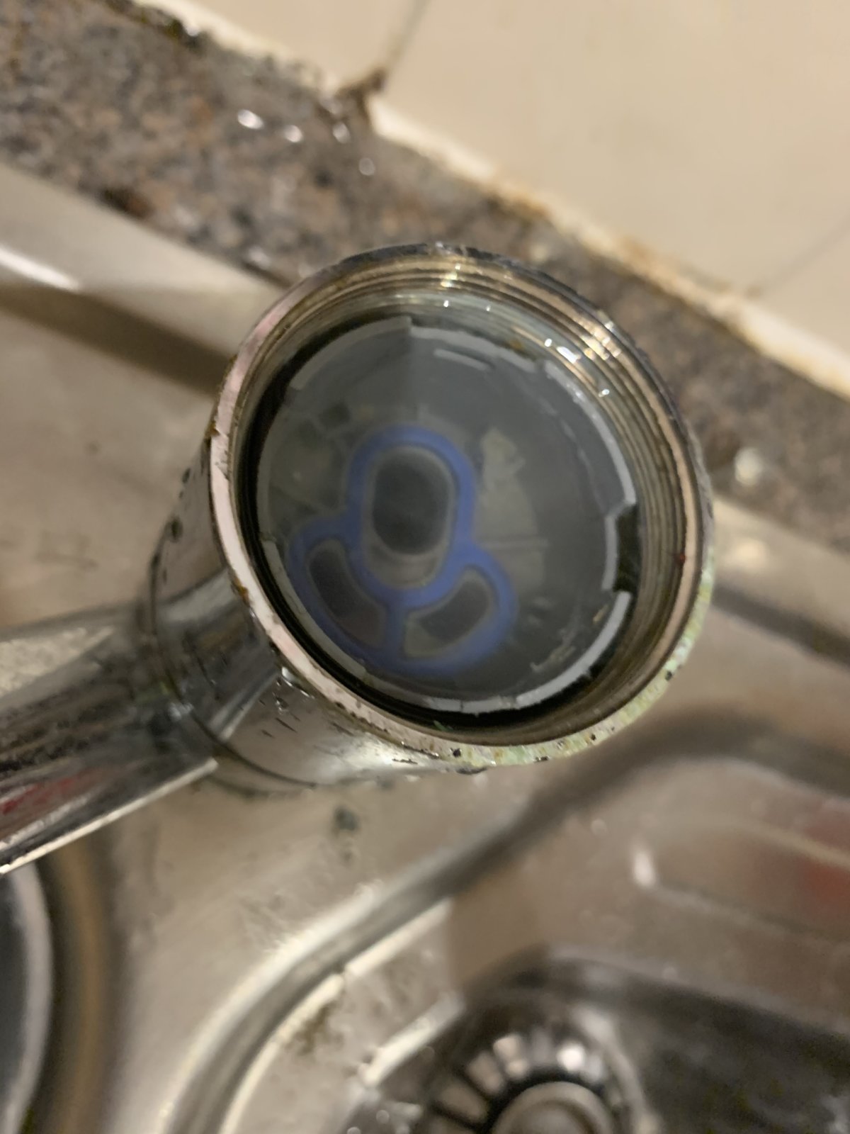

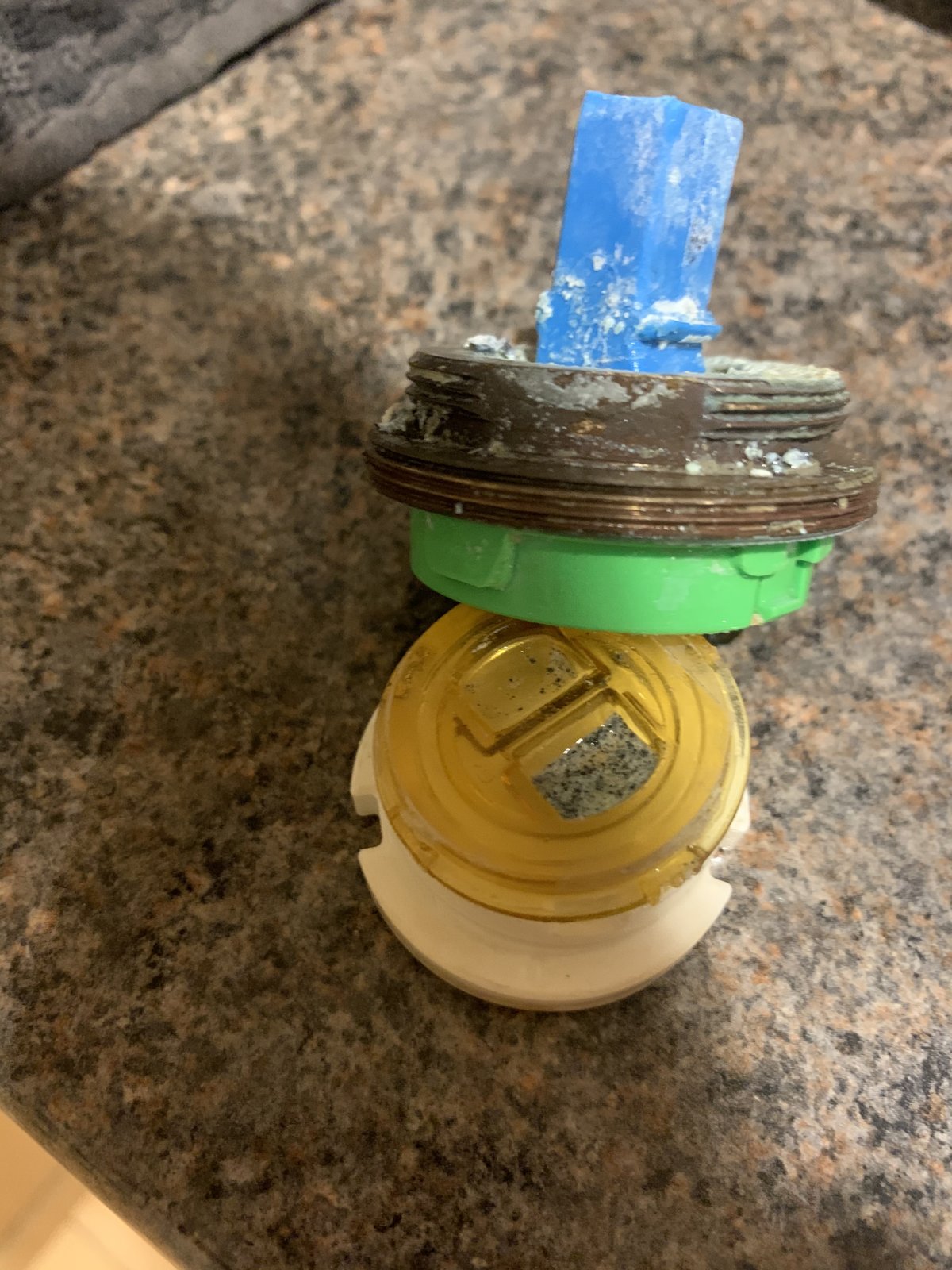

Sorry for the delay, I’ve finally got round to taking the tap apart, it looks like a cartridge which when I unscrewed it became separated (see photos)
The bit left in the tap I presume is the base of the cartridge but I’m not 100% sure this should come out.
Could anyone link me to a replacement cartridge I could get from screwfix please?
thanks

You need to measure the one you removed and get same size.
My local Selco has a selection of them.
Ok thanks,
should it have come out in pieces or with the grey base as in one unit?
thanks
