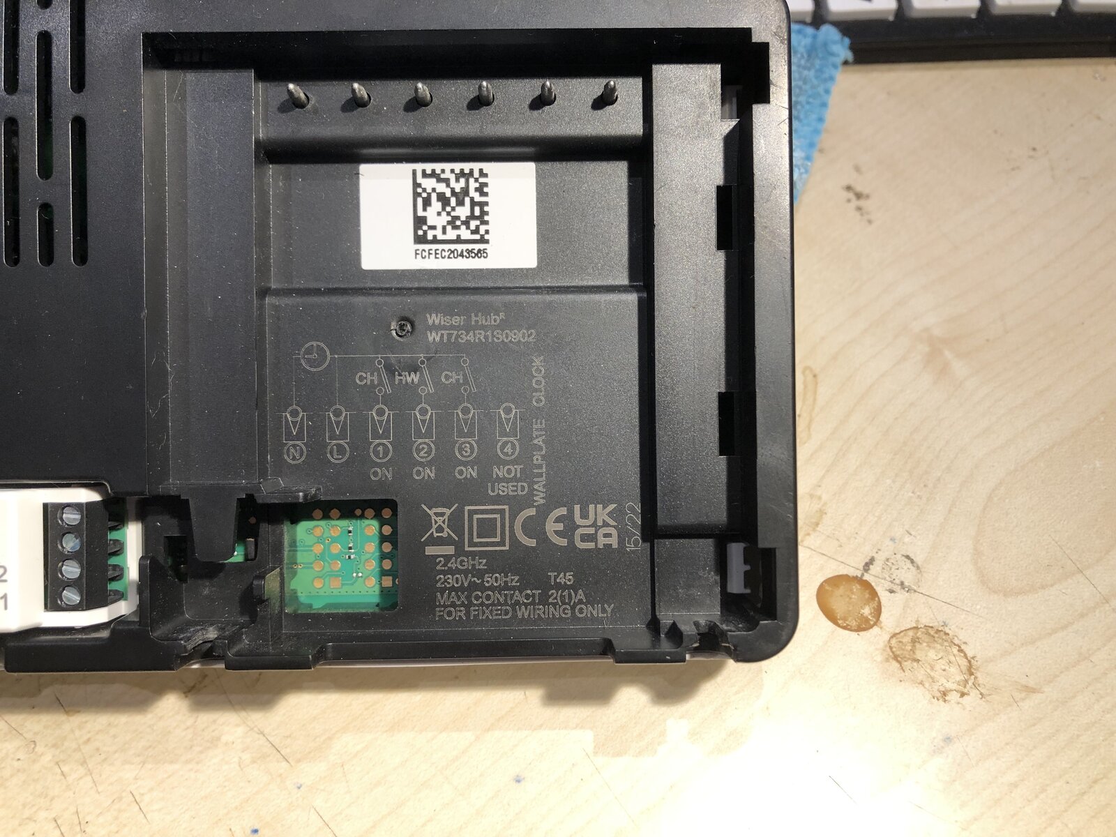

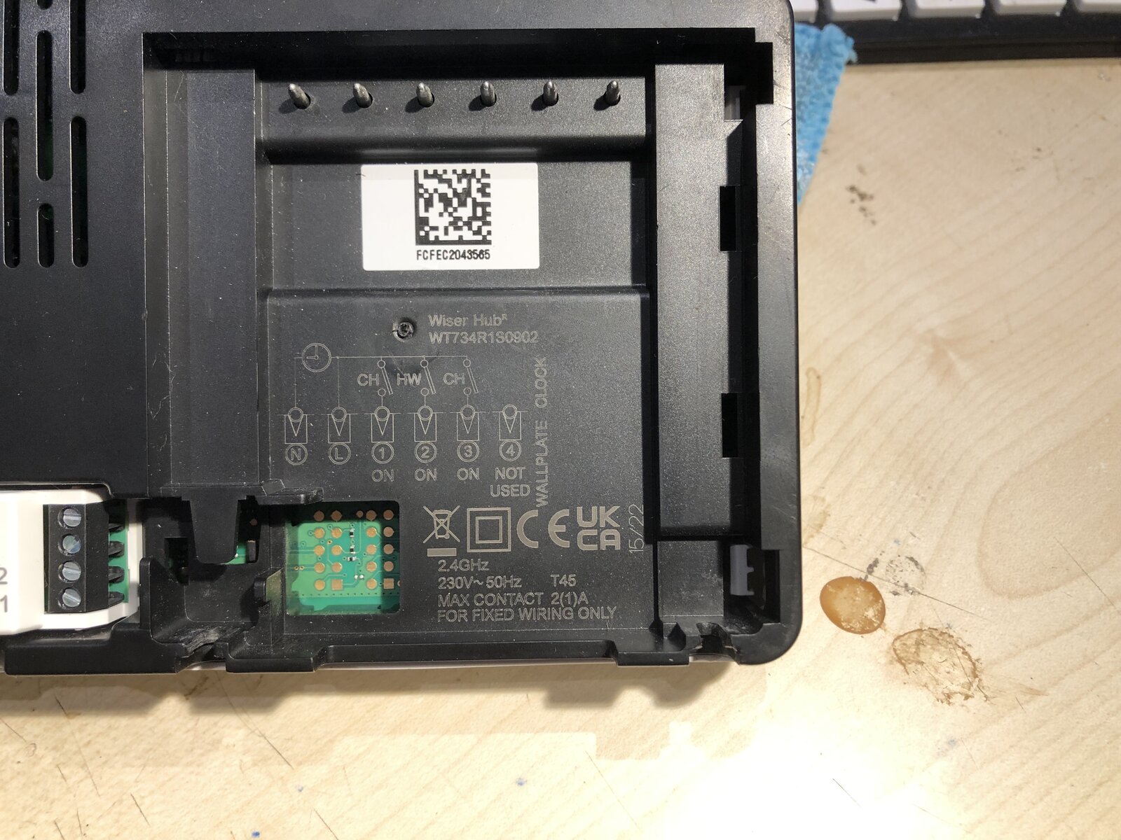

On the back of the hub is
WT734R1S0902
What has got me thinking is the small diagram on the back shows
1 CH
2 HW
3 CH
4 Not used
This is not the same as my backplate.

You have a kit 3 Wiser.

I would agree the names are not very precise. The 4th character of the model number tells you hub variety, hence WT734R1S0904 is the 3 channel model.
The Kit 1 & 2 come with one room stat whilst the Kit 3 comes with two room stats. Depending on what you purchased it may also come with smart TRV's.
Unfortunately Schneider/Drayton use "multi" in many ways. Sometimes it relates to the number of channels (1,2 or 3), or the number of defined rooms (aka zones).
