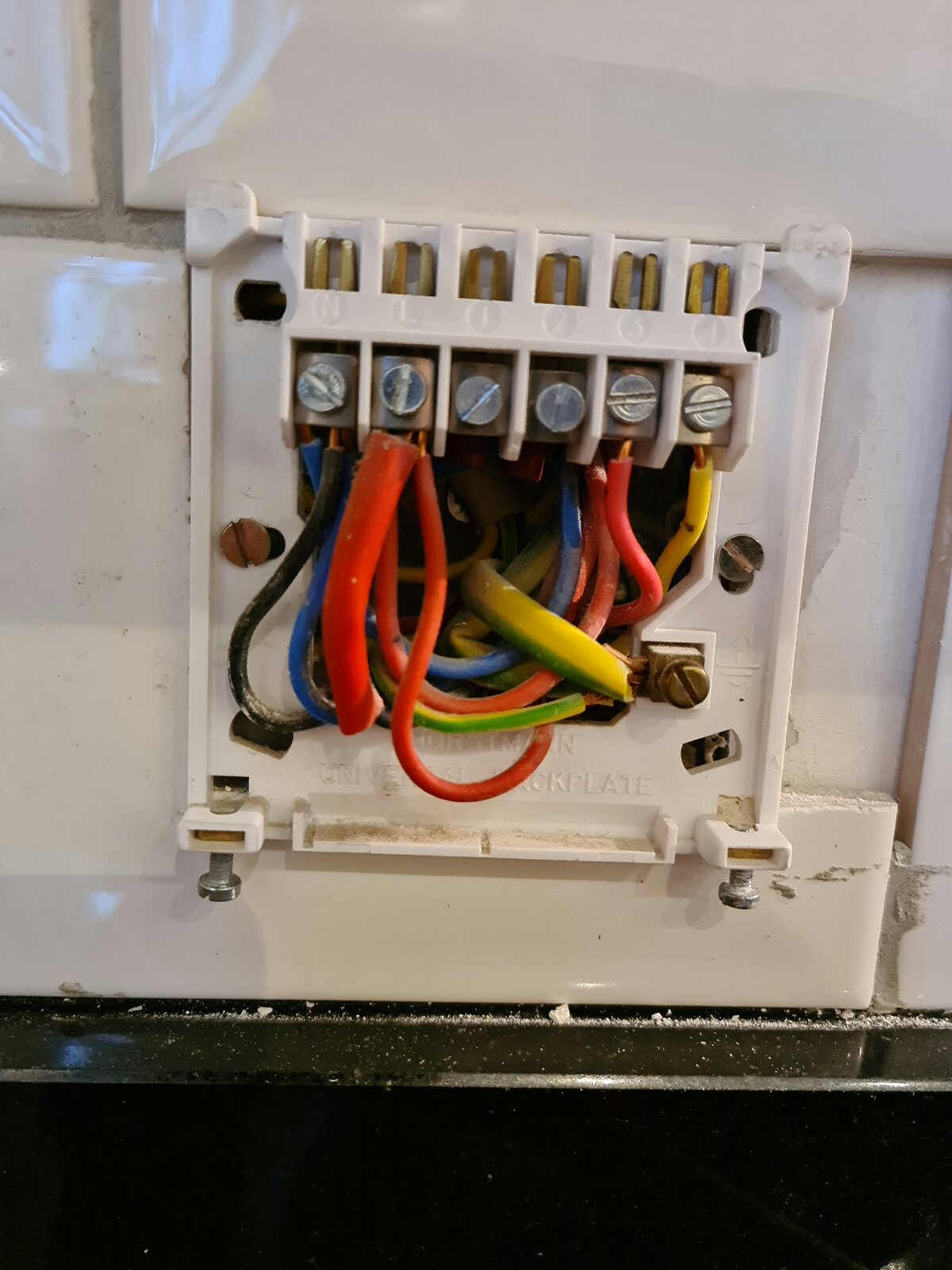

Hi, hoping someone will be able to help me here as am certainly a novice when talking about central heating controls!
I'm replacing standard heating controls for a Drayton Wiser Heat Hub 3 channel.
I have a Vaillant Ecotec 810 boiler, unvented hot water tank, Honeywell C27 programmer, manual stat downstairs hallway for all house heating(1), and a separate digital stat for conservatory heating (2).
Have managed to get hot water and main heating working fine through the wiser but stuck on (2) heat channel.
It appears the C27 is only two channel and I can't work out where (2) is going.
The backplate for the C27 has 3 live wires connected to L so was assuming (2) had been wired on to L to get round the limitation of the C27. Removing one of the live wires at a time produces following results;
Live 1 removed - boiler doesn't power on / heat hub doesn't power on
Live 2 removed - boiler doesn't power on / heat hub powers on
Live 3 removed - boiler powers on, hot water symbol on boiler, but doesn't get call from hub to fire up, and no heat symbol on boiler / hub powers on
Not sure what to check next.
Have attached pic of the backplate wiring (3 and 4 have been moved to 2 and 3 for the Wiser now).
Thanks for reading.

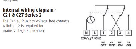

The C27 as you say, is a two channel programmer.
One channel for the hot water is connected to terminal 3 [HW on]. The other channel for the central heating is connected to terminal 4.[CH on]

If this is the case, both thermostats will be supplied via the wire presently connected to terminal 4. To install a 3 channel Wiser, you will have to physically trace the conservatory heating wiring and separate it from the main house heating wiring. Then reconnect it to the wiser third channel.

If the conservatory heating is not controlled by the C27 programmer and the Conservatory is fitted with a programmable type thermostat (ie one that gives both time and temperature control) then based on your description where you mention ‘3 live wires’ I assume that you are referring to the wires in the L terminal [the wires in terminals 3 & 4 are also live wires] I suspect that:
Wire 1 in L is the main supply from the fused spur [no power to either the boiler or hub when removed]
Wire 2 in L is the live supply to the boiler [no power to boiler, but power to the hub when removed]
Wire 3 in L may be the live supply to the thermostat in the conservatory
Although I’m not sure what you mean by your description regarding the function of wire 3
If my theory is correct, I would expect that with live wire 3 removed, that the main house heating and hot water should work but the conservatory heating will not. If so, this will be the wire for the 3rd zone of the Wiser.

Yes, sorry you are correct when I say three wires in the L connection of the back plate.
To try and explain Live 3 a bit better. The boiler has a tap (water) and a radiator (ch) symbol on the display when fully functioning.
When I remove live 3, just the tap icon displays. If I try and boost the water using the Wiser hub, nothing appears to happen with the boiler.
Hope that makes a bit more sense!
With that being the case, do you think it's worth connecting live 3 to terminal 1?

Just as an update, you were spot on, the Live 3 was the conservatory heating circuit. Once connected to terminal 1 on the backplate all started working as expected.
Now to look at removing the stats from the circuit, but think(!) I'm good with that...
Thanks for all your help, much appreciated.
