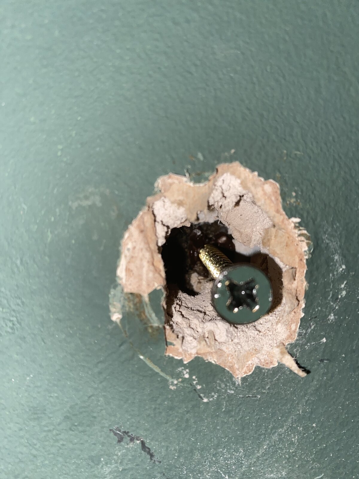

Hi guys
Trying to remove a screw that the previous house owner put in but it won’t budge. Dry wall but it has been drilled into the brick/stone behind. I have tried an electric screwdriver/drill, pliers and it will not budge at all. Also used wd40 on it and still no joy, any ideas?
A pair of locking pliers. Close them firmly round the head and turn. Worked for me on a very tight screw.
Tap it with hammer a few times and use screwdriver by hand.
A tap with a hammer, face on, is fine, if you hit it from the side, you may bend the screw, which makes it a PITA to unscrew it.
Hammer to the left , hammer to the right, hammer to the left, hammer to the right, etc etc till it breaks off then fill and make good
