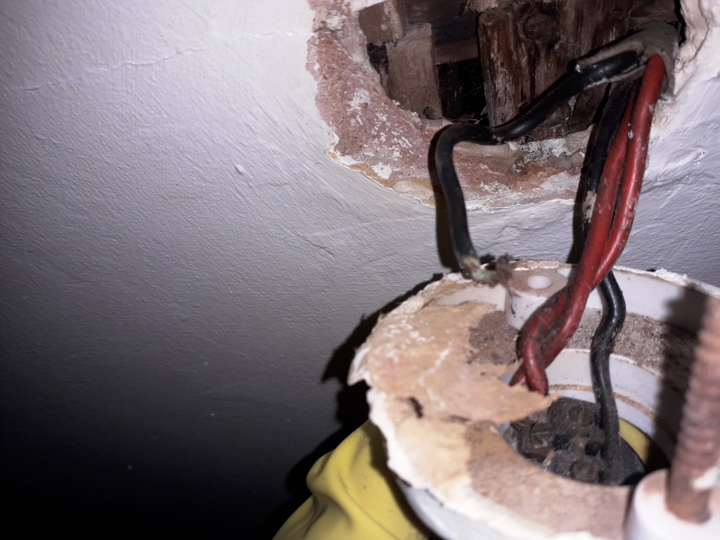

The bulb in my kitchen started blinking very slightly all of a sudden. I thought the bulb was on it's way out and replaced it. That's when the holder came apart as if it had rusted inside.
So, I went off to Screwfix and got this
https://www.screwfix.com/p/straight-loop-in-batten-lamp-holder-bc-2-52/8215d

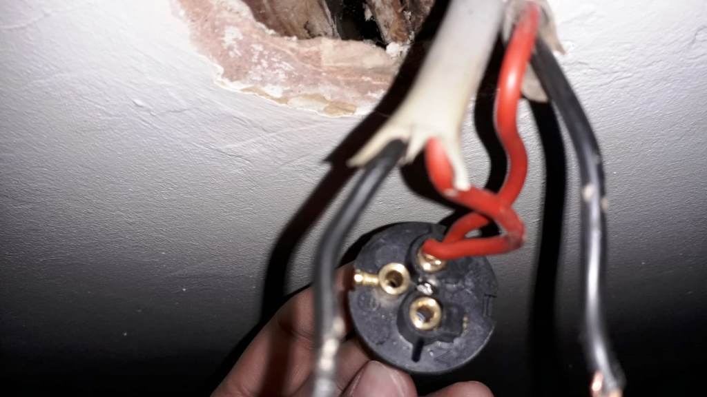

I switched off the mains and then proceeded to replace the holder. There are two cables coming from the ceiling and each has a red and black cable.
These are the pics I took before unscrewing the cables from the old holder :
The old holder does not have LIVE, NEUTRAL or EARTH markings on it. But, I saw that two reds were twisted together. So, I thought that means insert it into the LIVE slot. The black cables were confusing. I didn't know if the one I did not have to unscrew ( 1st pic ) had come loose or not.
What I thought would be a simple job turned out to be a messy trial and error for 3 hours.
I have tried various combinations but just can't get this working.

You have a supply from the previous fitting (live = red, neutral = black) and a cable from the switch (permanent live = red, switch live = black that should have a red sleeve on it), you have no earth.
The reds should be connected together, but not to the fitting, if your new lampholder has a loop terminal use this. The previous fitting used the earth holding terminal for this perpose, this is not the best practice, use a bit of connector block or a wago.
Assuming your new lamp holder is baynout type then it doesn't really matter which way around the blacks go, one to N and the other to L, if it was a secrew fitting, you'd have to identify them

No black cables have a red sleeve on it. Yes, there is no earth cable.
How do I know if this holder has a loop terminal?
WAGO seems to cost more than the lampholder?!
https://www.screwfix.com/p/2-way-push-wire-connector-773-series-pack-of-100/77102
Yes, it is a bayonet holder
I would use one of these
https://www.screwfix.com/p/mk-straight-batten-lamp-holder-bc-3-3/11499
Reds together in loop terminals, one black in L terminal other in N terminal

It has a ceiling rose ,like a junction box ,for making safely all the connections . Including the two red cables that do not connect to the lamp holder.

reds together, use a chocolate block or wago fitting, if chock block wrap insulation tape around it,
one black in L terminal, the other black in N terminal
The batten lamp holder in link has a rose ,( like a pendant fitting does)why would you need choc blocks or wagos ? The two reds just go into the roses loop terminals.
