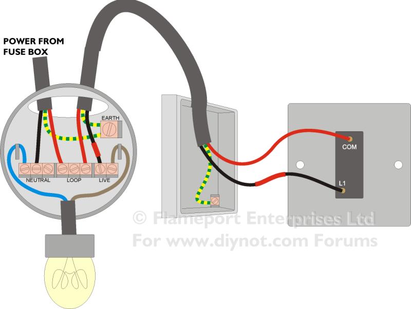

Hi, I was hoping someone could help me with an electrical mystery I have.
I bought a house recently and in the living room there were two ceiling light fittings - both with 5-bulb fittings that I didn't like and wanted to swap for single-bulb fittings.
The first one swapped no problem. Turned the lights off at the fuse box. Remove the fitting to find a red, a black and a yellow/green wire. Connected them up to live earth, neutral as appropriate, fuse back, on light works perfectly.
Second light, same fitting but took it down and it was more complicated. Two red, two black, two green/yellow coming from the ceiling and a lot of tape holding it all together. Foolishly I did not pay much attention and just started taking it apart, but then I noticed the red wires did not seem to be connected to anything.
It confused me how 'live' could not be connected, but there seemed to be a bit of red tape on the (now disconnected) black ceiling wires so I figured the wiring was wrong and it needed to be connected black live, green/yellow neutral, red earth. Connected like that and it tripped the fuse. I connected to the correct colours and it tripped also.
The old (5 bulb) light was working perfectly before I took it down, I have tried every combination and the new (1 bulb fitting) trips every time. Help!

You have connected the switch so as to create a dead-short when closed. That's why it's tripping the breaker, and as you seem to have been doing it over and over you may well have blown the contacts in the switch.
Have a look here and stop guessing.
The two green/yellow wires connect to the Earth terminal
The black wire is Neutral
The black wire with red tape is Live
The two red wires connect together but do not connect to anything else.
All explained here
//www.diynot.com/forums/viewtopic.php?t=37582
Randomly shoving wires into every terminal is NOT the way to solve problems, and could make things much worse.

Imagine you have live (red)
and neutral (black) from one cable.
You join onto the red with the red of a second cable which goes to the switch.
At the switch, this red can make or break with a black wire which is sleeved red - because it's live, NOT neutral.
This black but sleeved red then goes back to the light - the 'switch live'
The neutral is supplied from the first cable, and does not go the switch in any way.

Connect the two reds together. One is the supply, the other if the feed to the switch.
The black with red sleeving is the switched live coming back from the switch - this goes to the live terminal on the light.
Neutral from supply cable to neutral terminal on the light.
Your idiocy is staggering, you were shoving phase conductors in to earth terminals. This could kill someone (it's a good job your RCD worked), please don't do anything like that again.
This is how it looks using a normal ceiling rose and a single lightswitch:
Picture hacked together from several others, whcih is why some of the lines don't join up quite right.
Right, calmed down, studied the diagrams better and figured it out. Light now working perfectly.
