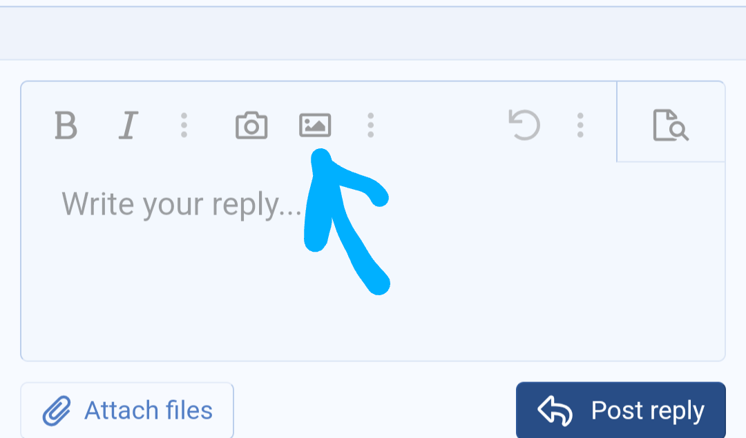

I tried to attach a photo, but I get an error. It says that it is too big, but it is only 500kb. Maybe it is because I am new user?
This is a dropbox link to the photo
Tap this icon and upload picture. Not sure what people are doing to struggle with uploads.

Done that. Keep getting this error after the upload is finished.
"Oops! We ran into some problems.
The uploaded image is too big."
The image is just 500kb
Have you got an "attach files " link under the text entry box?
