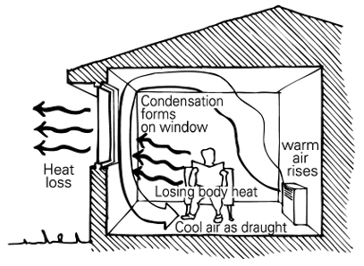

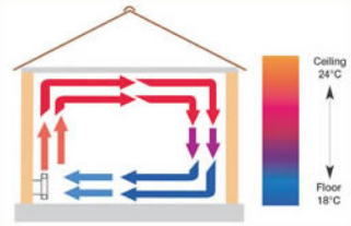

We have all seen the diagrams circulation2.jpg circulation.jpg and to some extent valid, although today with double glazing think the losses through windows is much reduced, but it is really not that simple. My first house cost a fortune to heat, it was gas hot air, and because fans moving the air whole house was same temperature.

This circulation.jpg may be the theory, but in practice we do get warm and cool spots within a room.

We have all seen the diagrams .... and to some extent valid, although today with double glazing think the losses through windows is much reduced, but it is really not that simple. My first house cost a fortune to heat, it was gas hot air, and because fans moving the air whole house was same temperature.
You don't need to tell me - it also costs a fortune to heat (the air in) the ground floor rooms of my house (with CH 'radiators'), where the rooms are about 3.5 metres high. During cold weather, there is usually at least 5°C difference, often a lot more, difference between air temp at floor and ceiling level - that means that we often have to get the air temp near ceiling well over 30°C for the temp to be reasonably comfortable at 'sitting level' in the rooms.
However with my mothers house I had a collection of thermometers in the room, and within the same room they could show 18°C to 32°C, OK mainly due to sun in the bay window, but air does not circulate that well. This ... may be the theory, but in practice we do get warm and cool spots within a room.
Yes, of course, but the 'vertical' temperature variations are much more inevitable (reliant primarily on the Laws of Physics), and much less easy to do anything about, than is the case (e.g. by double glazing/curtains, positioning of radiators, closing doors etc.) with the 'horizontal' temperature variations which are what I think you are mainly talking about.
However, none of this alters the general point I made, that when one uses heating methods (e.g.CH 'radiators') which rely primarily on convection, it doesn't make much difference whether the radiators are low down, half way up the wall or even 'near the ceiling'. In all cases, the air in the room will essential heat up 'from top down'.
Kind Regards, John
