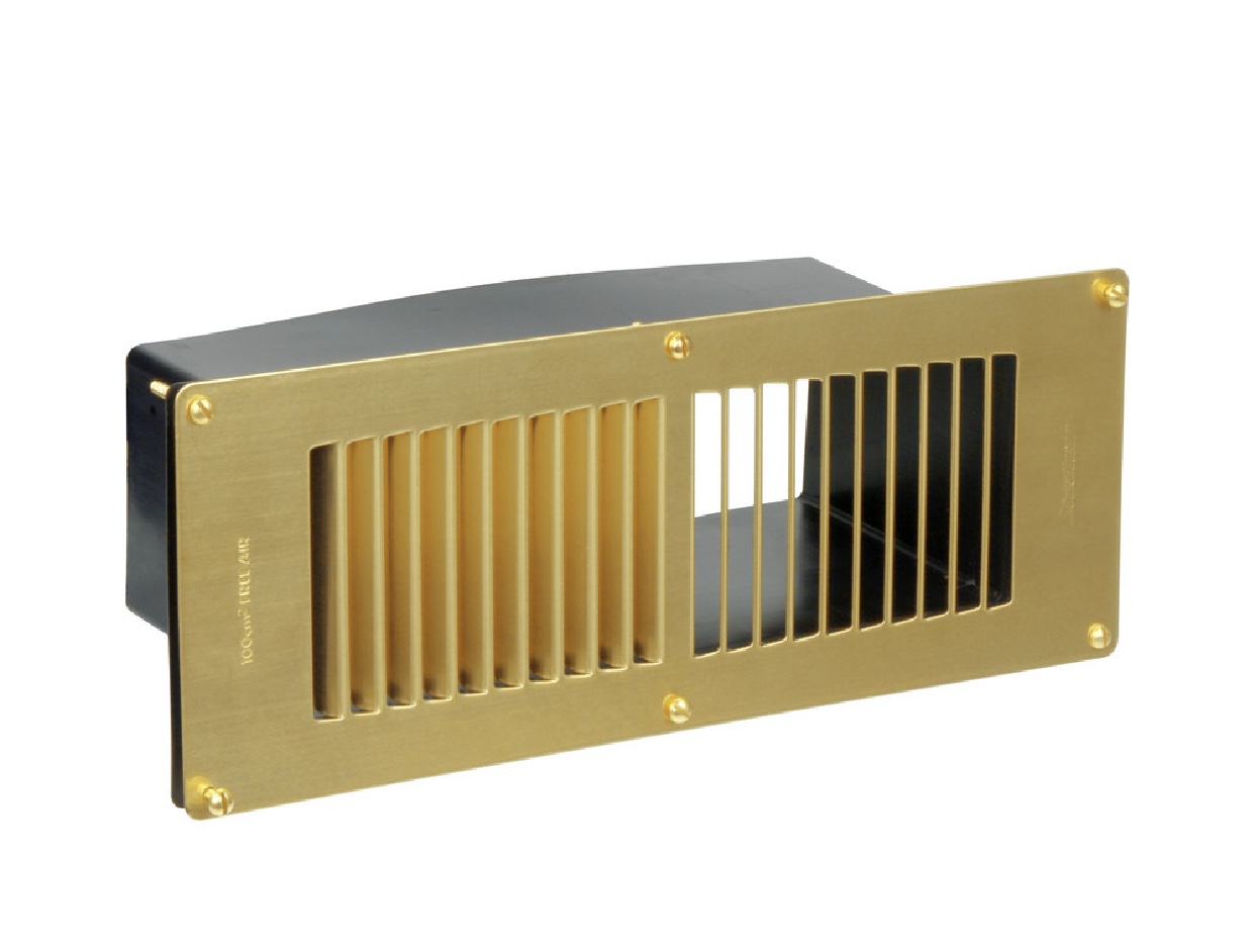

Hello,
I’ve doing an extension which isn’t very big about 8ft by 6ft. Problem is that i need airbricks as i’m having a sub timber floor. I only have one side that i can put air bricks on and it is tricky. As it a small extension, I was wondering if i could put air vents in the floors maybe 2 or 3 as this will allow air to get underneath. The vents are shown below:
Thank you!
Check with your bco- those floor vents will cause massive draughts. One solution is duct in to the side you can't ventilate (110mm waste pipe) so you get a through draught, which is what you need
Hi.
On second thought I see I can get these telescopic air vents which i will most likely put 2 on 1 sides and on another side another 2. Do these vents bridge the cavity, as does the neck touch both skins or does it only touch one and then go onto the other skin with the brick head bit.
Oh so you have 2 sides you can get at? Those telescopic things are designed so the vertical bits are in the cavity and the horizontals in the brickwork. Easy to fit when building, pain as a retrofit- you'll have to cut a block or 2 out
Yep, two sides but the usually air bricks usually go horizontal, but after i found these i can now go down a couple of courses. Can i also put this on the course of the dpc and lay the dpc on top of these air bricks?
Cheers
Yes, stick some mortar round/on top of the plastic thing so you don't end up with a mouse-size gap
