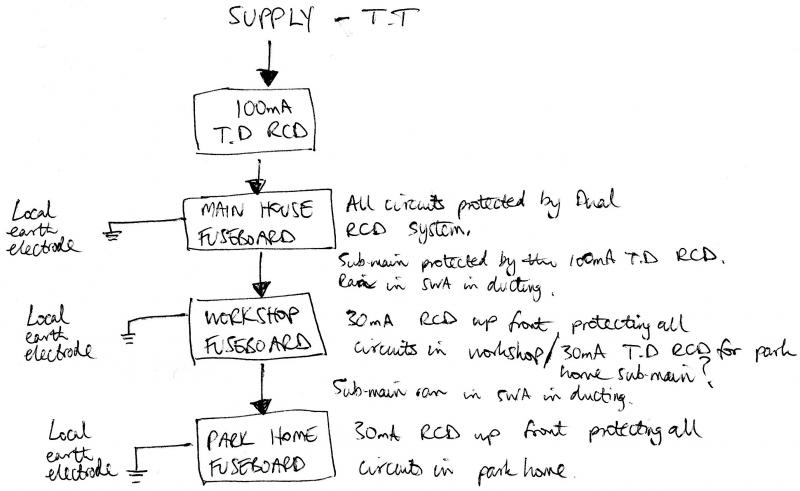

Hi there, I have just been asked to quote for a job and am need of a little input from you guys if possible. As the picture shows it is a series of sub-mains and i'm wondering what the best set-up could be with out involving RCBOs. It is a TT system and would require earth electrodes in all locations due to the distance between the locations.
What are your thoughts to the set-up as shown in the diagram??
Your input is much appreciated.
Dave
A 100mA TD RCD won't necessarily discriminate with a 30mA RCD. You may have to go to 300mA TD.
Also a 30mA TD RCD will serve no useful purpose either for your park home sub-main.
Why not split off the garage from the house ? As it is, a fault in the garage or park home would take out the house as well - which I'd imagine would be "very annoying". So split off the garage supply on a separate TD RCD - or could the submain be run without upstream RCD if the cable type is chosen properly and the earth rod is low enough impedance ?
Series connected RCDs will not discriminate unless they have substantially different tripping times - ie the upstream one is time delayed. Potentially a slowly developing fault might trip the more sensitive one without the other, but in general a fault will create a leakage current that is substantially larger than the tripping current of the RCD - the RCD does NOT limit the magnitude of this current. Eg, you may well get several hundred mA - which will trip both the 30mA and the 100mA. If the 100mA upstream is time delayed, then the 30mA one should have tripped (cutting off the fault) before the 100mA one times out. But if the time delay isn't enough, then allowing for the contacts on the faster one actually opening, it may have reached the "point of no return" before the fault is removed.

Thanks tor the input guys. So, simonh2, are you saying from the meter take the tails into henley blocks, then a set going into a time delayed 100ma rcd unit for the submain to the workshop. The workshop fuseboard could then be a dual 30ma rcd board. Then from the henley blocks I could take another set directly into the main house fuseboard. This could just be a dual 30ma rcd board. What would be the best option then for the submain going to the parkhome?

At the moment the supply comes into the house, service fuse, meter then into an old voltage operated earth trip. This will be replaced by a couple of time delayed rcds. One for the house board and one potentially for the submain to the workshop which will also be suitably fused down. I hope this is a bit clearer. I'm still scratching my head for the best solution for the supply to the park home from the workshop. TT systems do make it a bit more difficult to set up!! FYI the Ze at intake is 3.81 Ohms.
Yup - split them off (with, as pointed out) the correct overcurrent protection etc. That way, when you trip the RCD from the garage, you won't plunge the house into darkness as well. It's bad enough tripping the garage out and leaving yourself stumbling in the dark - but if you have to go back to the house in the dark then that's even worse.
Consider the third "site" as well. Ideally arrange that so it doesn't go through the garage RCD. Either split the incoming submain, or take it off an non-RCD way in the garage CU (and provide local RCD protection at it's CU). I'm assuming the layout doesn't lend itself to running this as another submain from the house.
