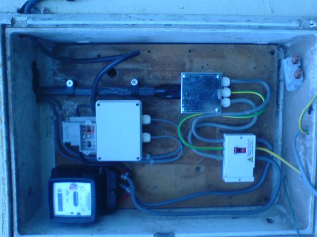

I doubt there is space for that now after 2 days work to relocate the CU, plus he is going to need another day for testing in the future, 600 quid total for what isincreasingly sounding like a botched job.
Its been sightly modded since, but this is what it looked like after day 1:
I reckon a DP 80a 100ma S type below the meter then to the KMF switch fuse will do the job. I can use the one currently installed in the CU (incorrectly I believe, both sides should be 30ma versions nowadays to protect ccts). I will then install another KMF upstairs to where the 25mm SWA splits with a 63a fuse in place.

That adaptable box needs altering too, as live and neutral enter through seperate holes which is not allowed.

Was put there temporarily.moved following day to where the metal adaptable is to house 2X100a henley blocks to join the 25mm SWA and the tails. At that stage was purely there to house thejunction between 2 2.5mm cables. Overkill, but its all he had at the time.
Would you agree getting the lad to put in an s type RCD between the meter and the KMF would solve most of my problems? I dont want to **** the spark off, we all make mistakes, but I would rather he sort it than me seeing as its his pen on the sheets. I can deal with stuff downstream of the CU, new finals etc, what I dont want to do is b*gger round with tails straight from the meter.

I'm confused. Does the SWA now terminate into the plastic adaptable box, and the metal one has been removed or something else?
If it'll fit then you could install a type S RCD between the meter and the KMF.
If not, replace the KMF with a mini CU as I described above.
Regulation 521.5.2 does not allow it. It is because in an AC circuit current flow produces a magnetic field around the wire. If this wire is passed through a hole in a ferromagnetic enclosure, and it's neutral and protective conductor(s) through another then an eddy current can be induced into the metal.
What I meant was, the metal adaptable was swapped out for the plastic enclosure the day after, with another smaller adaptable where the current (big) one is currently. As the new adaptable is plastic, I take it induction will not be a problem?
Finally, bearing in mind I want to up the supply to 100A in the near future with the DNO, will it be worth getting a seperate KMF installed to the 16mm where the 25mm is split into the main CU and the 16mm? If there is RCD protection at the meter box, I may be jumping to conclusions here, but there should be no requirement for one after the henley blocks, as the one you are suggesting between the meter and the KMF in the picture will pick up any inbalance between phase and neutral?

Well, if you want to suggest how I am supposed to do that with rec requirements for a switchfuse with all tails >3 metres, be my guest... same with a tt supply and associated earth blocks...
Bearing in mind a month ago, I had a plastic enclosed CU in the meter box, with all circuits routed up the wall cavity, what we have now is certainly an improvement.

If your REC is happy with it, fine.
I assume there is nowhere within 3m to fit a point of isolation, without putting your own ODVC alongside or above
To be honest, I didnt ask. Seeing as they have been notified 3 times of a door that is hanging off the meter box with no engineer. Unfortunately, the only point would be upstairs by the henley block, which is pretty pointless.
The responsibility to keep it dry is yours*, so as I see it you've installed a lot of equipment in a situation where it could get wet if the door falls off!
