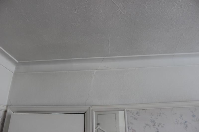

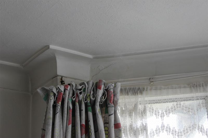

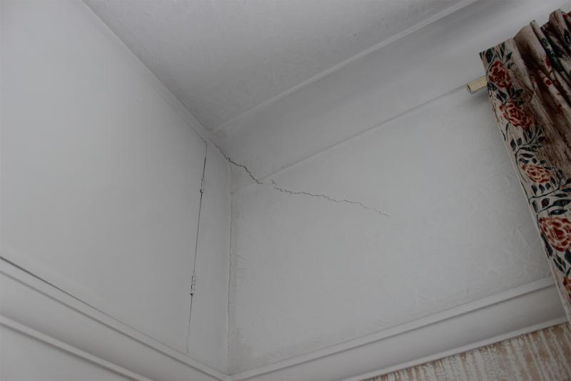

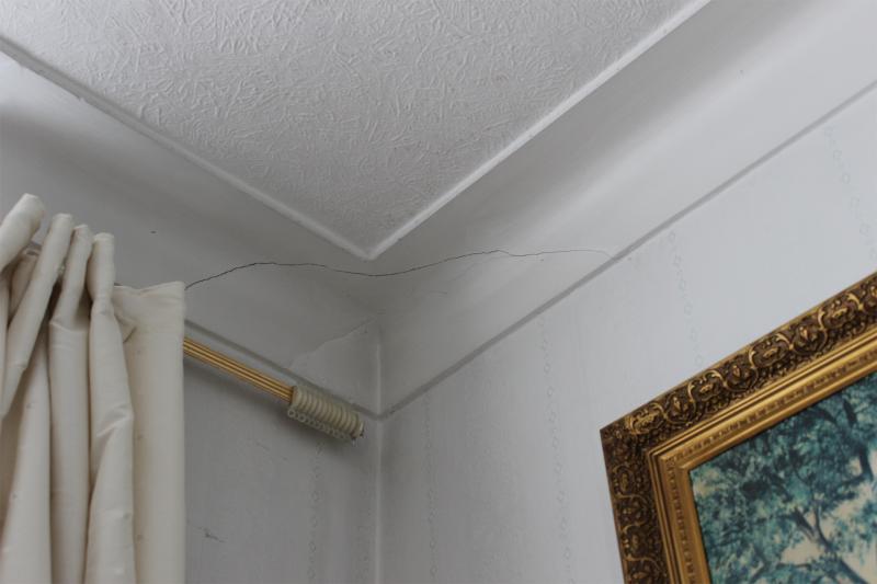

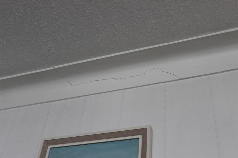

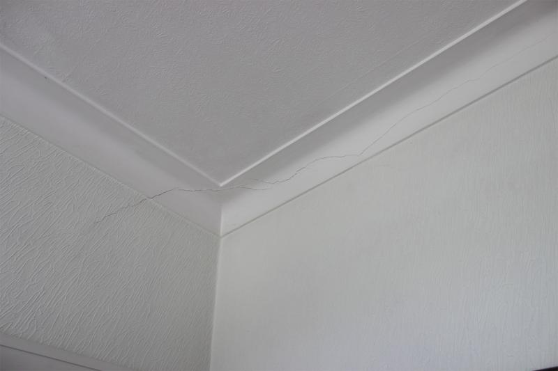

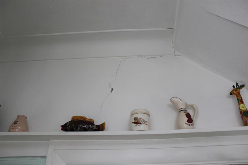

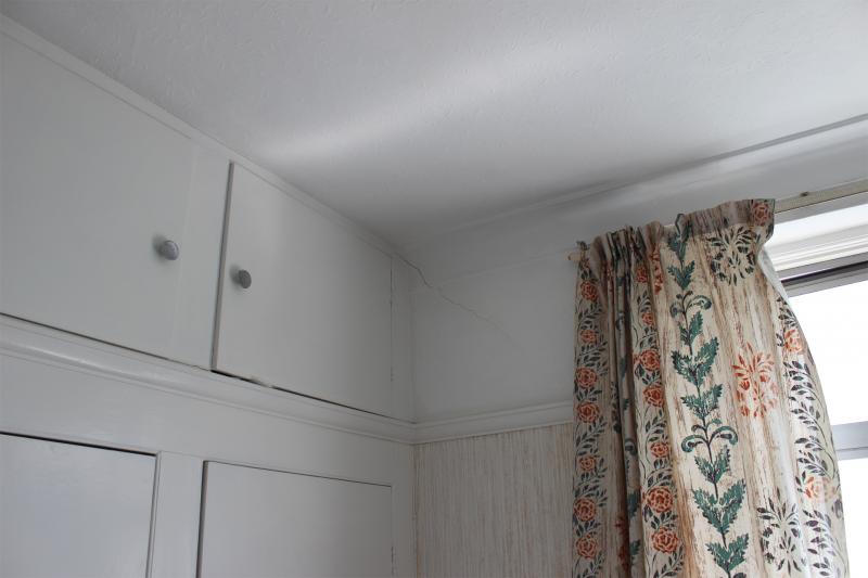

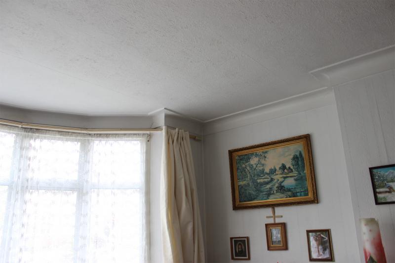

Pictures (pic followed by close-up)

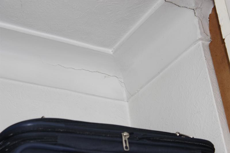

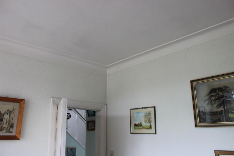

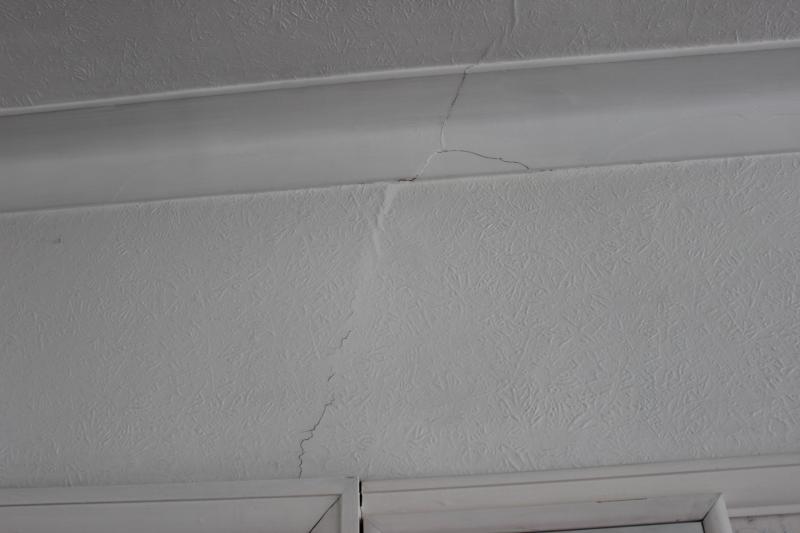

The crack in this picture is 3mm – this is the largest one I believe. Note: the family friend/owner informs me that the door in this picture, which appears crooked, was cut uneven by him, i.e. this here is not a crooked door frame, at least not obviously.

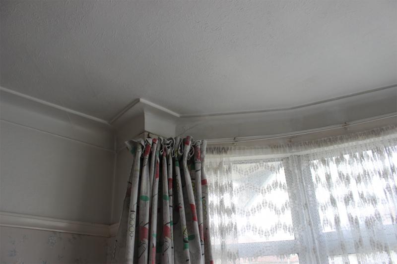

Here you can probably see the crooked door frame.

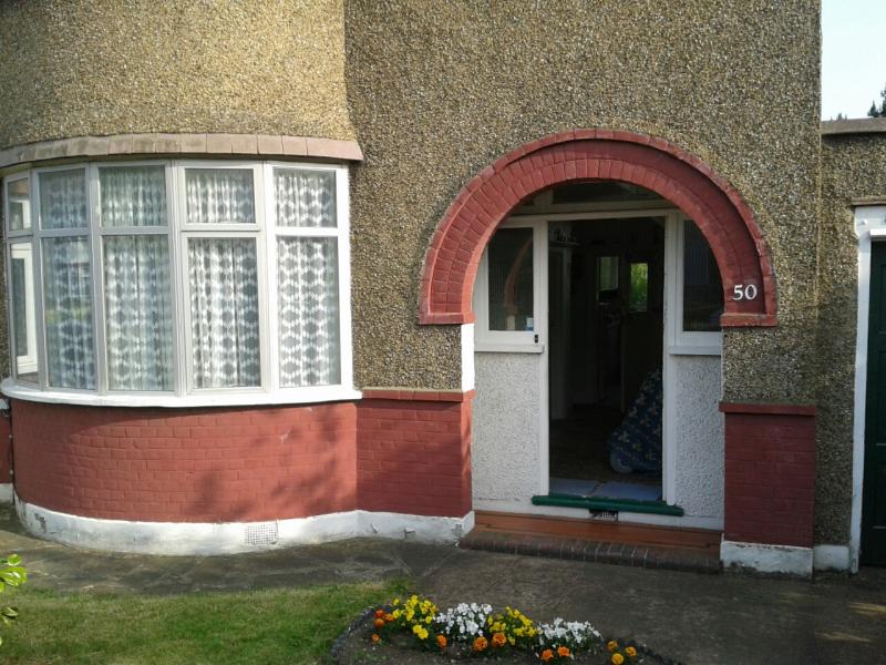

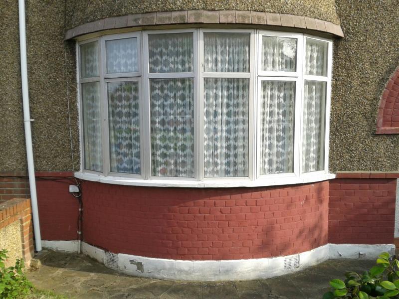

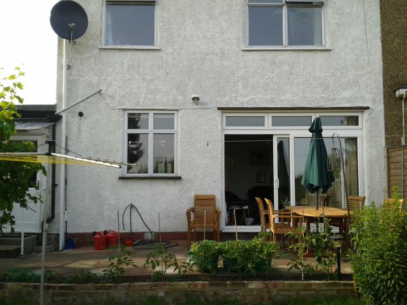

Some pictures of the outside would probably help put things in context.
Subsidence is either ongoing or may have happened due to a problem that has since been fixed. Everything in your pictures looks fairly old and if it was still moving then you would have some much more significant cracks.
This looks like settlement or old movement and I would not be overly concerned, I'd make good and then keep an eye on it - the chances are it is done and dusted.
HOWEVER, I am now expert and we would need to see much more to make an informed decision. My house is 130 years old and has been underpinned due to subsidence which was the result of a failed drain, the underpinning was done 30 years ago and there is no ongoing movement. I do still have cracks like yours in a few rooms which haven't yet been renovated.

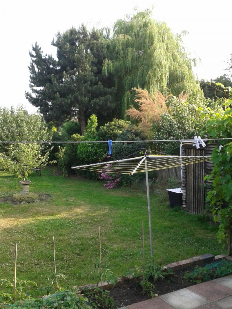

As the bloke from last century says, post up some external pictures, not too close though - of the whole elevation and then places where there are cracks. Also note positions of drain gullies, drain runs and large hedges or trees
From the style of architrave, the house looks like 1930's, they were built with shallow foundations and with soft mortar so are designed to move. What you have is absolutely standard for every 1930's house I've ever owned. The house is 'flexible' it's not going to collapse or sink, but polyfilling/ replastering/ replacing coving are jobs that have to be done every 40 years or so.
Don't bother with insurance (if they get involved and comission underpinning, you'll find most potential buyers in the future will be put off).
Having settled, the cracks aren't likely to get any worse. if you polyfill, the cracks will be back within 3 years (hairline only). It would be better to hack the plaster in the affected areas back to brick n replaster, above door frames is a classic weak spot probably not helped by bad bonding of 'breeze' blocks, attach some mesh to the blocks either side of the crack then get replastered.

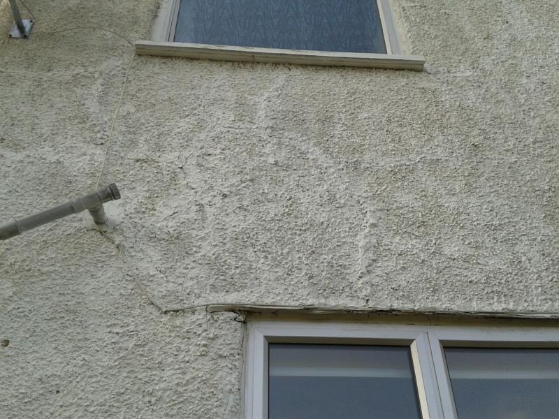

I will get some pictures of the outside soon, but there are no cracks visible from the outside. No hedges whatsoever; large trees at the bottom of the non-attached neighbour's house (I think the garden is approx 40-50 meters but I will check). Incidentally cracks are mostly near the internal wall between the two attached houses. I will mark positions of drain gullies, drain runs.

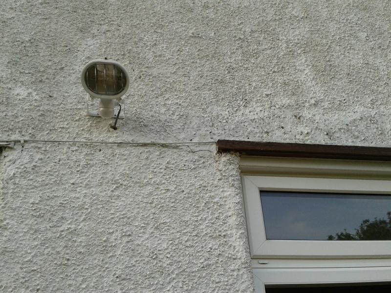

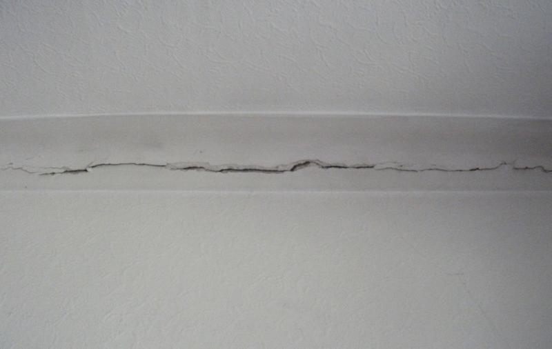

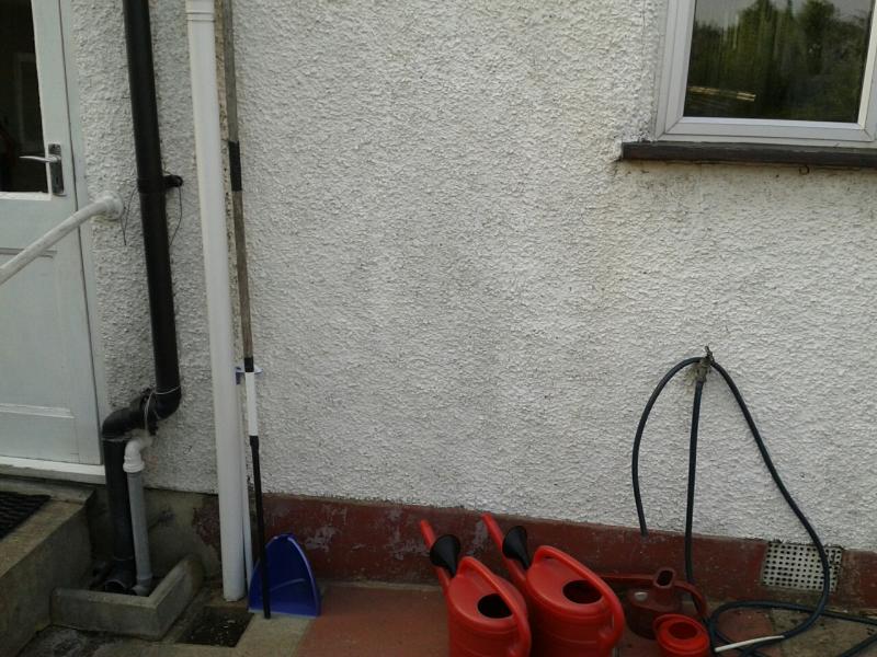

Forgive me, I was wrong, some cracking is visible from the outside at the back of the house. Hope these are ok.
The garden is 30m long (not 40-50 sorry). I have posted a picture of the trees - sorry I don't know anything about trees and whether these are the type with big bad roots.

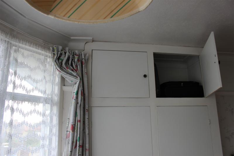

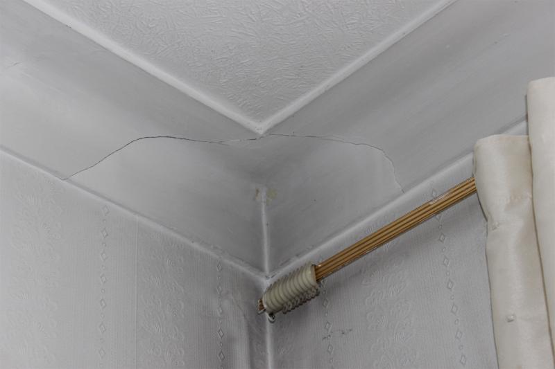

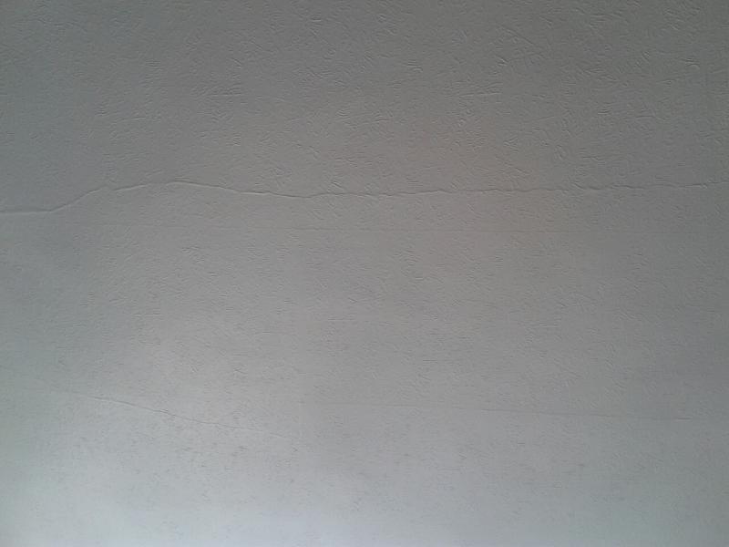

This one I forgot about before: north bedroom ceiling

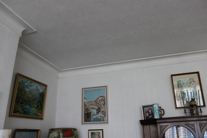

By the way, I have titled the pictures in the album to give orientation:
//www.diynot.com/network/lm713/albums/16964
There does not seem to be anything there which screams out subsidence.
Perhaps some typical internal movement responsible for the doors, and some thermal (shrinkage) movement for the covings

Take a look at these pics from my own (1920s) house showing cracks in the same position as yours, bur somewhat larger
Is it subsidence? Possibly
Is it long-standing? certainly - it's been like that for years.
Am I concerned? Not in the least.
