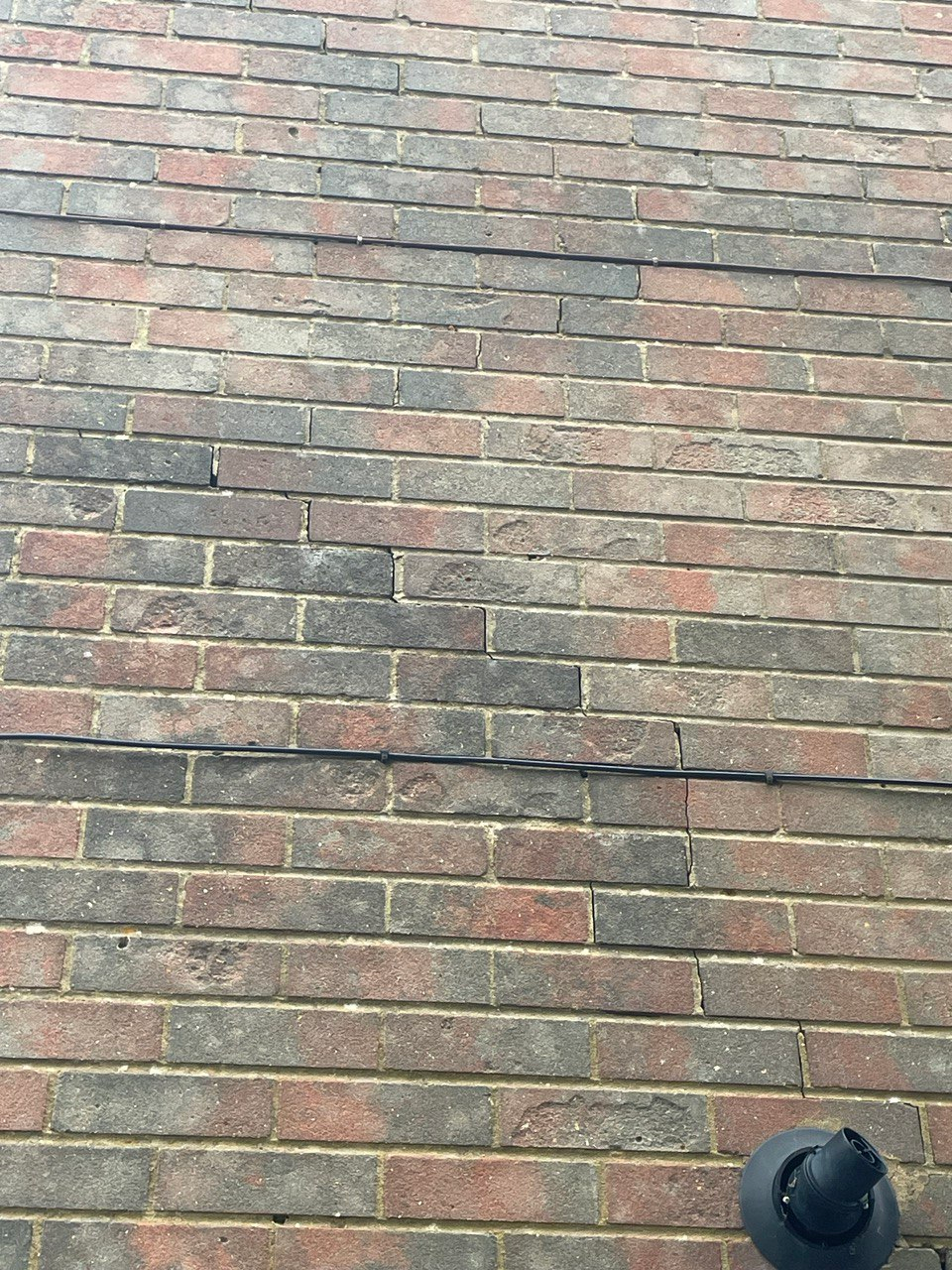

Hi guys, found a property in my area (Dorset) that ticks the boxes and we'd like to buy it. But on closer inspection of the walls around the property we found some suspicious looking stair-step cracking in the brickwork. See pictures attached.
The first picture should be the cracking on the front of the house, it's above the downstairs toilet window [near the right side of the house, to the right of the front door]. The cracking extends up towards an upstairs window, but not quite.

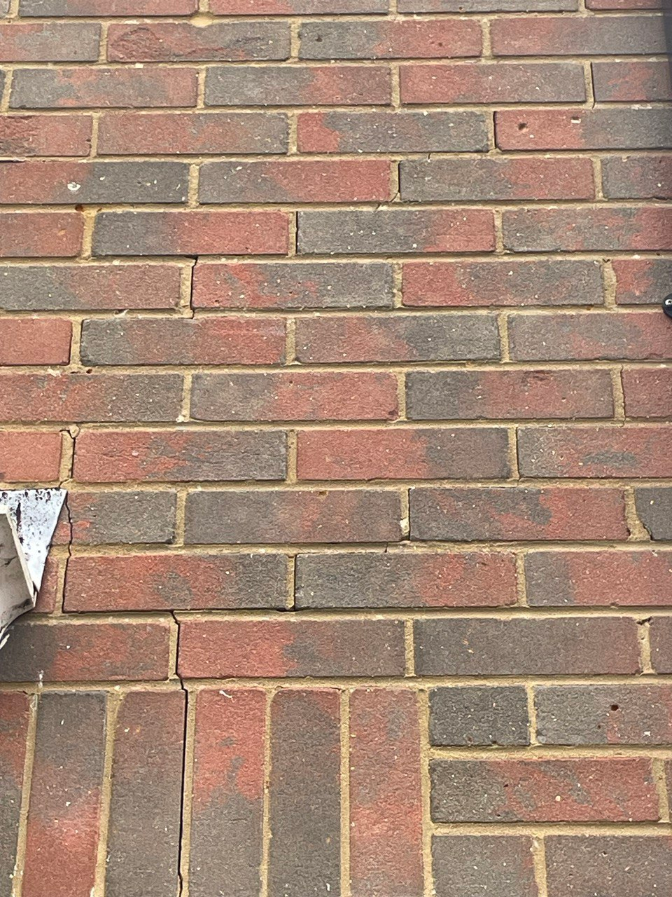

The second picture should be of the side wall of the house [right side wall, picture with horizontal wiring/cables in the brick] , the cracking extends up towards the roof, but not quite.
Question is, whether this is classic subsidence and not looking good, or whether this is settlement and pretty common given the dry summers.
I can't give much detail in terms of the mortar used. But the house particulars say it's a 1970/1980 house, link detached, in Ferndown, Dorset.
Best guess are that the cracks are between 2-4mm.
What do you think?
From the photos it looks like horizontal-only movement, so is possibly just shrinkage as it dried out after building.
Is it quite a long wall, perhaps including adjoining houses?
Also check the inside walls in the same places for similar signs.
A photo from further away would be useful, even if the crack isn't visible. It's possible that this is just the weakest point in a long wall, i.e. where it's weakest vertically from the door and window openings. It may have needed a movement joint really, but if you don't put one in then it makes its own.

The side wall [with the boiler flue] is a single wall from front to back. It's not attached to another property, but it is connected to the garage at the bottom. So the picture is from just above the garage. (The garage is connected to the next house).

Look like shrinkage cracks. Possibly calcium silicate/sand lime bricks or similar.
