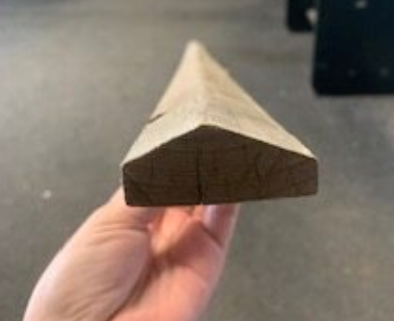

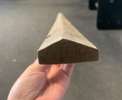

Thanks for that - I *think* the wood has actually been painted, but I'll have a proper look tomorrow... when you say "capping piece", do you mean this sort of thing?
That looks ideal.
I think I've seen some with a groove in the bottom, so water drips off.
Fence stain leaves a water-repellent waxy film. Once the gloss has weathered off it can be cleaned snd recoated. No sanding or scraping needed.
