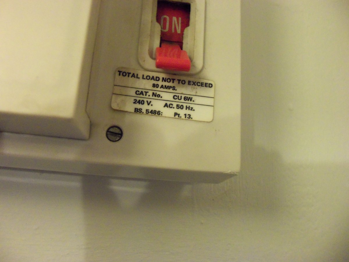

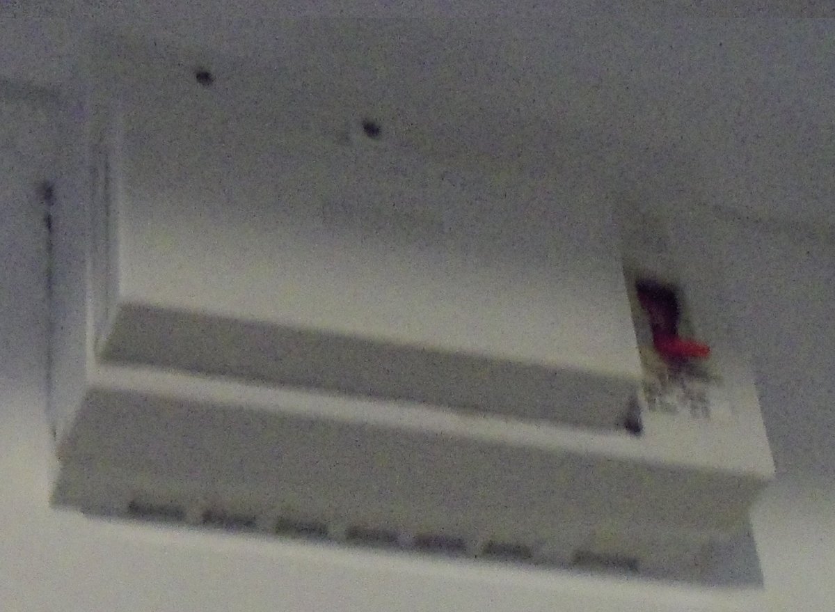

My house was constructed around 1986. It is a three-bedroom one, with a kitchen in the ground floor, three bedrooms and a bathroom I the first floor. The house is central heated with a 5-year boiler in the ground kitchen, an immersion heater and a shower pump in the first floor, and a water tank in the loft. The cooker is electrical.
I would like to extend the house into the loft, and add 2 bedrooms and a bathroom. If possible I would like to remove unnecessary appliances/the water tanks to create space. I am enquiring about plumbing requirements and constraints. From you I need suggestions on a suitable fuse box that can service al requirements.
The attached photographs show the current fuse box.
A consumer unit (CU) no longer called fuse box as it no longer has fuses, today come in many flavours, the main point is how many RCD's are fitted, a RCBO is a RCD (which detects leakage to earth) so you could have just two or you could have 20.
The RCD is a problem in that 30 mA is not much, and having just two means with a large installation they may trip for no apparent reason on a regular basis, the RCBO is in general less likely to trip for no reason. But using RCBO's lifts the price. So you need to balance cost and inconvenience.
As to plumbing the instant water heating offered by the combi-boiler seems good, but many are returning to using tanks again. The combi will only supply one shower at a time and it will not allow solar power to be used to heat water, often the boiler has a small reservoir so water starts cold goes hot then cold again then hot and stays hot as reservoir empties before heater has warmed replacement water.
Also any power showers become illegal and have to be removed.
It would be nice to see behind the cover to see what sort of protective devices you have.
But my guess it is the old style re-wireable fuses and your installation does not have any RCD protection.
RCD protection is mandatory for new circuits so you will be needing to change that old furseboard for one that meets today's regulations.
A suitable fusebox will be one that is designed and supplied by a registered electrician as the work you have in mind will need to be notified by a member of a CPS scheme, otherwise you will not get a completion notice from BC for your house extension.
You can ask for a fully loaded RCBO type consumer unit (an RCBO combines an RCD and MCB). This will be expensive but an issue on a socket circuit circuit (i.e. dodgy kettle etc) won't trip anything else i.e. your lights.
You can ask for a "17th edition" consumer unit which usually has two RCDs and then splits the circuits between them with MCBs. The downside of this is having lights and sockets on the same RCD, if a fault occurs it can trip the lights. The advice is to have up lights and down sockets on one RCD, vice versa on the other. This is usually the cheapest compliant option.
You can ask for a "17th edition" consumer unit with a few RCBOs on the high integrity ways and MCBs on the other two RCDs. If you only have one socket circuit this is probably the lesser of the evils, where your lights are on their own RCBOs so a fault on a socket circuit doesn't trip the lights.
It is up to you what you want to pay for, your electrician will be able to give more advice.

You cannot possibly, unless you are virtually certifiably insane, even think about doing that without Building Regulations approval.
Therefore....
No - from us you need it pointing out that you are going to have to use an electrician, a registered one (probably - unless you want to needlessly pay more money to Building Control), and that therefore you should leave it up to him what to do about replacing the CU.
