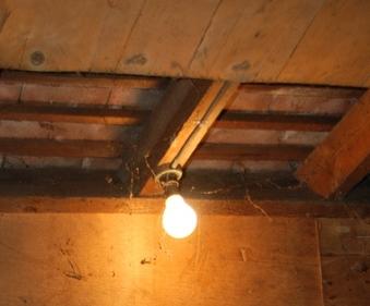

Often the light switch drops will have been done in conduit, so new cables can be drawn in.

Talking about conduit, I think there is big chance there is one as it look light loft light has one on the attached picture.

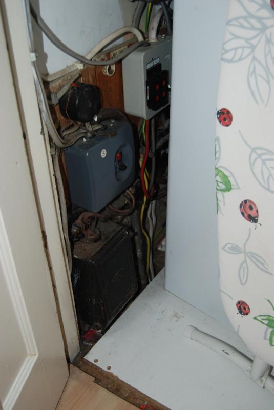

Having seen the picture below, do others agree that those exposed terminals above that metal fuseboard at the bottom of your picture (which does look to be 1930's in age) look as though they could be live, and totally exposed to being touched?
The best thing would be not to go near that lot, keep the cupboard closed and locked until a sparks can advise what you are dealing with.
I'd suggest you aim to rewire, in all honesty. There will never be a better time to have it done, and then you can know that everything is safe and up to date. As others have said, any extensions could well not need doing, so that may make it slightly cheaper.
