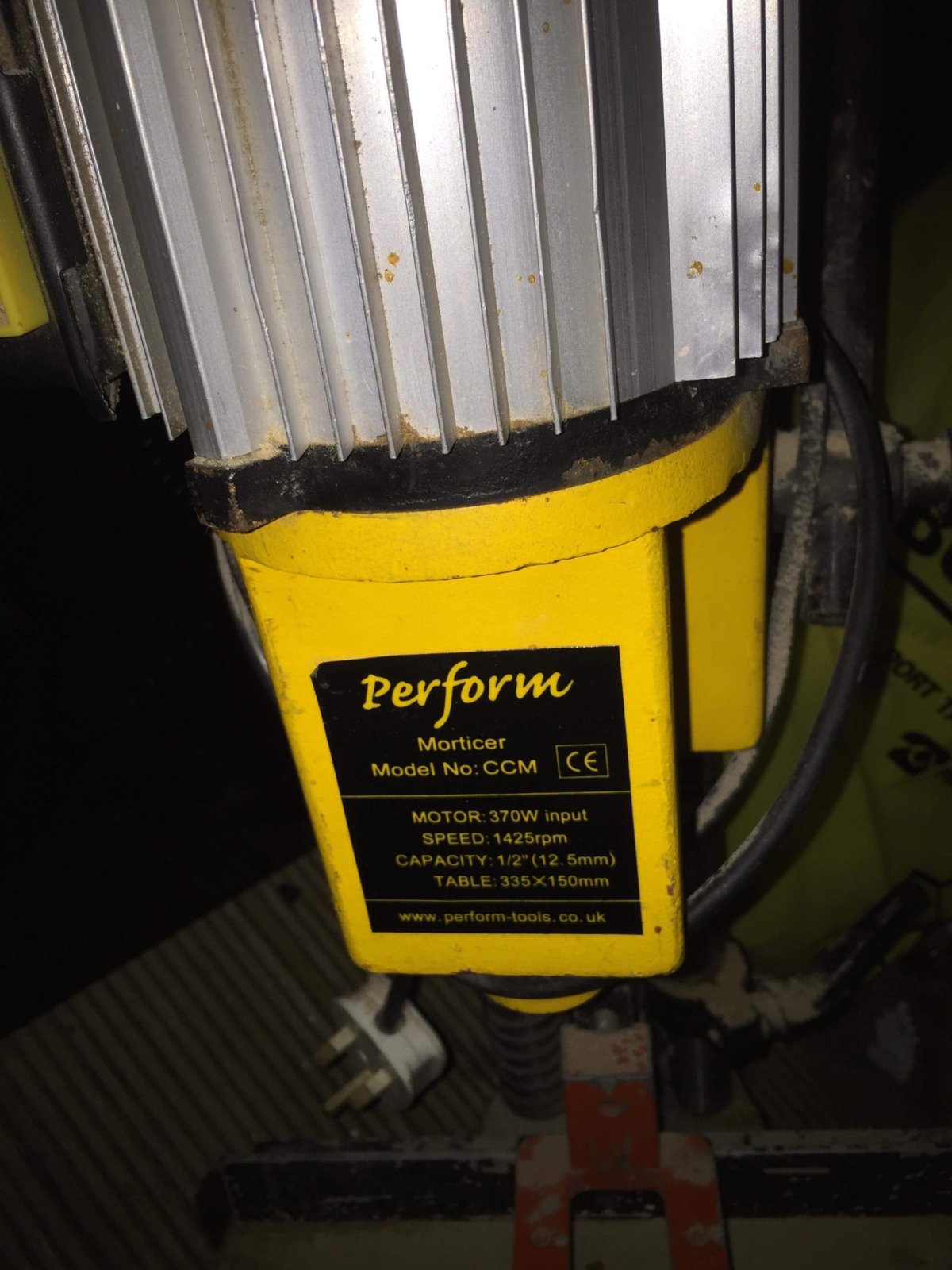

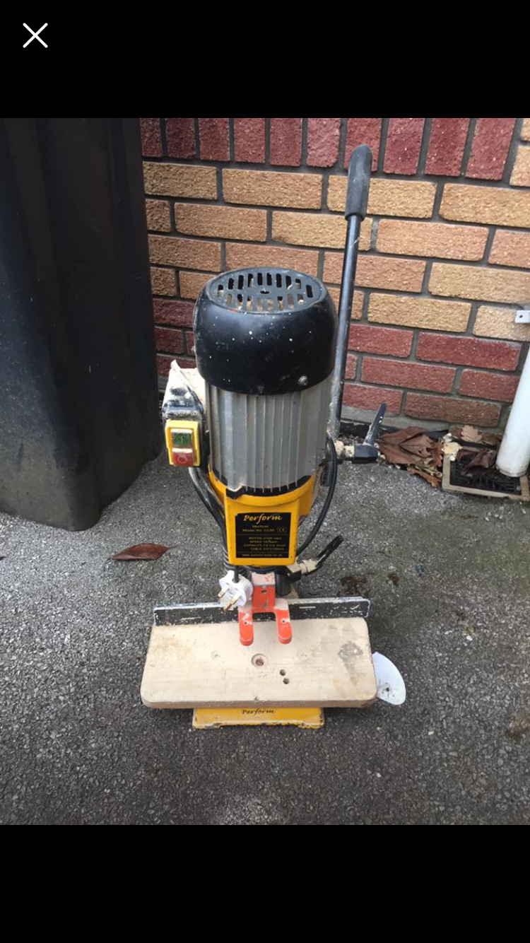

Hi all,
I'm going to attempt to build driveway gates for my new house, it's a project I've wanted to do for a while and I'm looking at a second hand morticer advertised locally. Could anyone advise me on whether this machine would be suitable to chisel mortices into 4x3" timber or is it not big enough etc?

I have the JET version of that which is rated for 13mm.
You'll need a 20mm chisel and larger machine.

I dont think that is a very rigid machine, but if its not much money, it would be worth a punt. Also perform is an Axminster brand so they may have spares.
The best bench top morticer was the Multico PM12, a solid cast machine.
A bench top mc wont do more than a 1/2"
No reason why you cant do a double row.

Thanks. Do you think this machine would take a 4" timber? Any way of knowing without buying it and just trying?
It will almost certainly have over 100mm under the chisel.
Do through mortices from both sides, so you need a 60mm depth or so.

Well any mortiser will make holes in timber. What you have to consider is the maximum size of chisel fixing; and the vertical travel - most will do around 3 to 4 inches.
What you also have to consider is how is the workpiece clamped to the table which the pictures do not show and the table movements - side to side and front to back. Without the workpeice to table clamp and table movements the machine really is a waste of money.
As others have said the maximum size of chisel is less important than the travel - to cut mortises in 4inch timber then 3inch vertical travel is needed (cause you cut from both sides). With a 1/2inch max chisel larger mortises are cut by doubling up on the number of runs. Actually that does ease the load on the tool anyway so it's not so important.
Do check to see if there is any 'slop' - side to side movement of the vertical carriage if there is you will never get accurate mortises which will reflect in the look of your joinery.
