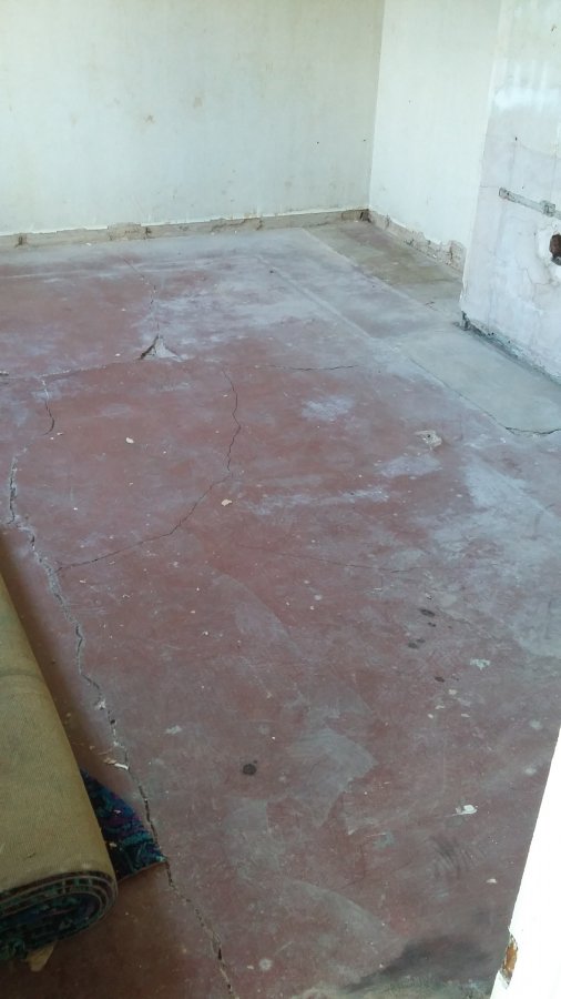

I have what I suspect is a concrete floor that has been affected by colliery waste in the fill material and has suffered sulphate attack. It is extensively cracked and uneven, and where the hearths have been filled in the concrete has risen up by around 15mm.
Is it necessary to have a survey done on this or could I just employ a builder to dig it out and relay it? I have been quoted £1000 approx just for the survey and testing. Clearly the floor needs replacing, but do I need to find out whats in it?
As you can see the house is currently empty and undergoing significant refurbishment. This photo shows the living room but the kitchen and dining area and hallway are also affected to a similar extent.
Why would you need to find out whats happening if you are replacing it anyway?
I guess the only benefit of getting the survey done is that it might not need replacing as such, and may be able to use a self levelling substance. What concerns me is that theres hundreds of these houses in the area and I've not heard sulphate attack mentioned. Though next door have said their floors are in a similar condition to ours.
I may get a local builder in to check it out and see if he knows of any cases locally.
If anyone will know they will. Ive read sulphate attack makes your house unmortgageable but we managed to get one and the valuation survey didnt mention anything.
Surely you need to know whether to repair or replace just the slab, or if the fill below needs replacing too?
And also what has actually caused the slab to heave, and if the cause needs to be rectified too.

You wouldn't just do one room if the whole floor is experiencing sulphate attack.
And you would allow for removal of the fill and contaminated ground down to the foundation level.
