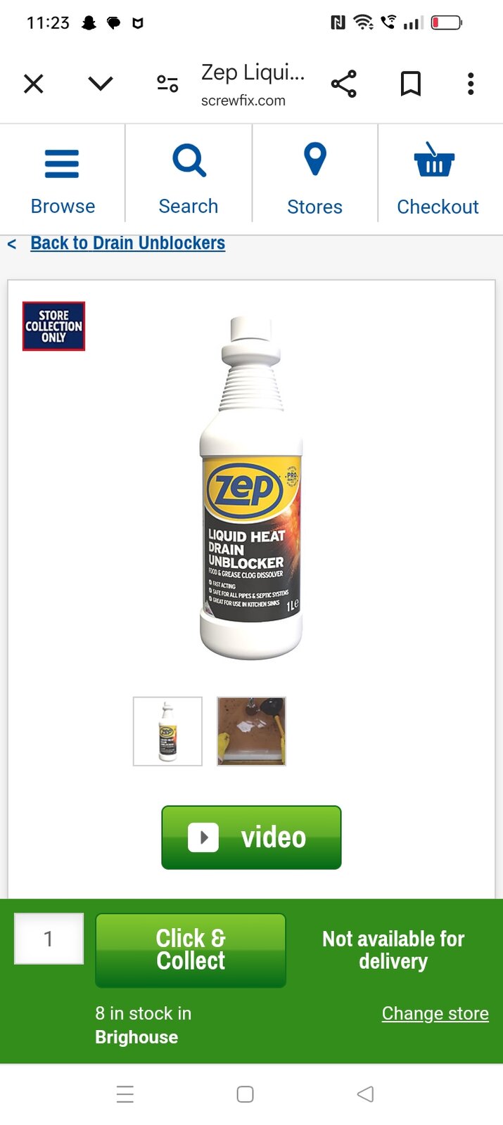

No just some normal drain cleaner has been used previously. Would a plunger have much effect? I imagine it's a build up of grease etc
Is that any good?
