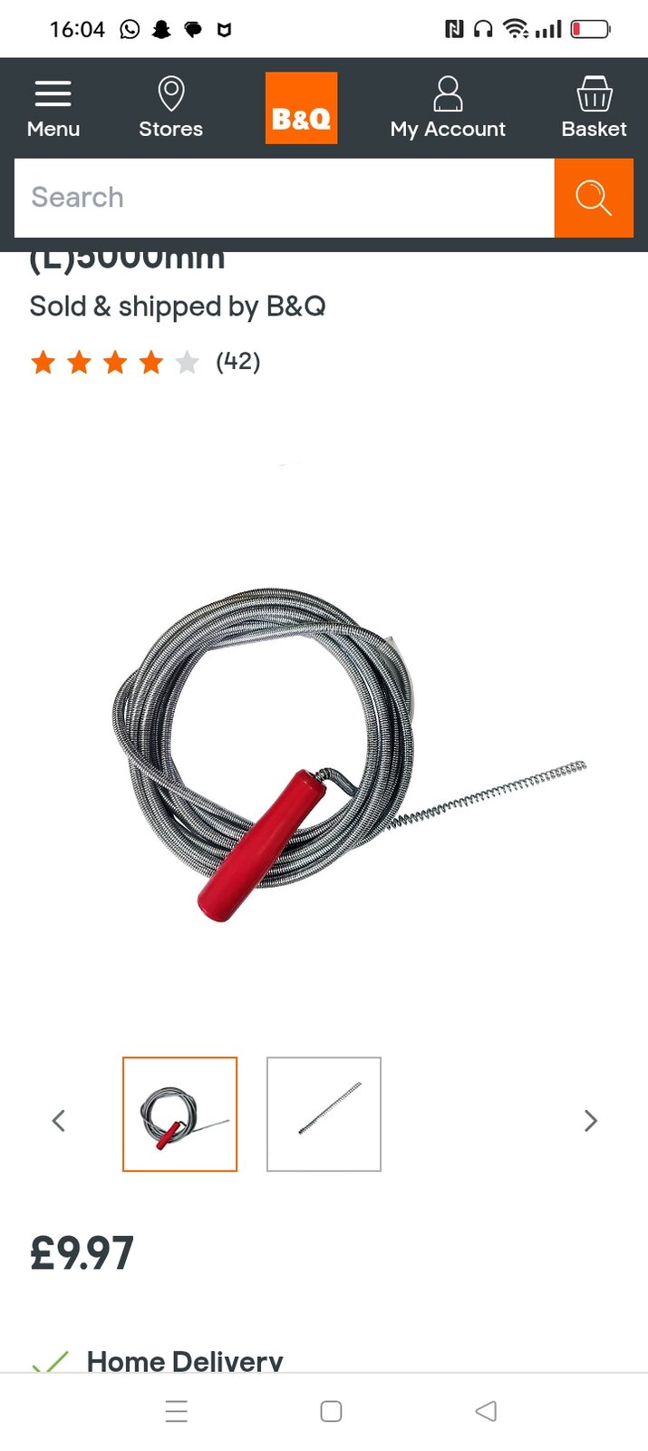

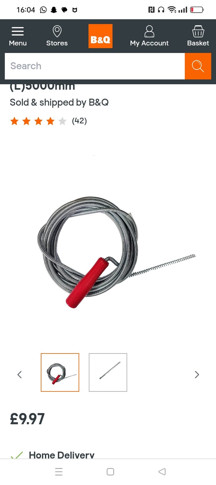

Usually yesWould something like this rod past a knuckle elbow?
Yeah, they can be especially good when it comes to showersHad much success with the vet dry vac method?
They can struggle sometimes with 90deg elbows, more so the further away they are, if that's what you mean. Exactly why swept bends were invented, any hidden waste pipework should always use swept bends to ease rodding, if and when required.Thanks yes. Just never thought of using a wet dry vac. Would something like this rod past a knuckle elbow?
Thanks there is a knuckle elbow just down the line I can see but can't get to. I may have to just go with the plunger. And the wet dry vac on the 40mm pipework. Is a kitchen sink so imagine it's the outside walls of the sink that is gunked up.They can struggle sometimes with 90deg elbows, more so the further away they are, if that's what you mean. Exactly why swept bends were invented, any hidden waste pipework should always use swept bends to ease rodding, if and when required.
