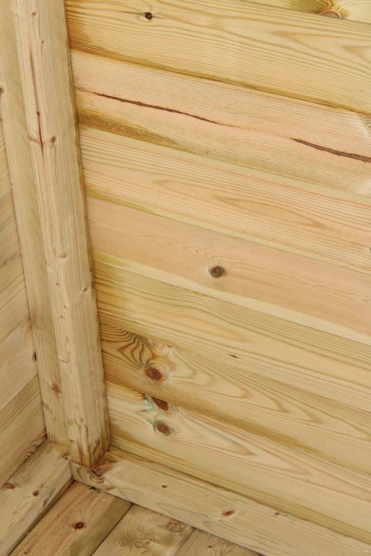

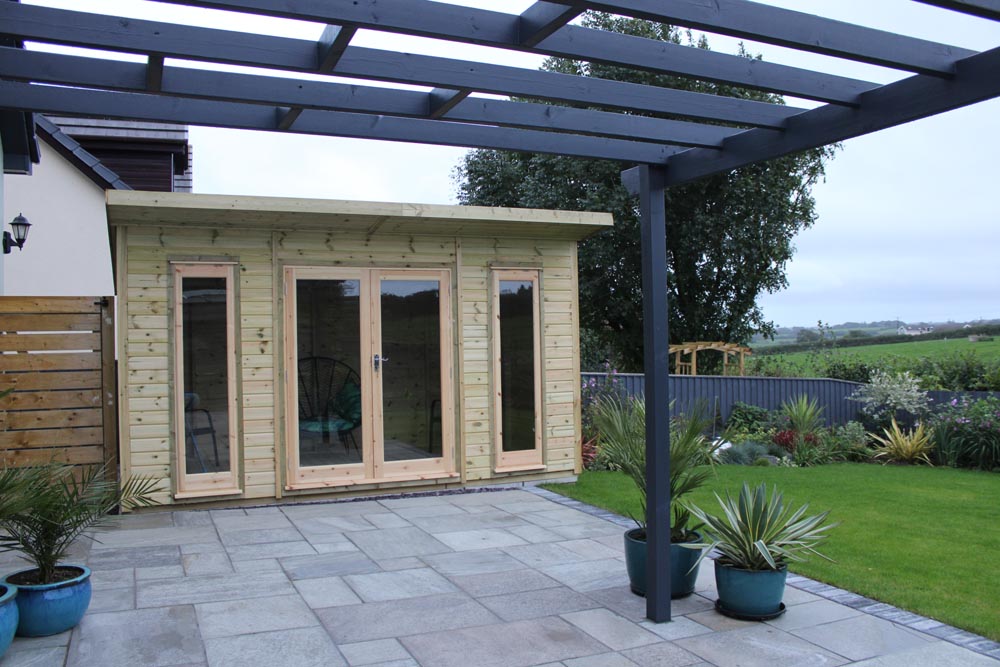

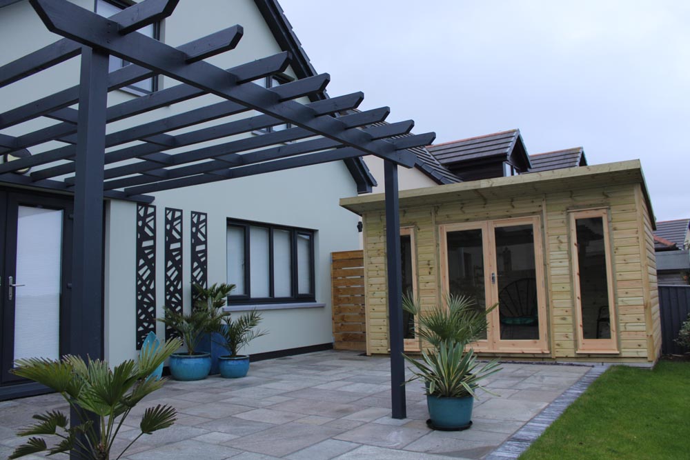

We chose the site because it was the natural spot to place, it was either there or nowhere sort of thing. It's my fault, it's taking quite a battering tonight and I should have had the foresight. It's a typical £2000, 14-ft wood construction. I've uploaded images. Thanks for replying. Any advice would be great because I'm quite concerned after tonight. Thanks.

It looks substantial enough to stand up to fairly tough weather but I agree with scbk, a bit more internal strengthening never goes amiss. I'd also advise waterproofing the outside to help prevent that seeping. Wood will often creak, (it's the nature of the beast as the saying goes), because it expands and contracts with changing temperature and humidity but unless we get a hurricane/tornado I don't see it blowing down any time soon.

ou might not like the look, but some diagonal bracing inside would add strength. Even lining the insides with ply/osb and lots of screws/nails.
