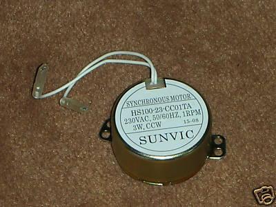

I have a Sunvic SM5203 MoMo 5 wire actuator whis is very noisy.
The noise is the actual synchonous motor.
It is a HS100-06G
Does anybody know where I could obtain a replacement?
I didn't really want to buy a complete actuator but is there another which uses this motor?
Cheers.

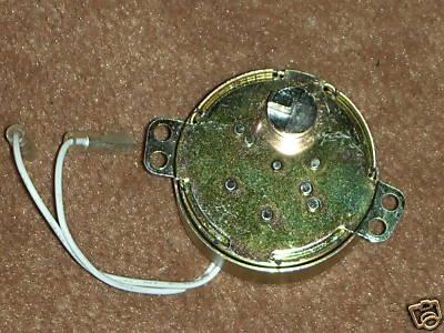

It looks like this one but with a simple brass cog
Ian.
