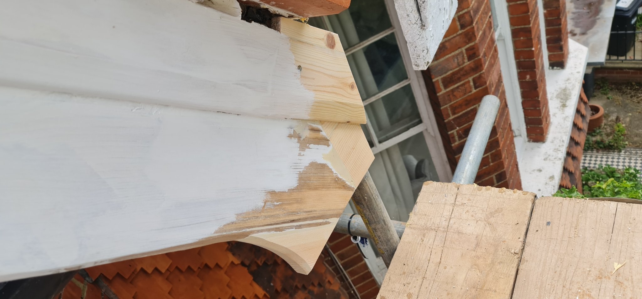

I am currently working on an exterior in Chiswick. The ends of the barge boards required a bit of timber splicing. Naturally, I removed most of the rotten timber but some areas were quite "punky". I didn't have any wood hardener with me, so used a filler knife and super glue. It seems to have worked better than the Tetrosyl wood hardener that I normally use... and the biggest advantage is that I was able to sand the timber flat after 20 minutes. Downside- I ended up with loads on my hands and it costs a lot more (that said, I only used half a bottle).
I will definitely consider using it to deal with interior MDF window boards which have been water damaged in the future- primarily because of the rapid curing time.
When you add baking soda into it, it certainly does create a hard filler that can be sanded down and painted.
I have used this trick and it worked for me.

hard hard hard and no flex so expansion and contraction may in time cause cracking in the finish it could possibly also start to delaminate the glue "patch" from the soft material at the point the glue finishes and untouched wood starts

I think I've seen all the tiktok and insta videos of this wonder-product use of CA glue and bicarb and cotton wool.
As big-all says, it's very rigid, so the longer term use in timber and flexible plastic is questionable. But admittedly all the repairs look lovely in a 30 second video.
As a hardener, I'm not sure that CA is thin enough to soak into the wood fibres, and therefore may effectively act like a varnish and stay on the peripherals - which makes a delamination risk over time greater.
Having said that, if you are aware of the limitations and risk, then it may well be appropriate for some uses. Internal on a relatively stable material like MDF in dry conditions comes to mind.

Delamination? I was applying epoxy resin filler over the top and then painting it. I don't see why the other proprietary wood hardeners would be any different. I used to use the Timberbuild 2 part epoxy wood hardener, but found it would stay sticky over pre-existing paint (for days). @jobandknock recommended the Tetrosyl cellulose based stuff. It works, but doesn't seem to penetrate as deep.
Thanks for the heads up. I will keep an eye on it though.
I had recently seen videos where people turning wood on lathes used super glue to harden timber.
I thought I would give it a try.

Is the above not spliced? Square edge cuts glued with a dedicated "1" hour epoxy resin. No screws used.
Along the length of both barge boards there where numerous 0.2 to 0.5mm shallow cracks. I enlarged the cracks, used the super glue (as a wood hardener) and then used the semi- flexible "1" hour epoxy resin.
I could have used the 2 part wood hardener recommended by the manufacturer, but I have found that it is great on unpainted timber but stays sticky where it meets painted finishes for ages. The timber above and below was "punky" (read: fiberous). It wasn't rotted.

On reflection, yes, punky often seems to mean spongy (especially in the US). I was taught that it can refer to timber or MDF where, after water damage, the surface fibres stand up. Fibres aside, I could not push my fingernail into the timber and knew the builder would accuse me of taking the pee if I insisted that the entirety of the barge boards were replaced. The superglue hardened the timber enough for me to sand it (the fibres) smooth.
