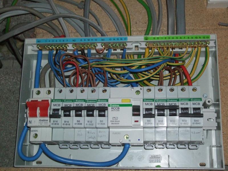

If you post some pictures of your consumer unit, meter, main service fuse and then a wide shot of the whole area then I'm sure someone will be able to tell you everything you need to know.
Right then Iv got some photos of the cons unit and ensuite.
Its got as davey mentioned 100mA RCD one side and 30mA RCD on the other. Im assuming I need supp bonding?
If so do I just run a contin 4mm cable from light to sink pipes to rad pipes and then a cable from shower earth to rad pipe.(rad connection will be next door in airing cupboard)?
Cheers for any comments.
If you click on my name you should be able to see photos I hope!
You only have 1 x RCD, the other unit is the main isolation on / off switch for the CU.
Does the 6a circuit to the RHS of the RCD (centre) work the bathroom lights ?
If not the supp bonding will be required
Actually it looks as if the 6A is a spare, because I can't see any wiring for it.
You could :LOL: move the light circuit on to the 6A MCD on the RCD side and then both shower and bathroom lights would be on an RCD controlled circuit and thus no bonding required.

Make sure the neutral is moved to the RCD neutral bar otherwise you could experience the phantom of the RCD trip :D
