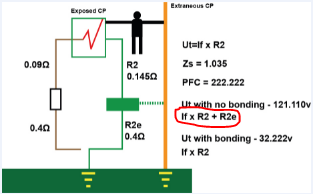

OK. This is a simplified version
So with bonding we have a touch voltage below 50V.
This is because we are not using the external R2 in out calculations.
Why the external R2 is left out confuses me, but I think this is why...
So we are not talking about EFLI and low impedances here, i.e getting a low resistance path to enable the OPD to operate in the correct time.
This is about trying to prevent as much as possible different potentials.
So the voltage on the Extraneous CP would be considered at earth potential (0V)
If a fault were to put a voltage on the Exposed CP . You would have a large PD between the two.
Now we have not connected that Extraneous CP to make it a more conductive path to clear a fault.
We have connected it because we want to try and equalise the difference between the Exposed CP and the Extraneous CP.
So a proportion of the fault current at the Exposed CP will ( resistance depending) appear at the MET.
Which will pass that voltage on to the Extraneous CP.
This will mean that the the Exposed and the Extraneous CP, although at a different potential,
that potential difference is not so large, and shock risk is reduced.
What I still need to clear in my mind is what is the Voltage at the fault.
This is again what I think is happening..
The voltage 'left' after passing through R1e and R1 ( I work out at 121.12v) appears on the Exposed CP
The voltage on R2 appears ( again resistance depending ) on the MET but it has it has dropped another 32.22v
putting 88.88v onto the MET, and Extraneous CP.
This rises the voltage on the Extraneous CP to 88v.
The potential difference is the 121.12v minus the 88.88v which works out at 32.222v

OK. This is a simplified version .... So with bonding we have a touch voltage below 50V.
Indeed - as I predicted :-)
This is because we are not using the external R2 in out calculations. Why the external R2 is left out confuses me ...
I don't understand what you mean. Are you referring to the 'earth side' of the Ze, what you called R2e in previous diagrams? If so, then you are "using" that in your calculations, since it is part of the total loop impedance which determines the fault current - and, in turn, that fault current multiplied by the R2 (within the final circuit) gives the 'touch voltage'.
... So we are not talking about EFLI and low impedances here, i.e getting a low resistance path to enable the OPD to operate in the correct time. This is about trying to prevent as much as possible different potentials.
Indeed so - that's why, in terms of terminology, it is bonding, not 'earthing'.
As for the rest of what you write,I think you are probably making things unnecessarily complicated. It's really very simple, and I will try to help you a best as I can! ....
That would be true without bonding. With bonding, the potential of the Extraneous-c-p is not at earth potential but, rather, is raised to the potential of the MET (which will be considerably above earth potential during the fault). The potential difference between extraneous- and exposed-cps during the fault (i.e. the 'touch voltage') is therefore a lot lower than it would be if the extraneous-c-p were at earth potential (i.e. without bonding).
Now we have not connected that Extraneous CP to make it a more conductive path to clear a fault. We have connected it because we want to try and equalise the difference between the Exposed CP and the Extraneous CP.
As above, agreed - which is why we are talking about bonding, not 'earthing'.
So a proportion of the fault current at the Exposed CP will ( resistance depending) appear at the MET. Which will pass that voltage on to the Extraneous CP.
I'm not sure what you are saying here. Unless the impedance to earth of the extraneous-c-p is very low (in comparison with R2+R2e), nearly all of the fault current will flow through R2+R2e, via the MET (and relatively little will flow through the extraneous-c-p)
That is, indeed, the whole point of the bonding.
What I still need to clear in my mind is what is the Voltage at the fault. ... This is again what I think is happening.. The voltage 'left' after passing through R1e and R1 ( I work out at 121.12v) appears on the Exposed CP
Exactly - it's as simple as that. The potential of the exposed-c-p (relative to earth) will simply be the potential at the transformer (relative to earth) MINUS the voltage drop through R1+R1e.
With bonding present, the extraneous-c-p will be at MET potential, so the 'touch voltage' will simply be the difference between the potential (relative to earth) at the exposed-c-p (as above) MINUS the potential of the MET (relative to earth).
It really is pretty simple!

John: Is this what is confusing Studentspark - or am I the confused one?
In this scenario:
Isn't the situation without bonding that the 121.11V is the product of 230x0.545/1.035 (rather than 222.22x0.545) with the person merely receiving a shock of 121.11V while providing a path to earth via the extr-c-p and not actually dependent on the fault current?
This would be similar to the person simply touching the expo-c-p while standing on a well earthed floor.
That the product (121.11) is the same as 222.22x0.545 being an inevitable coincidence of the arithmetic.
Whereas with bonding the person is only subject to the voltage drop of 32.22V between expo-c-p and MET because of the current and impedance between them (222.22x0.145) - the extr-c-p and bond merely being (regarded as) a negligible impedance method of touching the MET.
John: Is this what is confusing Studentspark - or am I the confused one? ... In this scenario:
... Isn't the situation without bonding that the 121.11V is the product of 230x0.545/1.035 ....
Indeed so, but ...
... (rather than 222.22x0.545) ....
I'm not sure what you mesn by "rather than" since, as you go on to admit, it's exactly the same. Below you call it an "inevitable consequence", but it's really just a matter of very simple arithmetic - nothing to do with 'coincidences'! There are several ways one can look at it (and get the same answer) but probably the simplest is...
as you say ... touch voltage = voltage across (R2+R2e) = fault current x (R2+R2e) = fault current x 0.545 ....equation 1
However, fault current = 230 / (R2+R2e+R1+R1e) = 230 / 1.035 = 222.22 V
Hence, putting that value for fault current into equation 1, you get ....
touch voltage = 222.22 x 0.545
... so, the two things are identical not due to any 'coincidence' but because of very simple arithmetic.
... with the person merely receiving a shock of 121.11V while providing a path to earth via the extr-c-p and not actually dependent on the fault current?
I don't understand what you are suggesting. The magnitude of the shock is totally dependent upon the fault current [since its magnitude is fault current multiplied by (R2+Re)]. Edit: for example, if If were to change, due to a change in R1 and/or R1e, then the touch voltage would become something other than ~121 V.
Well yes, of course, since in the absence of bonding there's no difference between an extraneous-c-p and a 'well-earthed floor' In fact, strictly speaking, I suppose that a 'well-earthed floor' actually IS an 'extraneous-c-p',
As above, it is, indeed, inevitably the same - but as a consequence of simple (Ohms Law-based) arithmetic, not any 'coincidence'.
Quite so. Are you implying that anyone has suggested otherwise?
Perhaps the simplest way of thinking about is is probably that without bonding, the touch voltage is If x (R2+R2e), whereas with bonding it is just If x R2 - since, in the latter case (with bonding), the potential of the extraneous-c-p is essentially that of the MET (regardless of what potential that may be above true earth, which is determined by If flowing through R2e).
