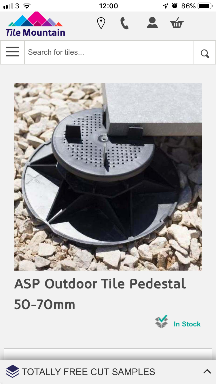

Hi, guys.
Has anyone got any experience or thoughts on suspended patio kits?
I came across these while searching for patio slabs. They’re supposed to hold up to 400kg per unit and can support any size tiles/slabs over 15mm thick.
It allows slabs to be jacked level with water draining between the gaps.
The issues I can see are:
1) The void underneath would be a haven for weeds/ants/rats etc.
2) I wouldn’t be able to build any permanent fixtures on top (brick bbq/wooden gazebo etc)
3) Any variation in slab sizes would be a problem with levelling/inconsistent gap lines
They sound like a good idea in theory but I’m not sure they would work in practice!
Any thoughts would be appreciated.
The photo shows the pedestal on hardcore and the info says you can use them for patios.
I’m interested if anyone’s got any arguments for or against them.
Cheers

You need to understand that hardcore will move, and normally it's evenly loaded and evenly drained, but with these things you are point loading it with the associated localised wetting which makes things even worse.
And if you think that you can get a hardcore surface to the precise levels and falls for these things, then you need to pack up your job and start earning thousands doing this for groundwork contractors.
There is absolutely no reason and no benefit to using these on a patio. They are a solution for a different problem, but if perceived speed for an afternoon is the most important criteria, then yes go for it.

I saw those yesterday in b and q next to the decking version of the same thing. I was also interested in why you'd use them over a weak mortar mix. I assumed it was something to do with drainage or ventilation.

There's also the matter of what would happen to the tiles when you put point loads on the middle of them
