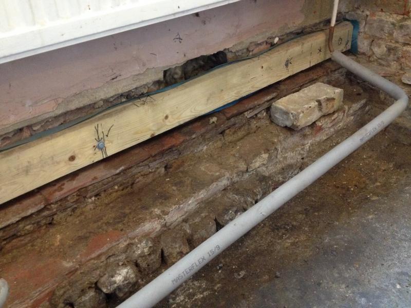

Here are the reference pics...
(The pictures are showing the SAME wall btw)
[/img] View media item 80626 View media item 80627

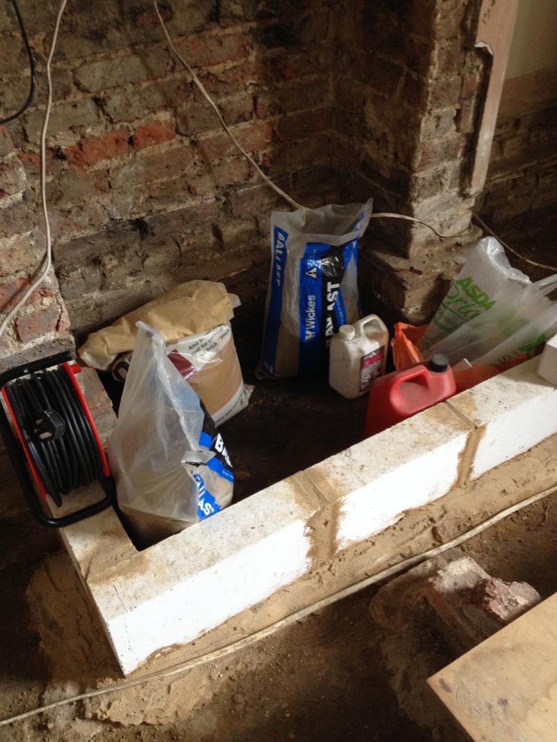

My queries:

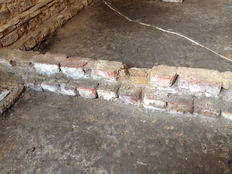

Is it a good idea to lay a concrete oversite? What you are looking at is earth, which has dried over a year but remains damp.
If over-site is a good idea, what should be the construction? Blinding, dpm, concrete thickness etc?
The next question:
There is a brick shelf wall either end of the room, with a sleeper wall in the centre. The finished joist ht is shown by the timber plate I have bolted to the wall. The new joists will be layed onto the brick shelves and the centre sleeper wall. I have the option of laying the joists onto a new row of brick,mortar then dpm over...then fine tune joist heights with slate...Or to lay a timber wall plate to each (Mortar,dpm,mortar,wall plate).
In other words...what is the purpose of timber wall plates in this situation please, will it help me?...as compared to laying the joists onto a new layer of bricks with no timber wall plate.
(The timber wall plate shown bolted to the wall...WAS plan A. I was going to use joist hangers nailed to this wall plate...but thinking it through, I am a little concerned that the bolts in the wall will rust away and so compromise the whole floor...so have gone back to the idea of using the original shelf walls as originally used! As I have both wall plates fixed to the walls at either end of the room, at the correct height, they will now act as my 'end noggins', but with the main floor weight taken by the shelf walls)

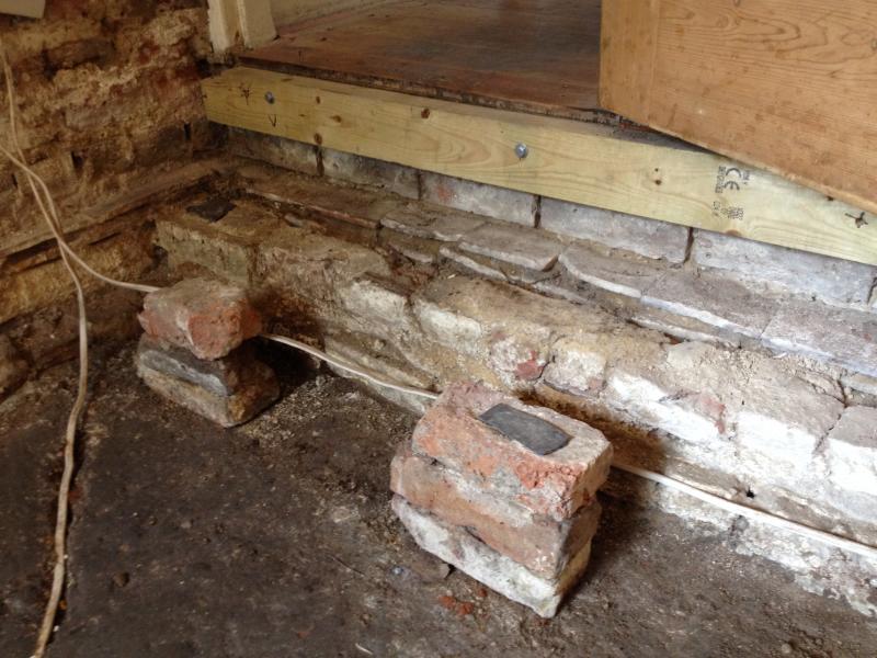

If the bolts are well secure (ie. in solid brickwork with no damp present) then why not use the "wall plates" with hangers?
The knee wall can be rebuilt and honeycombed for ventilation and the oversite covered with a membrane moisture barrier.

REE: If the bolts are well secure (ie. in solid brickwork with no damp present) then why not use the "wall plates" with hangers?
ME: The bolts are well secured now...but the walls are damp, especially the external wall. Hence my concerns with the bolts rusting. As a guess...I have a feeling that if I did use this Plan A...it would probably be fine...but I would always be concerned with those bolts rusting.
REE: The knee wall can be rebuilt and honeycombed for ventilation and the oversite covered with a membrane moisture barrier.
ME: The walls are ok. Even though layed directly to earth and with Lime mortar. I am thinking of just adding either an extra row of bricks (or wallplate) and that should do the job. As you say, I was going to remove a few bricks in the middle sleeper wall to maintain the airflow as I am thinking of insulating the floor with Celotex between the joists. The new joists are only 4 x 2, but with the span to the central sleeper wall only 1.8m, the charts show them well within requirements. Fitted at 400 centres.

ree said:
Filling with hardcore and concrete is typically cheaper than a suspended floor but it carries further difficulties such as running pipes and cables, and through ventilation etc.
Wasn't thinking of putting in a solid concrete floor as I have read that it MAY cause more problems with damp on the walls (tho I do wonder..won't the dpm wrapped up the wall stop moisture exchange into the wall). Additionally the problems you mention went through my mind, So at the moment I am looking at suspended timber floor method.
I did say bolts...but in fact I did not use bolts! They are in fact Coach Screws, 100 x 8mm with matching 60mm plastic plugs. The wall plate is 45mm thick, so the screw 50mm in the wall allowing for brick irregularities. There IS damp present...according to my mates damp meter...(we won't go into that discussion at the moment!). So I am concerned about any hint of damp compromising the screws..
I am a novice, but I reckon I probably am capable of re-building the centre wall on a strip foundation. I called it a sleeper wall, don't know if that's correct as you call it a 'Knee' wall. At the moment it's loosely held together by lime mortar all direct to the earth. Honeycombe construction I understand...for the air to flow through.
Are you suggesting covering the earth with a DPM Ree and leave it at that...no concrete over. I assume that will aid to keep moisture down at ground level?

Do section sketches (full size on a piece of ply or plaster board) of the wall plate to FFL, and perhaps a sketch of the sleeper wall to FFL. This way you are in control of your dimensions.

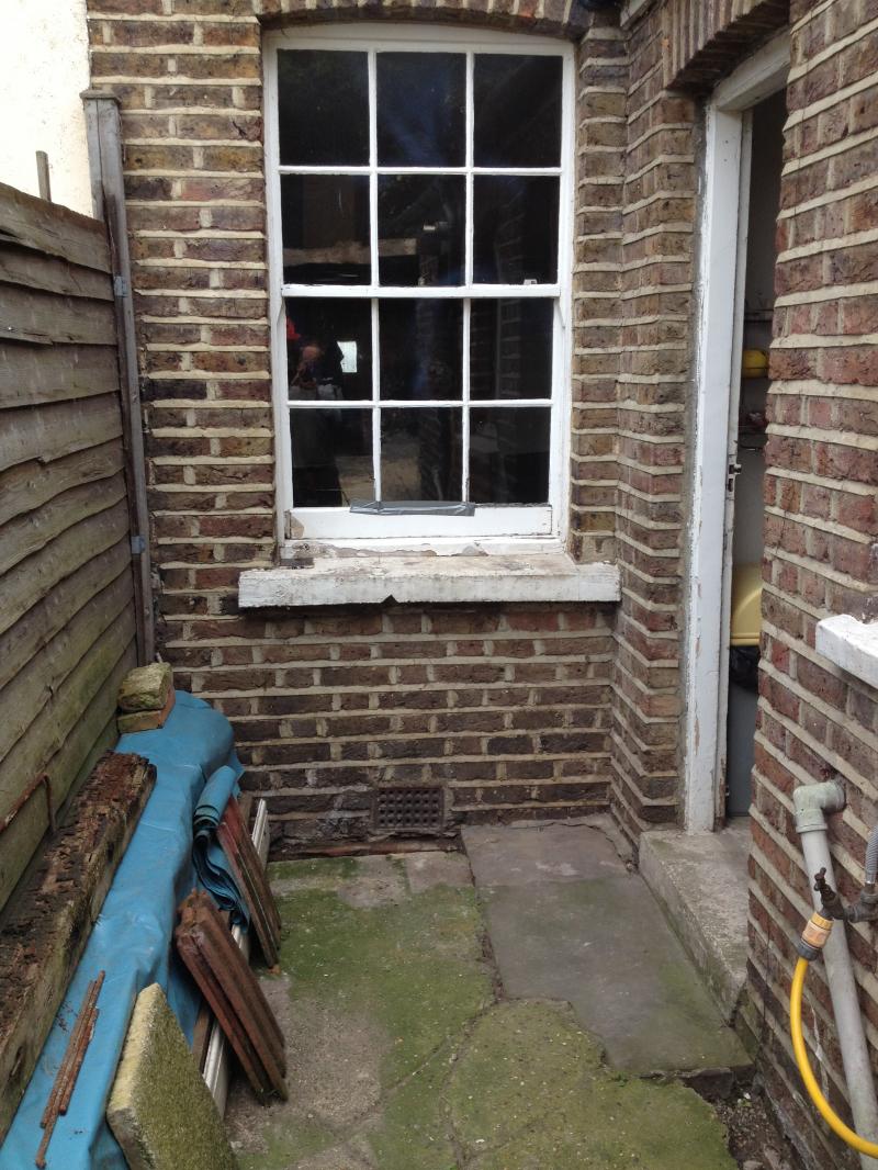

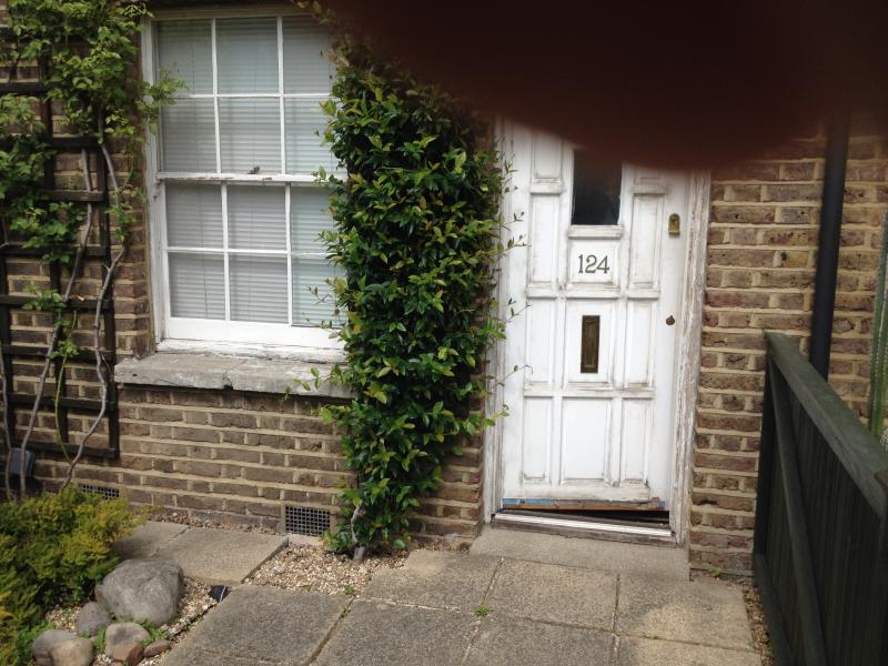

Air flow from front to back is necessary - use 10" x 6" plastic air bricks. Is the hall subarea ventilated? Pics of backyard view below the dining room window, and front elevation at ground level would help.
Yes, simply drop a membrane down and lap it up the walls a little.

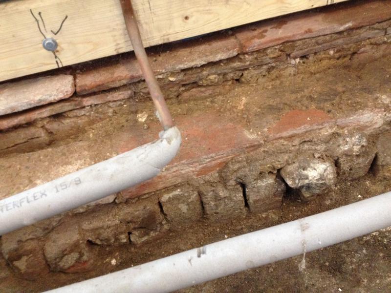

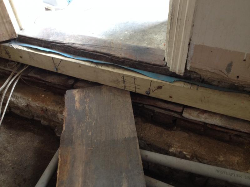

Why not slip a DPC behind the wall plate - loosen off the screws. Every third joist could be lightly packed on the "ledge" with a brick and slate. Just for insurance.
Re-arrange any pipework or cables now. Everything to be securely clipped.

I am grateful for your help Ree. I realize I have given vague info, which must make it difficult to visualize. I will draw a floor plan and couple of photo's to better show the scenario. It's a small house and not a difficult job...but as a novice it's all new stuff for me to learn. I appreciate the advice. I'll be back soon.
As Ree suggested, slacken the bolts and slip a piece of DPC behind the plate, cut slots for the bolts in the PCB so that it slides all the way down. The slots will make little difference but if you are concerned pour some liquid DPC down the wall. If its not an excessive amount of work you could replace the bolts with stainless steel to avoid the possibility of rust. Also I would not bother with over site concrete, it will serve no purpose and if you have an under floor water leak it will soak away. What's with those pipes? the right angle bends look to be just bent!!
Pics uploaded. Air flow is minimal to non existent at the moment, exacerbated further by only one air brick to the rear. If you refer to my plan you can see my proposed new air brick, maybe with some concertina duct tube to get air to that side of room? Getting through the hall/stairs walls can be done tho. I will put 2 or 3 clear gaps through there.
I see you both make same suggestion..thanks! Wasn't looking forward to mixing that amount of concrete!
Knew all about the DPM's to the plates...BUT completely forgot to fit them! So I actually un bolted completely one plate, took it off and fitted DPM and re fitted plate. Heart in mouth tightning bolts again...didn't want a loose spinner! All good tho, tightened up nicely. Same to do to other, if I follow your advice about using both methods of support..ie, plate and wall. With the wall taking the weight off the wall fixings. My neighbour (who does lots of work on his rental houses) suggested the same.
Does your water service enter the house in plastic?
Ok.
Water enters in......wait for it......Lead. Then onto copper at the entry point.

Consider where to locate your access trap for the crawl space.
You might now see from the photos...the gap below the bottom of the joists to the earth will be apprx. 8-10"...so no access required!
Thanks for your advice Maltaron, most useful. See my reply to Ree about the DPM behind the wall plates! I will check and see if my Coach screws, not bolts, are stainless or not and maybe change them. I also have some of those expanding bolts that I might try to fit as a bit more insurance. They're the type you can fit without taking the wall plate off the wall, you just drill straight through the timber and into the wall..I forget what they're called. Re the pipes...actually it's just the photo. The Insulation is a bit twisted, but the copper under is a proper rt. angle joint. If you look at my reply to Ree, you will find further info and photos.

Your bolts and plugs are fine, leave them alone.
The wall plates could be notched at air brick positions to allow full ventilation thro.
The DPC double coursed tiles should run to the exterior brick face - your ground surface should be just below that level. At the moment they appear to be bridged at the front and rear elev's.
There was originally, probably an air brick below the front door threshold venting the hallway.
No concertina tubing - simply honeycomb, even half bricks.
