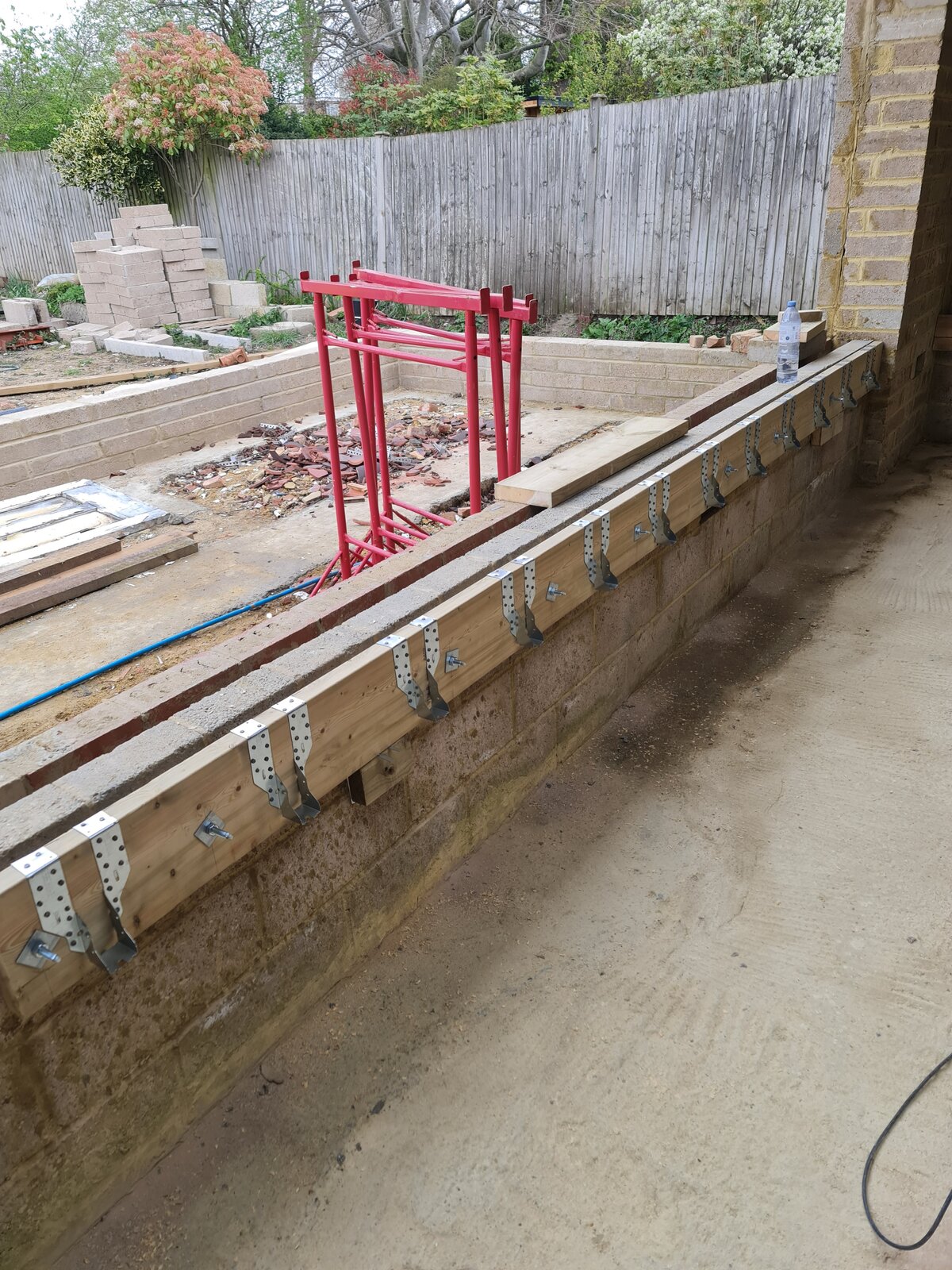

If it hasn't been pointed out, joist hangers should be nailed, not screwed, using sherardised twist nails. Every hole must be filled. I was taught never to cut hangers unless completely unavoidable - just wrap over and nail on
The best way to deal with ledgers (referred to as bearers/wall plates here) I've found is to mark off from the end and pre-fix all the joist hangers to the ledgers, using an offcut of joist to get your alignment, bevfore fixing to the wall. If the wall they are fixed to is external they ideally should be pressure treated timber with a layer of DPM behind them for additional protection.
If the masonry you are fixing the ledgers to is ropey, use resin anchors instead of Rawlbolts
It is often easier to temporarily fix a piece of 3 x 2 CLS to the wall with brown plugs and 5 x 90mm (or so) screws (2 to 4 no) and get that levelled up, then use that to support the ledger, rather than trying to get the ledger on the wall without any aids. The CLS is pulled off after the resin has set or the Rawlbolts have been tightened

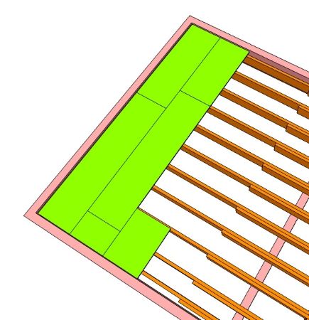

Note where I have put the solid strutting, as suggested above, but only one row as there is no need for any more, and why do more work than you need to? At the other wall end you need to ensure that your last joist is 50 to 70mm off the masonry. It doesn't matter if it is only 200mm spaced off the previous joist, so long as the joist spacing doesn't exceed 400mm/16in (depending on what you sub flooring you are using).
The sub floor goes on on brick pattern or hit and miss (there is a 10mm gap all round on this floor):
If you start with a full sheet, and the next one is a part sheet, try to trim and use the offcut to start the next row. Also, make sure that you aren't going to end up with a stupidly narrow strip at the end - measure the room before starting and if you end up with a 50mm rip, try to start by taking, say, 100mm off the leading edge of the first row so you get at least a 150mm final strip

Sherardised twist nails have good pull out resistance and are far less likely to shear under shock loading than screws (e.g if somebody drops a heavy item of furniture on its' corner on a floor). So by using screws you are reducing the shear strength of the floor structure. BTW BCOs will generally pull screw fixings of joist hangers if they see them

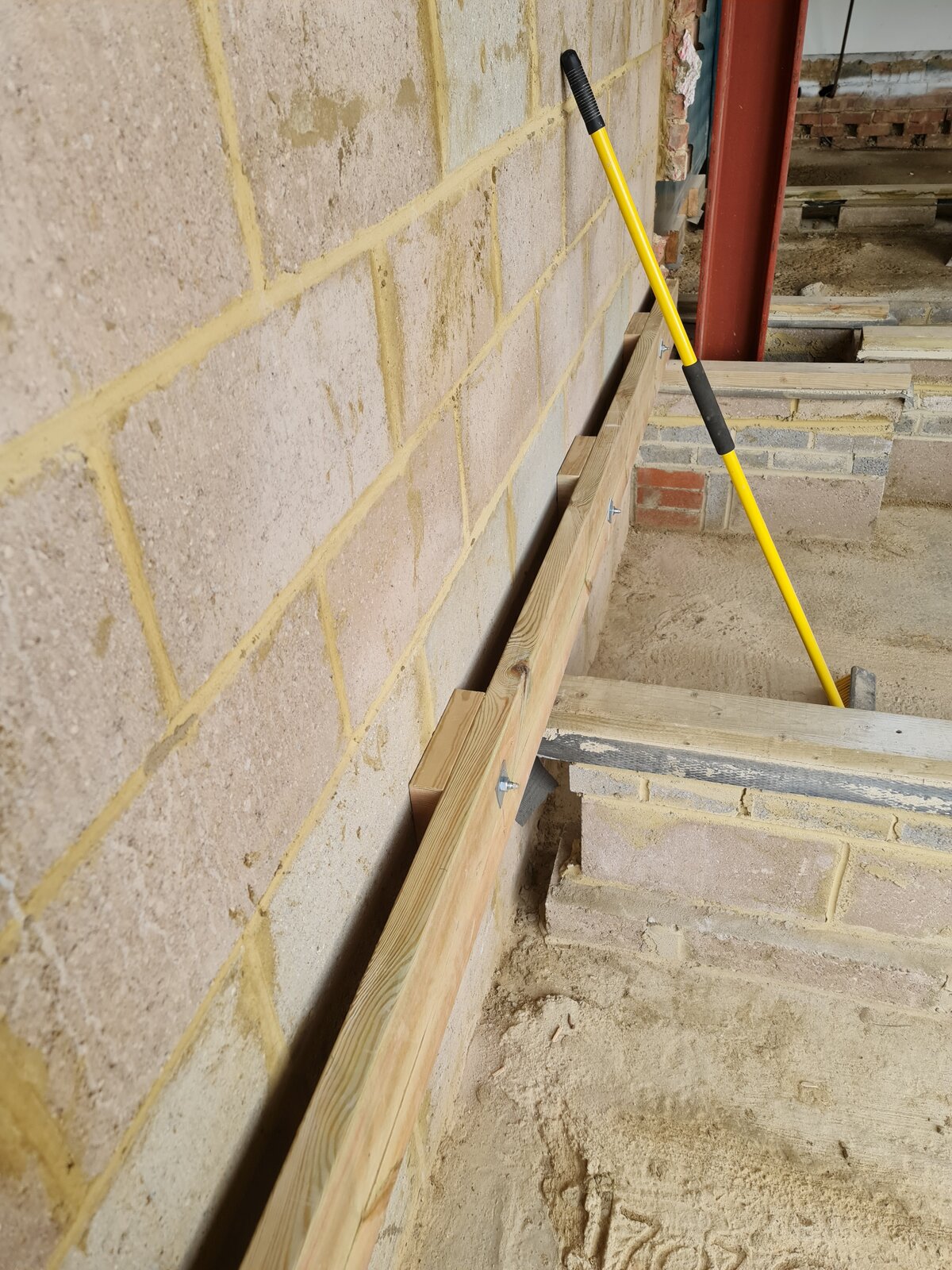

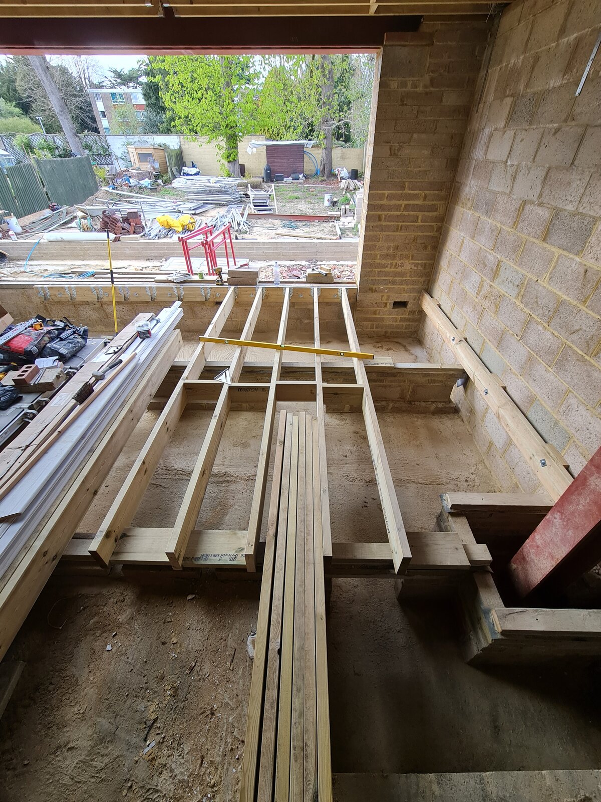

Tha ks for all the help today. Day 1 is over and I THINK i have it off to a good start other than 1 mistake. Spent a lot of time measuring setting out and cutting material but it then made actually installing the joists very simple.
Is there anything from the below that looks wrong before I carry on?
Also what sort of tollerence should be expected. The engineers laser is showing approximately 2mm over the section laid so far.
The mistake I made was I didn't back the ledger board with DPM. I have so much dpm in the house I can't believe I have missed this! It is treated timber fixed back to a cavity wall with approximately 500mm or more of free ventilation below and arround it. I know this should have been installed but given where I am now how much of a risk is it to leave as it is?

I'm a little mystified about the joist you have fixed to the RH side wall and how you intend to infill the area between that and the first installed joist (dwg to follow - it's late, it's been a long day, and I'll be fresher in the morning)
2mm is neither here nor there - you won't notice it. Lasers are NOT perfect and you won't notice 2mm as you wal across the floor (10mm and you may well). What is more important is to sight down each joist before installing it so that you know if it is crowned or not (i.e. bowed allong its' length in the vertical orientation). Joists should always be installed crown uppermost as the crown will flatten out when the sub-floor goes on and the floor is loaded, however, there is a limit to how much crown is acceptable (to my mind about 4mm). Joists which are too crowned should be cut and used for shorter joists, solid strutting, etc where cutting to a shorter length makes optimum use of the timber
The DPM together with treated timber is really just belt and braces. You have treated timber, so I wouldn't worry about it too much
Glad to see that you've put a DPM beneath the bearer atop the pygymy wall _ I missed that point. The joists can be toe nailed (skew nailed) to the bearer for stability
As another aside, I tend to use another physical check as I go - I set a 6ft level across the tops of several joists to gauge any crown (or dip) there might be at various random points. In the days before we had 6ft levels we used to take a piece of straight planed timber (or even straight CLS - checked by eyeballing it) and tape a shorter level , often a 3ft or 1m level, to the top of it. The straight edge helps you verify that adjacent joists are more or less level
Thanks for the help JAK. It's much appreciated.
On your points. Good to hear you dont see the lack of dpm to the ledger as being a major issue. Dpm has been installed bellow all "wall plates" to the dwarf support walls.
The area to the right will have 2 more joists installed with a 1200 ledger plate to the external wall. These 2 sit arround a steel so needed to be cut and I ran out of time.
I have been using the rotary laser together with a 6ft level and all seems good. The bubble sits nicely between the lines in all areas.
