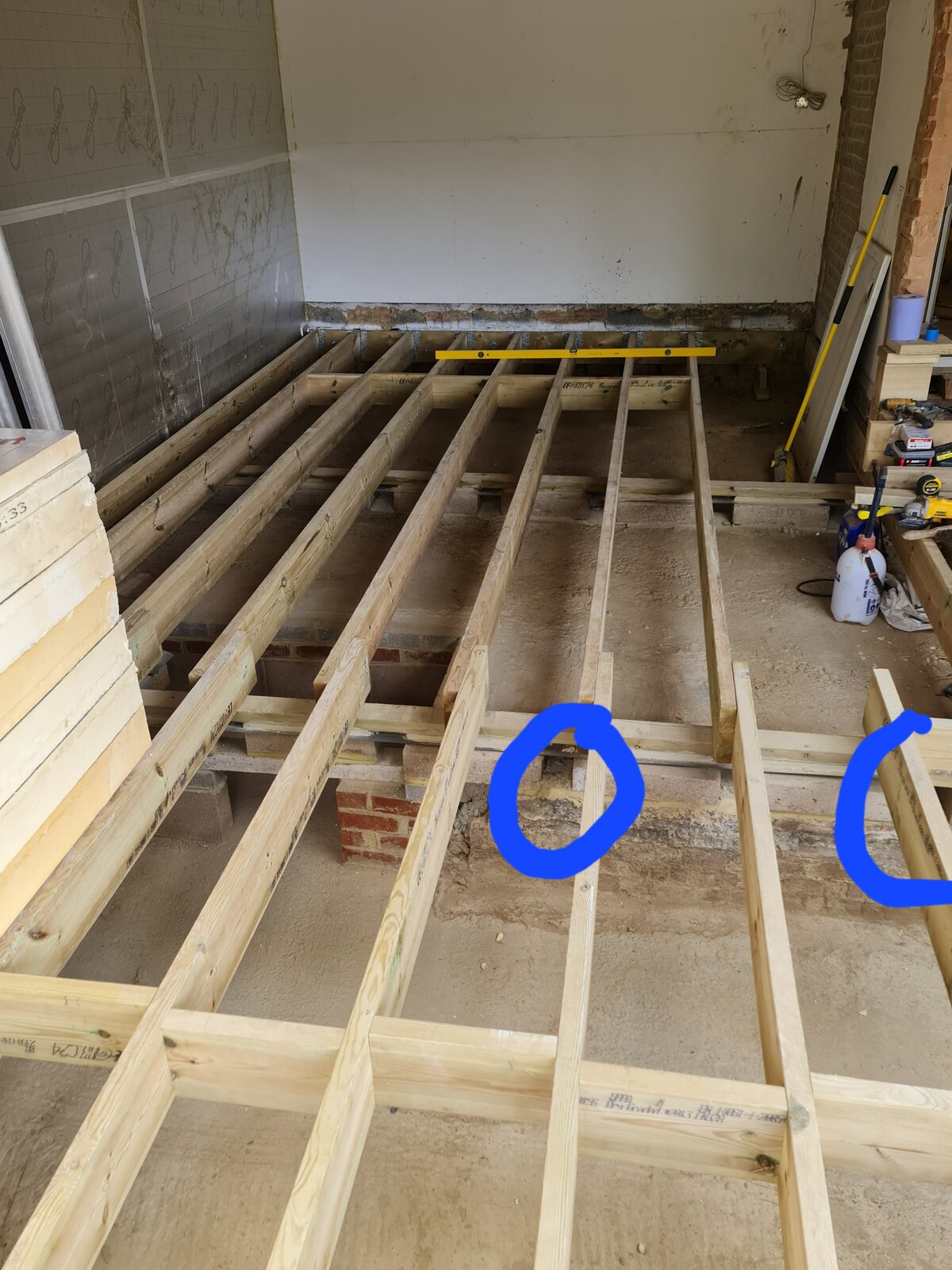

Infilled the right hand side as below.
How tight should the bolts be into the chem fixing? They have been done up tight but could be cranked a little further. Guessing when it's all fixed together the bolts don't actually add much to the party in terms of pulling off the wall?

Thanks. 14 along the rear wall from memory. I think only 1 has failed. Its in new blockwork so seems to have worked a treat. When I tighten the following day how mad should I go on the wrench? Tight then another full turn?
1 fail is well within the bounds, especially as you seem to have put them in on fairly close centres.
Hand tight plus one turn should do the trick.

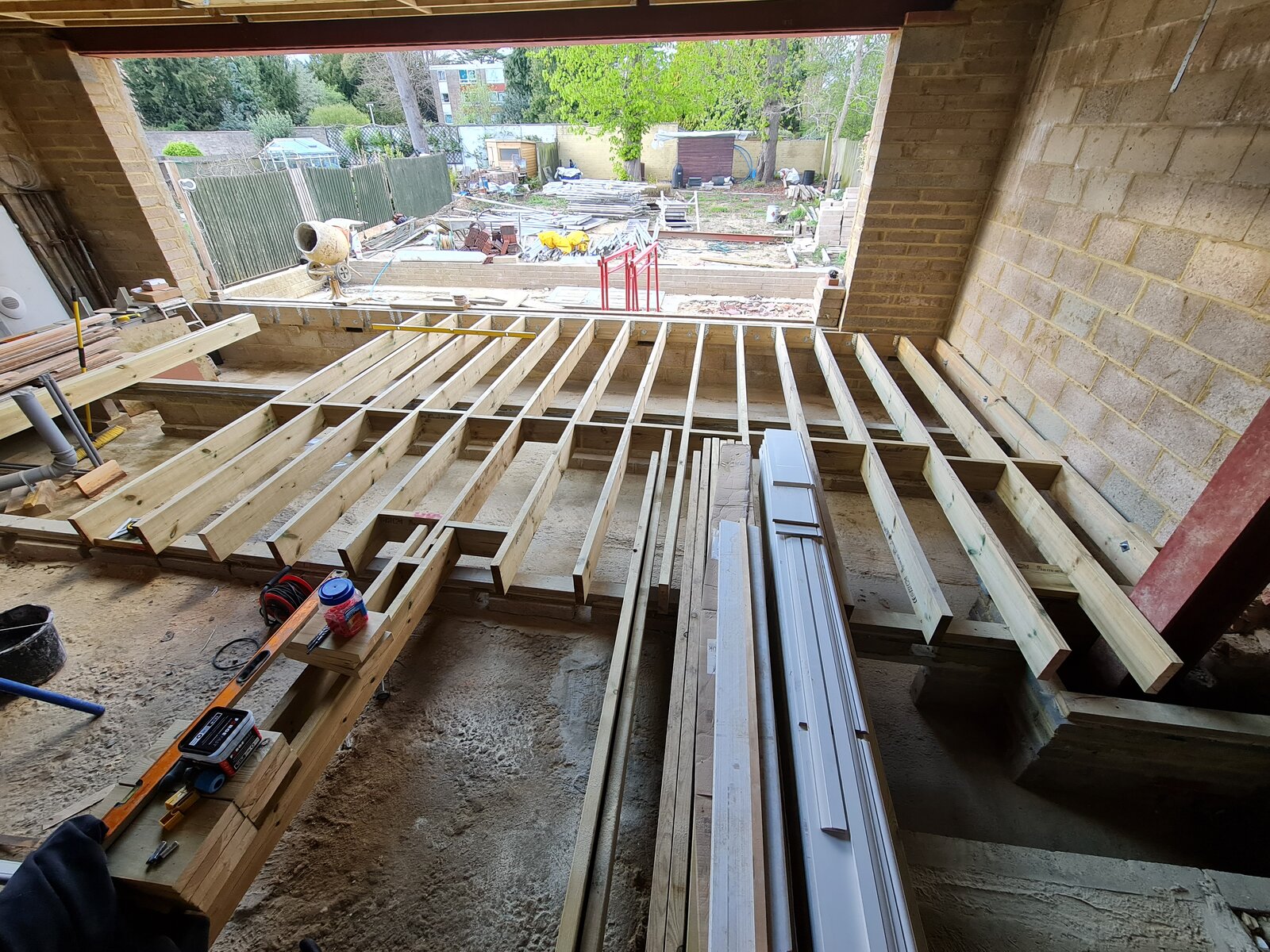

I have an internal wall I need to hang joists from. Does the ledger board need to be fixed right back to this wall or can it be set off the wall using timber packers behind each bolt point to allow services to pass through?
If a joist is sitting slightly low at the hanger end is it OK to sit some steel shims in the base of the hanger to sit the joist up?
Ideally fix directly to the wall and make as long as possible. For internal walls your ledger doesn't need to be treated timber, but if the ledger is below ground level a DPM behind it is still a good idea. There is no reason why you can't notch over wiring, CH pipework, etc
It isn't ideal and generally isn't acceptable to the BCO (although they will normally accept small notches), but so long as you drill and countersink it and screw it to the underside of the joist (so that it can't ever drop or be pushed out) I can't see the problem

Is there an easy way or removing the nails? If so I can remove the 2 hangers raise up and re fix. I had mechanically fixed the shims so they could never move but if it is a risk for the sake of 2 hangers it may be best to remove and replace? What do you think

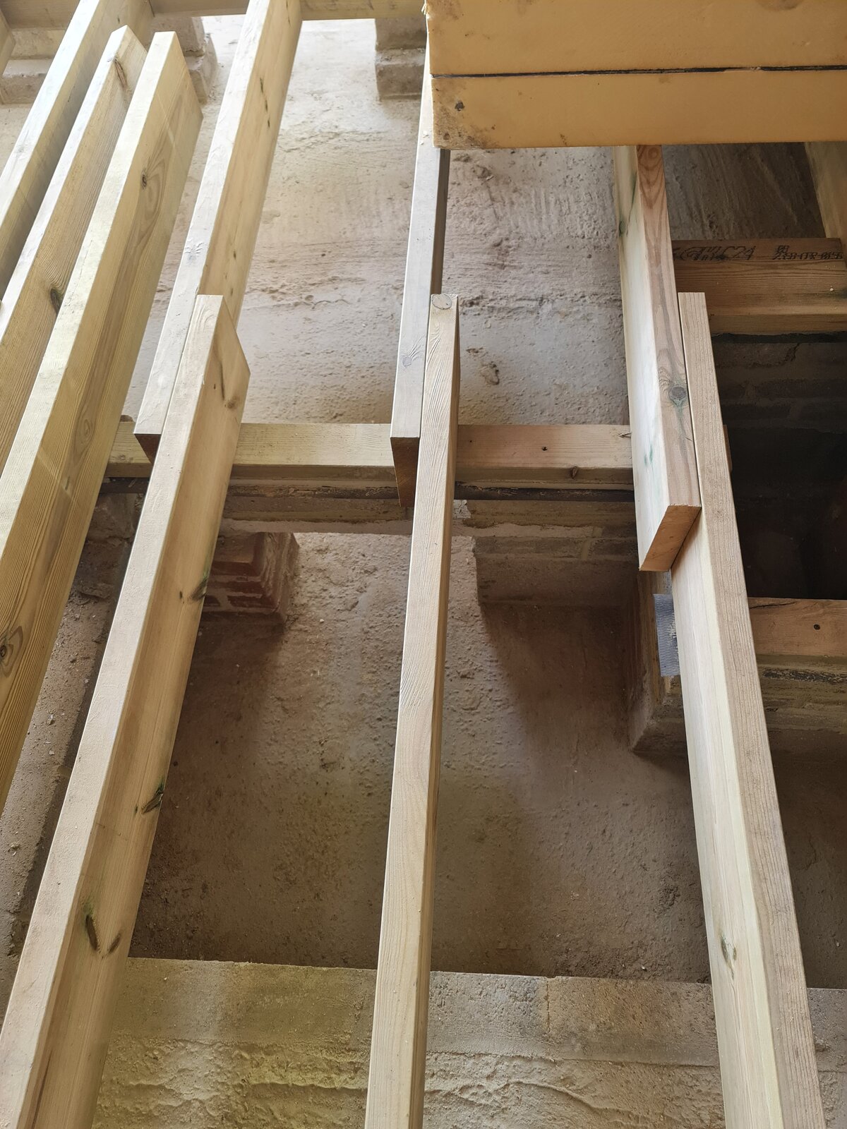

I have finished the front half and now on the back which is going far quicker as I have learn the process. Where the joists meet in the centre can they be screwed as well as installing a solid timber brace between them?
Yes, definitely screw together. lseo fix tpo the bearer beneath them (two skewed screws)
I had planned on putting a noggin/solid brace at this point but thinking about it today where the joists meet is the transition from the original house to the extention. I had wanted this left open to allow some nice airflow between the 2 areas. Is it OK to set the brace off to one side or the other or to use a smaller timber (4x2) to brace?
The large air gap shown in the previous photos is to either side of the main area. This will feed a lot of air in but in the main area the air gaps are provided by gaps between the blocks under the supporting plate and between the joists (as below). Will this give enough airflow if i fully brace between the joists at te wal plate.
