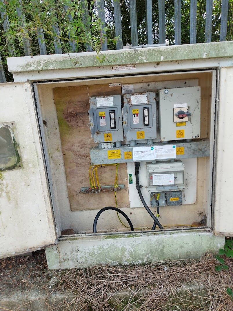

Todays little RCD tripping problem, hardly DIY. This is the generator inlet and manual changeover pillar, the RCD is in the main supply (supplying armour into trunking) in an adjacent pillar.
The fault was elsewhere and eventually found to be earth bar metal theft. While waiting for a another man with keys I checked pillar, the adaptable box was lidded (like its neighbour and totally full of spider nest which extended to completely cover the armour. I found 49V DC between the armour and earthbar (from the equipments DC power supply).
I thought you'd like to see what some professional electricians think is OK.

The phase & neutral/earth from that split-con appear to go up into the enclosure above through different holes in the metal adaptable box. That's not the best of practices either!
It's SWA, brown and grey through one hole.
To confirm; it's brown & grey as L&N through one 20mm hole and black as earth with a bond earth through the other 20mm.
