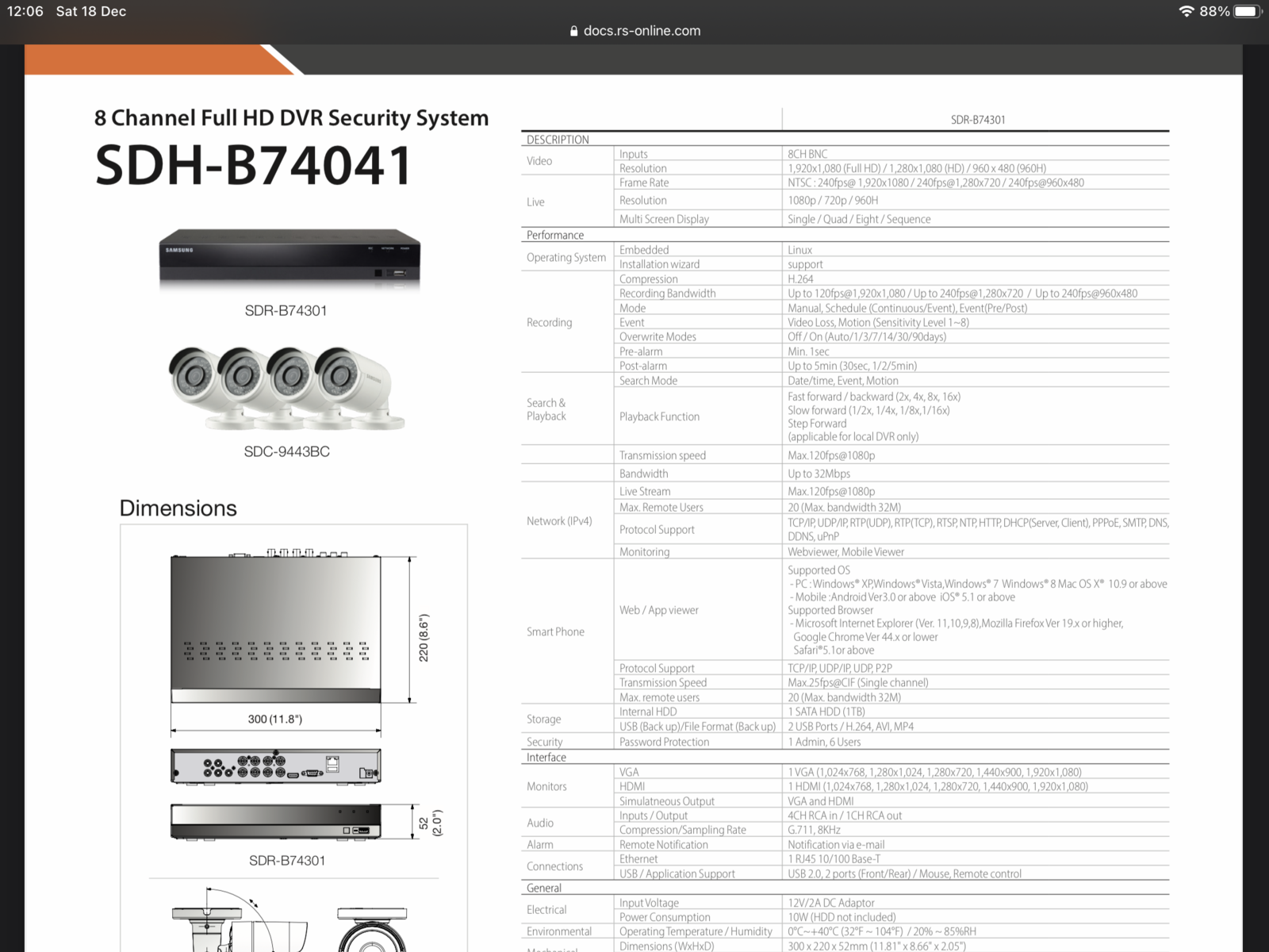

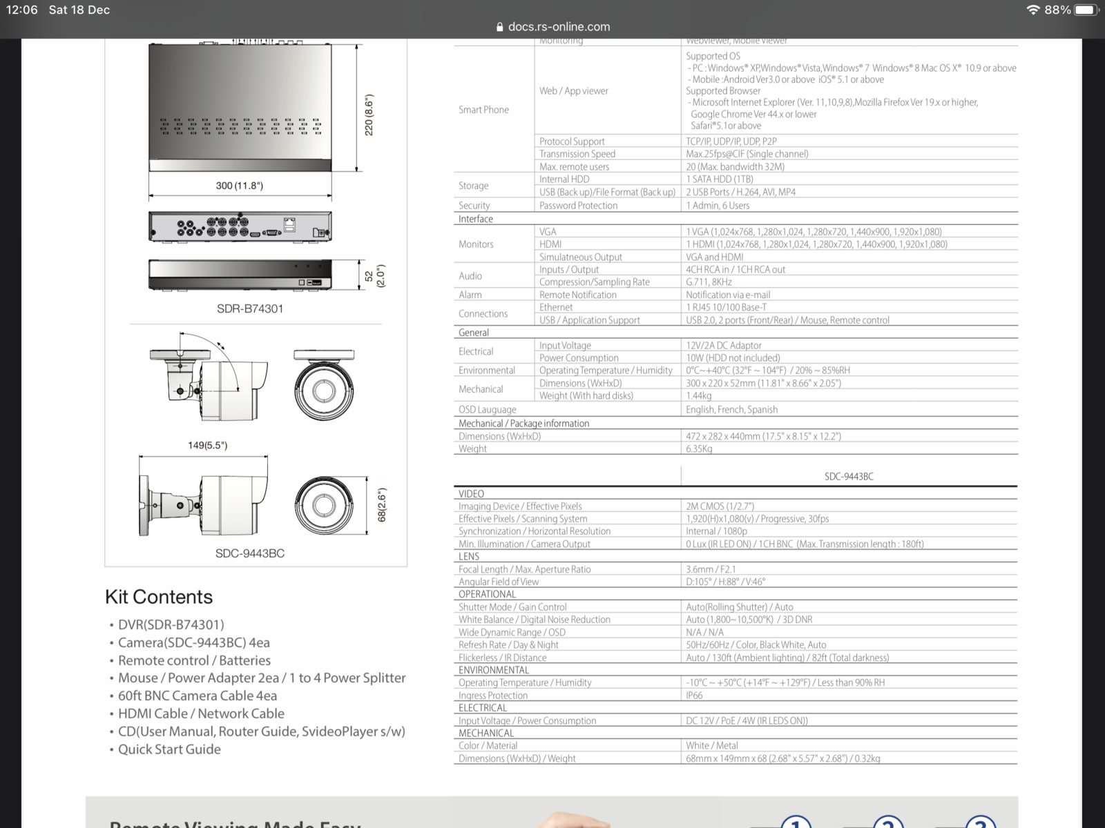

The cable that came with the Samsung SDH B 74081 was BNC cable 60 foot reels. Cameras were SDC 9443 BC.

I have searched out a SAMSUNG HRX 820 DVR unit that looks like it will accept my BNC cables and cameras.
A lot more features than my old one
