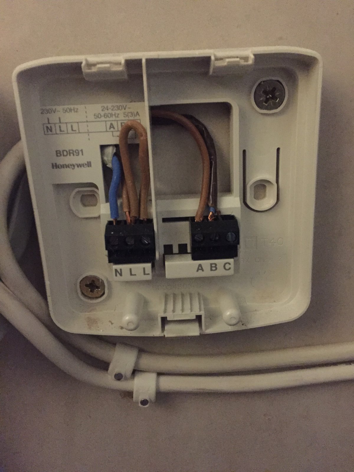

hi all Iv been looking through the forum and found some helpful posts but just want to check my wiring - I can’t find any that has the same as mine - the existing L to L loop. Do I need to recreate that in the Nest too and if so where does that go?

The BDR91 (L) terminals are both the same in that they are connected together electrically inside the BDR91, the second is just provided for convenience. That link someone has inserted between them is completely pointless as they are already interconnected.
BDR91 (L) = Hive (L)
BDR91 (N) = Hive (N)
BDR91 (A) = Hive (1) Common
BDR91 (B) = Hive (3) Heating on
No additional link is required at the Hive. The way that it is wired could possibly indicate that your boiler requires 'voltage free' switching. If so adding a link may cause serious damage to your boiler.
Thanks Stem, not sure what you mean by single channel - i have the T3028GB and gas boiler is a Worcester Greenstar Si Compact. When you say adding a link could cause serious damage to my boiler, should i not install the nest or not have a link as in the BDR91?
Just connect the 4 wires as above?
My apologies I have given you instructions for wiring to Hive, when you actually said Nest. Ignore the above and use below for Nest. No wonder you were confused Hive comes in two versions, Nest doesn't.
BDR91 (L) = Nest (L)
BDR91 (N) = Nest (N)
BDR91 (A) = Nest (2) Heating Common
BDR91 (B) = Nest (3) Heating on
Here also no extra links required.
As you don't mention any hot water control, I assume your version of the boiler is a combi, and that you don't have hot water that needs connecting to the Nest too.
Stem no worries appreciate the reply - you are correct its a combi. I assume then the link is pointless - strange that they did that?!
Yes completely pointless they are already joined together.
Whoever originally installed it probably just saw two terminals marked L and thought both needed connecting to the incoming live supply. Not the first time I've seen it either.

Stem jus let you know i got Nest fitted and all going well so far - was pretty simple to be fair
