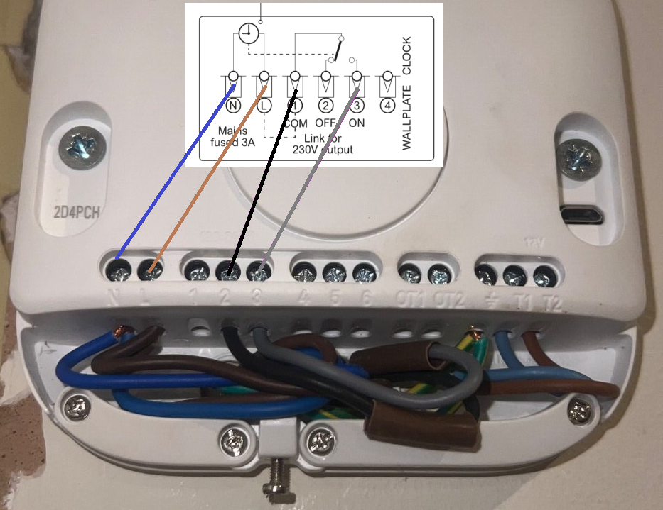

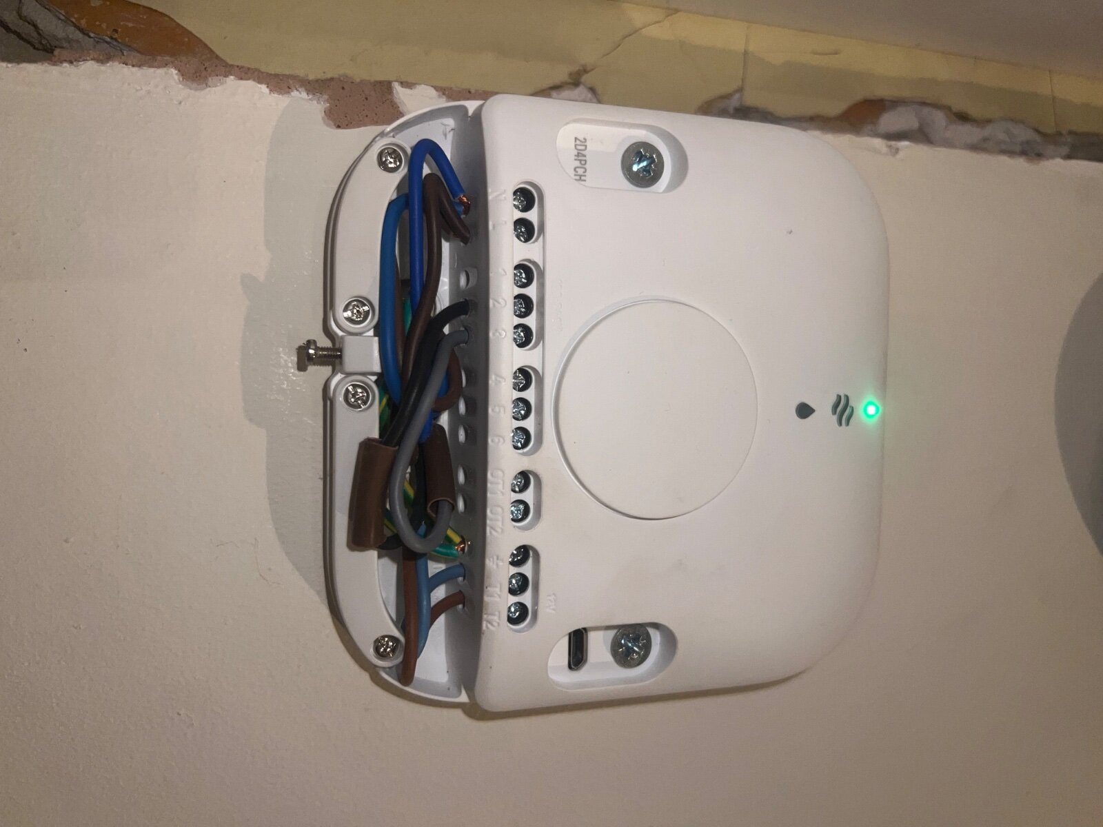

Hi all
Apologies if this has been covered before I have read the previous similar threads but none of them have the exact same wiring as my current set up. I am changing my nest thermostat + heat link for a Drayton wiser kit due to the thermostat itself being in an awkward location and wanting a battery powered option. My plan is below
Wire the two live wires from heat link into live on Drayton
Wire the two neutral wires from heat link into neutral on Drayton
Wire the one common (2) wire from heat link into common (1) on Drayton
Wire the one call for heat (3) wire into on (3) on Drayton.
There is just one zone for the heating and it is a combi boiler powered by a 3A spur

I just wired in parallel and have both Thermostats_tonemapped.jpg the Nest can be powered by USB, so can use a battery pack if you want. 1766896712331.png I like the way the Nest lights up, as I pass, and tells me the temperature, and does not need batteries to work, but also like the way Wiser allows multi-thermostats to be used, at the moment only two. As fitted now, even if batteries do go flat, I have a backup.
