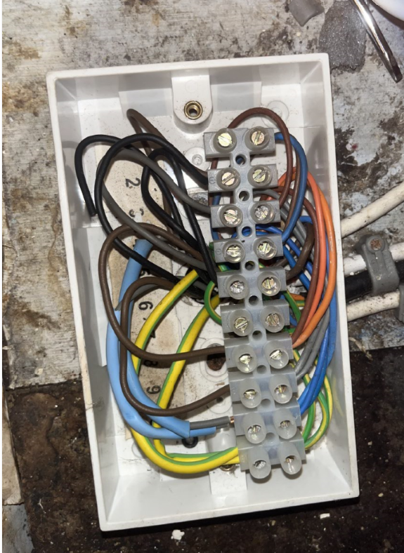

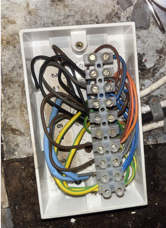

I am looking at purchasing the Drayton Wiser 2 channel System to give me more control over the central heating. I wish to remove the Thermostat in the Lounge and consequently need to know how to wire the Wiring centre without it.
So to do this do I remove the thermostat in the lounge, then disconnect the wiring from the thermostat in the wiring centre (connecting points 2, 5 and 9) and then make a link connection in the wiring centre from wiring centre terminal 3 (switched thermostat) to wiring centre terminal 5 (ZA5 multi port valve brown wire)?

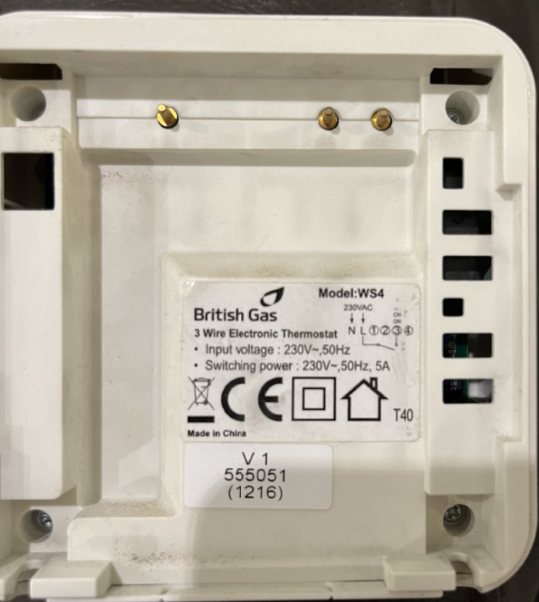

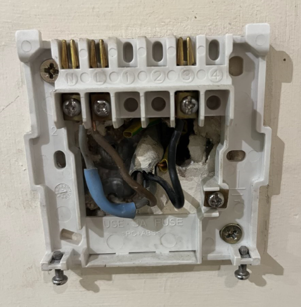

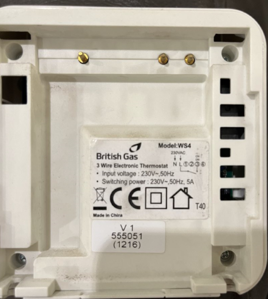

Thermostat – British Gas Ws4 Wiring
Neutral Terminal = Grey wire with Blue Sheath.
Live Terminal – Brown wire.
Switched Terminal 3 = Black wire.
Multi Port Valve – Drayton ZA5 to wiring centre connectors
Connecting block position 5 = Brown wire
Connecting block position 7 – Orange wire
Connecting block position 8 – Grey wire
Connecting block position 9 - Blue wire
Pictures of system
Picture 1 SHows the wiring at the Thermostat
Picture 2 shows the wiring backplane in the Thermostat
Picture 3 shows the Wiring Centre with the Thermostat & Programmer wiring on the left and all the valve control wiring on the right.

Trace the live and switched live from thermostat so brown and black and join these in the wiring center.
Heating systems are designed in a few different ways, boilers can be turned on/off or up/down, and the home can be split into zones using large motorised valves each controlling a number of rooms or small motorised valves know as TRV's with electronic heads. The Wiser is a flexible system allowing it to be used in many different ways, so there is no single answer.
To convert an existing home often we are limited due to where wires run, we tend to have two areas where control can be wired, around where the boiler is, and around where the hot water tank is, so often we have to abandon the idea of having analogue control (which is better) and have to use simple on/off control.
The colour of the wires in the wiring centre makes me think that is near the motorised valves, there are a number of ways the valves can be used, and we tend to label them by the old Honeywell systems as C, S, W, and Y plans, seems likely you have S plan. We can use 24 volt, 230 volt or variable voltage control, it seems yours is 230 volt, likely the best place for the Wiser base is next to the wiring centre, and since motorised valves come with the cable the colours of the wires of the motorised valves are the best way to work out what you have.
But in the main central heating is a compromise, and you have to decide where to compromise. There is no right and wrong way, it is the way which suits you.
I think the plans are shown in Wiki, job one work out how already wired.
