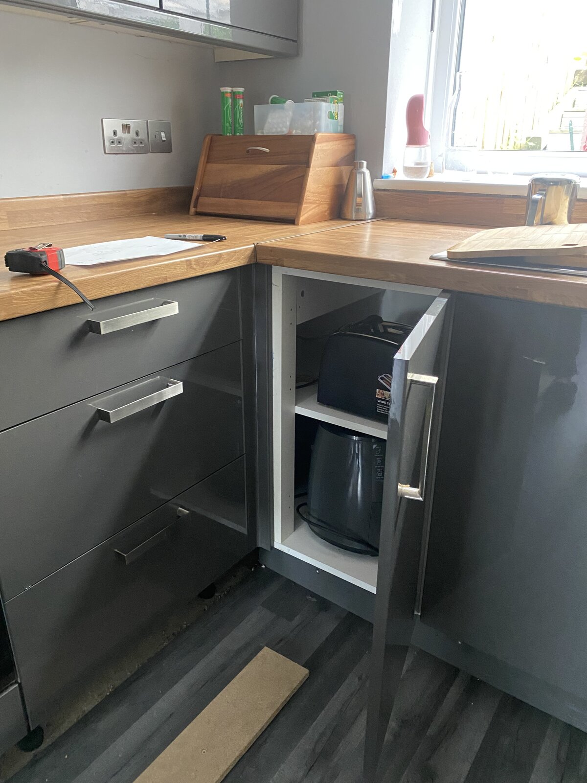

The photo shows the base unit with a 400 door opening on the right side.
I am remodelling and this base will go back in where the draw pack is.
So can I just cut the post and move it forwards to create a 400 opening where the draw pack is now?
How wide is the unit, is it 800mm or a 1000mm?
If its the former the post can stay, if it's the latter then....the post has either two screws top and bottom holding it in, drilled through the top and bottom of the carcass or.1 screw and one dowel, if you can get the unit out you can remove it in one piece, if not then you will need a multi tool with a metal cutting blade, and you will scorch the cabinet.
