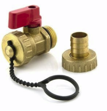

A decent drain cock low down somewhere saves grief too. A Washing machine hose will fit 3/4 bsp, and they won't leak like the 37p ones (I'm old). This type.. You can take the handle off. One on each side if you can, great for future mains flushes.
