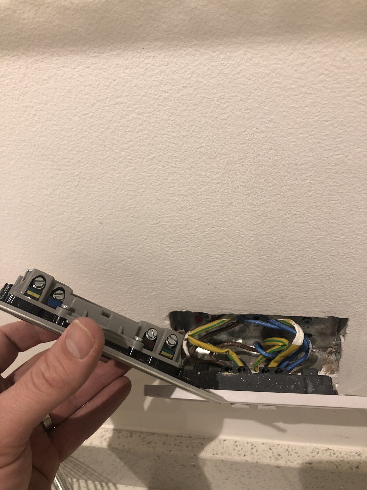

Hi all,
I am just trying to fit a nexus screwless flat plate socket and it’s driving me absolutely mad.
according to descriptions they require a 25mm back box. I managed to fit them ok on a tiled splashback but I’ve gained a good 8mm with tiles and grout.
So am I wasting my time completely trying to get these things in a 25mm back box ?
I don’t really fancy trying to swap them all to 35mm boxes
Any advice much appreciated

With that amount of cables , I doubt you will be able to fit to a 25 mm box.
I did something very, very similar yesterday.
3 cables, 25mm box and with no lee-way, screwless flatplate socket.
Doubted it would fit, but with careful arranging of each wire, avoiding wires crossing over behind the bulkiest part of the socket, I got there.
Check the terminals are tight just before screwing back the faceplate.
Too much buggering about can loosen the terminals.
A 10mm spacer is available to go between the wall and the socket.
Looks a bit naff, but may get you out of trouble.
