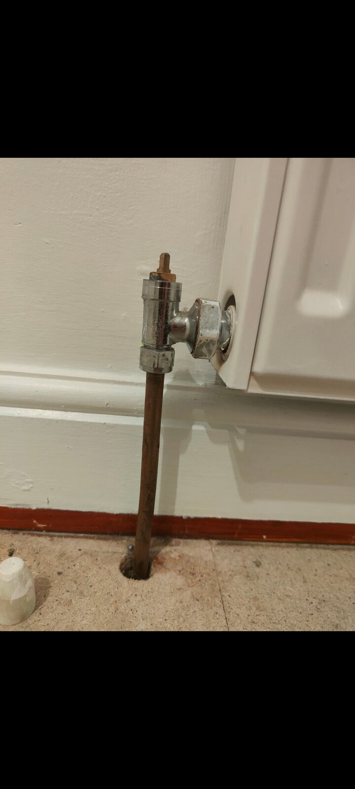

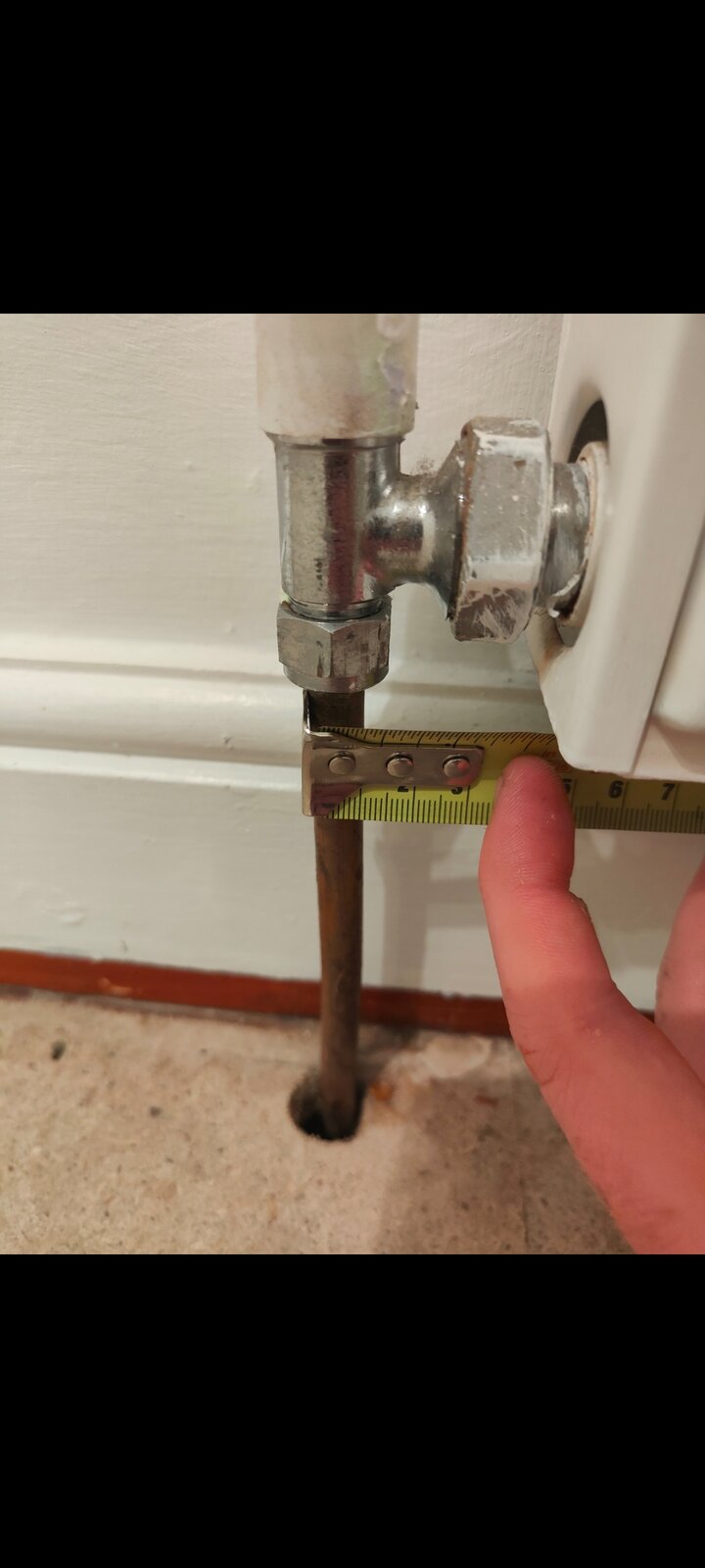

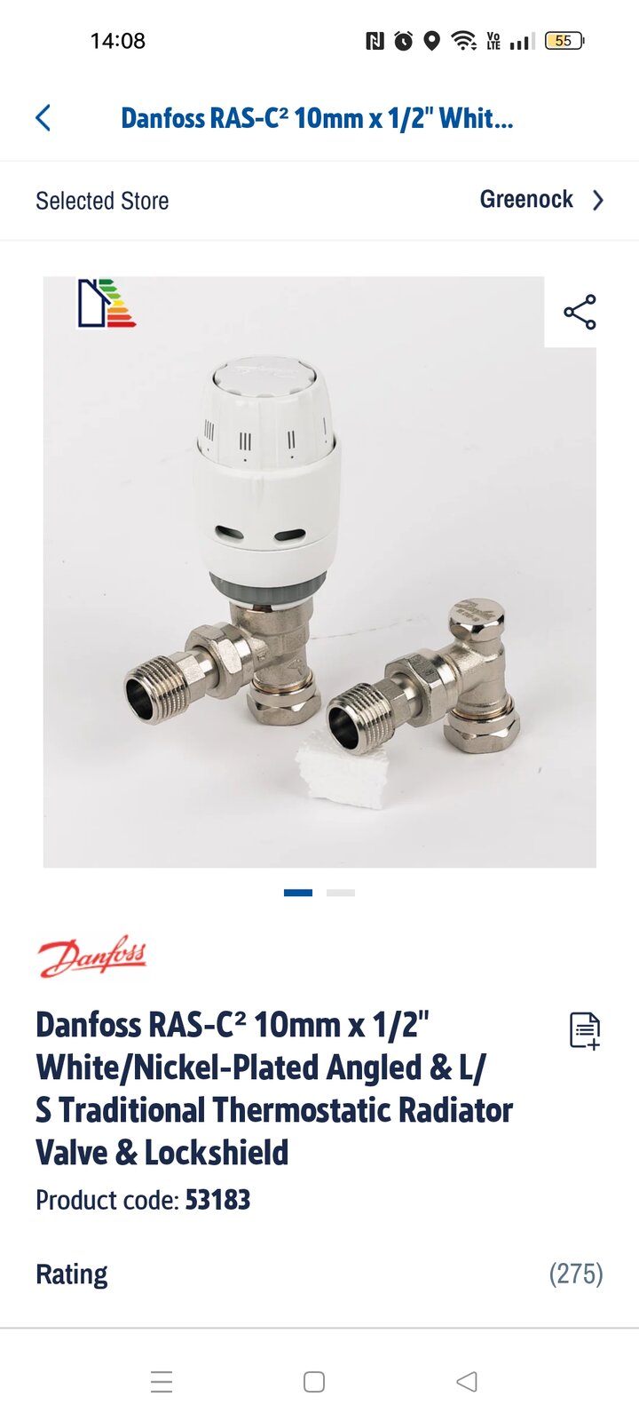

Pls see pics...
Got 10mm copper flow and return pipes, have standard lockshield valves and want to replace to TRVs. Will the one in pic (Screwfix) work? I see it's 15mm but think it comes with a 10mm reducer for the copper pipe...

Pressurised system on a combi. The boiler circulates the water to keep itself cool through the radiators. So no, you can't use the boiler if you drain the system down.
